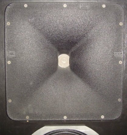

augerpro said:Noah Katz made a mold of the interior of the XT1086. Maybe Earl could comment on the shape.
Quite right - this is not a waveguide. My mistake, I couldn't see this diffraction slot from the photos.

Robh3606 said:You mean something like in this waveguide?? Looks like a rounded over difration slot??
XT1086 transitions smoothly from round to vertical elliptical at the throat, and then to horizontal elliptical in the flare....
