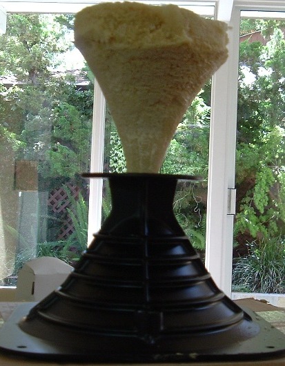

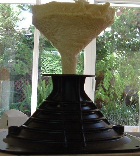

I have measured many different compression drivers on the DDS waveguide.
On-axis, the DDS produces a broad dip from 6.5 kHz to 13 kHz. I'm looking at an un-equalized family of curves with 1/6 octave smoothing as I type this. This dip is present in every set of measurements I've made on this waveguide.
If this dip is depicted in the published polars, I sure as heck can't make it out.

Frankly, I'm not here to debate the Gedlee waveguide, rather for the EconoWave measurement results, and as I view them, it's apparent that anyone can easily flatten the response of the JBL "horn" on axis using CD compensation and meet all of the criteria Gedlee specifies for good performance, better than the ESP waveguide, in fact, in both conventional and "unorthodox" alignments, the one exception being vertical dispersion, where the fact that it is a 50° vertical device, consistent with the Harman algorithm, has seemingly been ignored....

At the moment I don't have sufficiently good measurements to make them worth posting. The response is not too hard to equalise up to 10kHz, from 0 to about 45 degrees on the wide axis (as it happens I do use them toed-in considerably). Perhaps I'll have a go at better measurements, but it may take some time.
I've tried looking for HOMs but, although I thought I knew approximately what to expect from some crude FE modelling, I have not seen anything measurable (and am not sure what they sound like). But then I've not tried hard enough - no time.
