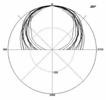

Magnetar said:
What's wrong with the manufactures plot? It doesn't have the Gedlee dip! Neither does my round tractrix horns - these probably sound excellent with a good driver like the Beyma Duke uses.
DAH! Thats because they are all normalized to be 0 dB on axis! (Why do I even respond to these comments 🙄
gedlee said:
DAH! Thats because they are all normalized to be 0 dB on axis! (Why do I even respond to these comments)
No they aren't LOL
Magnetar said:
No they aren't LOL
Your saying that this horn is perfectly flat with no, I repeat, no, not even +- 1 dB response on axis.
No not at all - I said they aren't normalized to the zero axis as you stated
Maybe we have our jingo skewed?
If you were 'normalize" your horn to the zero axis you state it won't work - I agree - but the DDS of course will work normalized to your axis because they are more constant directivity then yours
