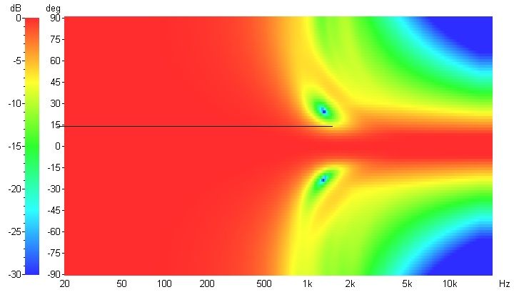

Wayne Parham said:
clean verticals.
Well, I think "clean" is a matter of degree. None of them are what I'd really call clean so that becomes just one of many design factors.
Vertical polar map, 12" woofer, 90x60 horn, LR4-1300 XO.

Great models, catapult, thanks.
These show pretty clearly what you can expect if someone takes the time to properly design a crossover to set the nulls fairly symmetrical to the baffle normal, i.e. put the forward lobe straight out front. I will leave it to the reader to look up the measurements of popular designs to see if they meet this goal. But for the moment, we'll assume that the designer takes care to position the forward lobe reasonably well out front.
Let's look carefully at catapult's simulations.
First, the speaker with an axisymmetrical horn.
Vertical map of two-way loudspeaker having 12" woofer and 90 degree round horn, xover at 1.3kHz fourth-order
Notice the pattern collapses rapidly between 750Hz and 1kHz to approximately 30 degrees. It then opens back up above 2kHz to 90 degrees. In between, in the crossover region from 1kHz to 2kHz, you'll notice the nulls. The crossover region has basically a 30 degree vertical pattern but above and below the crossover region, the pattern is much wider, basically 180 degrees (or greater) below crossover and 90 degrees above crossover. So the vertical pattern is 180+ degrees, then 30 degrees, then 90 degrees.

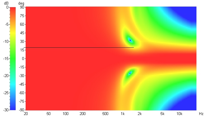

Now let's look at the speaker with an asymmetrical horn.
Vertical map of two-way loudspeaker having 12" woofer and 90 x 60 degree horn, xover at 1.3kHz fourth-order
Just like the example above, the pattern collapses rapidly between 750Hz and 1kHz. You'll also notice that the nulls are positioned at the same place as the earlier simulation - 30 degrees - which indicates that catapult's model did not take advantage of the smaller mouth height and move the tweeter closer to the woofer. He did not decrease CTC spacing in his simulation, which would have increased the size of the forward lobe and set the nulls out further apart. We know the null angle can be increased (fairly significantly) to nearly double this by decreasing CTC spacing because I've shown measurements that prove that fact. Still, the existing model illustrates the issues very clearly. The pattern narrows from 180+ degrees at LF to 30 degrees at crossover to 60 degrees at HF.
If the CTC spacing were made smaller, then the nulls would be spread out to the edge of the pattern, placing them at 60 degrees, just like the vertical pattern at VHF. What you have then is 180+ degrees below crossover, collapsing to 60 degrees in the crossover region and maintained through the tweeter's passband.
This is the goal.
That was on purpose. Both horns had the same vertical dimension to get the cutoff low enough for the 1300 XO. Making the 90x60 smaller would have meant moving the XO higher and defeated the purpose. Here's the same 90x60 with a 15" woofer so the C-C spacing is bigger. It does make the lobe a tiny bit smaller but, like I said in the original post, these things are a continuum. Basically the vertical polar response of all of them sucks and, to me, that's a small fish in a big design pond. It's something to pay attention to but not something to obsess about. As long as the sound doesn't change when you stand up, that's good enough for me.
Edit: all the sims are using the 10" vertical dimension of the QSC 90x60. You could cut into the mounting flange and maybe overlap the woofer and horn by an inch but the sims show there's not really enough difference in the polars to make it worth the trouble.
I guess I might as well post all of them. Here's a 10" woofer with the same QSC 90x60 and the same XO. Yes the lobe gets bigger but it's (IMO) a small difference.
There are a few design tradeoffs going on and the designer needs to decide what's important.
1. The 15" has a smaller usable lobe than the 10" because of C-C spacing.
2. The 15" will have more sensitivity and more LF capability than the 10".
3. The QSC has a generous roundover at the mouth. That increases C-C spacing but it should also help reduce horn honk.
The way I see it, no matter how you juggle the C-C thing, you'd like both the seated and standing ear level to be within +/- 10 degrees of the center of the lobe for the best sound. So steering the lobe is the most important thing and that is done with the crossover. The crossover is a big deal, C-C spacing less so.
I agree with you about steering the lobe. Some guys seem to not pay attention to that and produce speakers with a null way too close to the baffle normal. Makes them hard to place without putting people in a null. Most people won't even consider that, and instead assume the baffle normal is the certer of the forward lobe. They can easily make the accident of placing the speakers where people are sitting in a null. Using careful crossover design, this can be avoided. To me, that's a requirement of good loudspeaker design.
