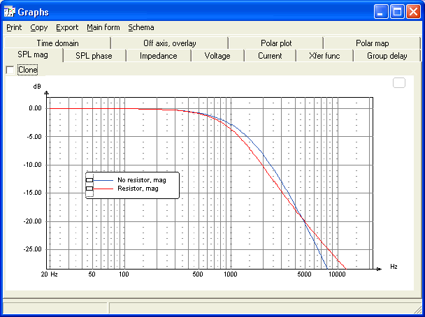

More likely, that's a 2nd order electrical lowpass (who knows what the acoustical response is) with the resistor doing some response shaping. Here's a theoretical 2nd order lowpass with a 1.5mH inductor and a 6uF cap. The red line adds 10 ohms in series with the cap.
AKA "quasi-" 2nd order....
ZilchLab said:AKA "quasi-" 2nd order....![]()
A quasi 2nd order is where the poles are spread far apart in frequency so it starts off as 1st order and later turns 2nd order. I doubt that's what's going on here. Earl is going for an unknown acoustical response (maybe 3rd order, maybe 4th order) and the resistor is just a tool to help get it done. Bottom line, it's a 2nd order electrical filter giving some acoustical response that's steeper than that.
It's my understanding that the resistor is to reduce the peak in the woofer's response around that region. It's how I use it in my own crossovers and I believe Dr. Geddes said the same. Having built his speakers, I have the values of these LCR's in the tweeter, but would rather let him post them if he wants to. However, I do know that due to my and I believe Marcus building these very publicly, the values are posted in a round about way. I think I may have inadvertently posted a form of the crossover schematic too. It's also available on his website I believe.
When I talked with Dr. Geddes on the function of each LCR (I had assumed that two if not all three were serving to reduce the impedance peaks in horns), I was told that one serves to flatten the impedance, and two serve more as EQ's. One as an EQ in the 2-4k range and one to shape the crossover response. The crossover is acoustically like a 3rd order filter I believe, but electrically it's really a 1st order. If you look at the phase response, it looks like what it basically is, a 1st order filter. There is no parallel inductor without the addtion of a capacitor and resistor, and as a result, there is a very small phase change. The acoustic phase response of his speaker is excellent, really excellent. I think it's at the expense of frequency response some, which is usually the tradeoff I face when I try and balance the two.
