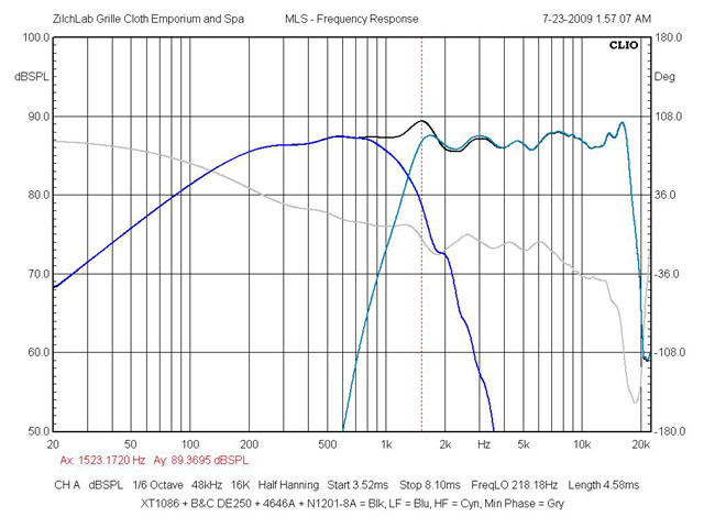

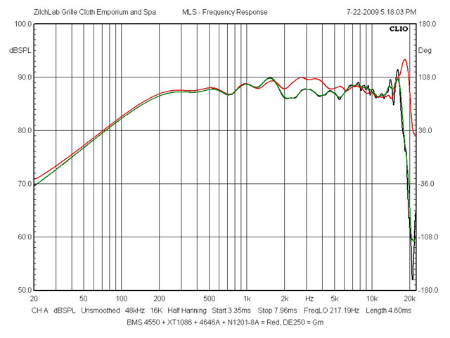

How does it sound? 😀
Am I awash in HOM? Not that I hear, particularly; I took 511A's down to set this up, so I know "horny" when I hear it.
It certainly has the "punch" everybody's been crying for.
Needs a sub, of course.
I'll put DE250 on next for the forum's edification, rather than tweak the filters just now.
[Those who have pushed the Iggy button are missing out on the fun.... 😉 ]
Let's call it +/- 2 dB for now, m'kay?
Earl uses three notch filters to smooth out DE250 in Abbey; there's none here yet.... 😴

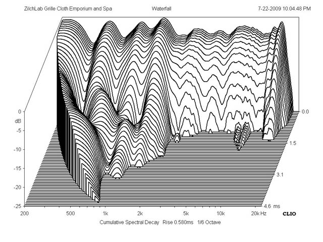

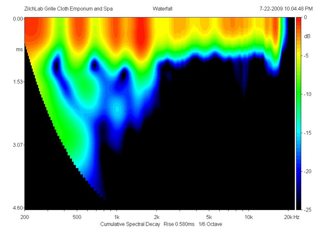

I'd expect that waveguide just sittin' there hanging out in the open by an inch or so to be ringing all over the place, but it's pretty clean above 2 kHz:

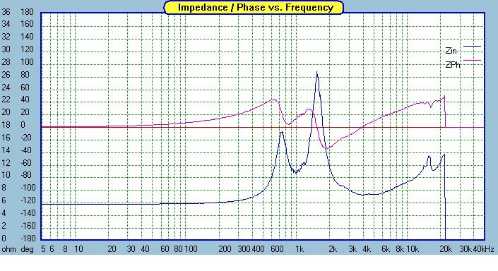

I'm going to chase that resonance at 1.5 kHz; I have verified that it is coming from the DE250/waveguide. Below's where I am now, and I'll begin by measuring the impedance and trying to notch it out.

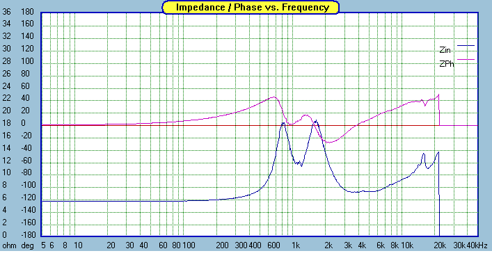

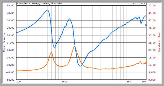

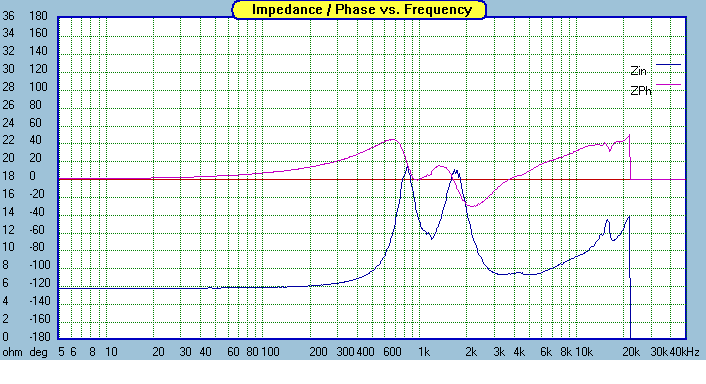

I confirm Augerpro's impedance measurements for DE250 on XT1086. As we see, however, a peak in the region of 1.6 kHz is common with virtually any waveguide, as is also the case with the exponential horn in the DE250 data sheet.
