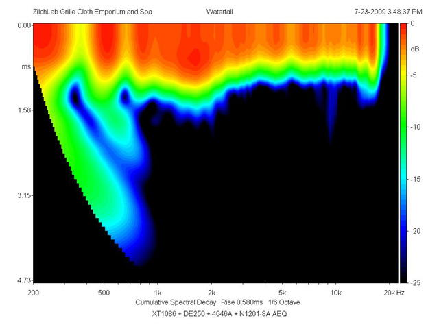

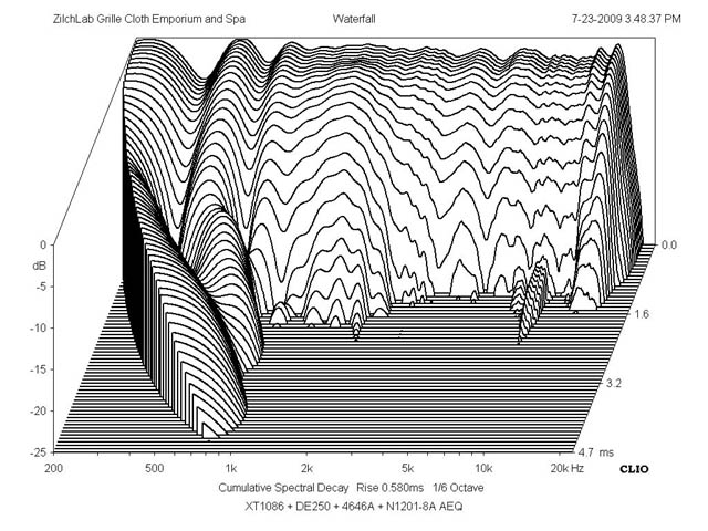

ZilchLab said:So much for the 1.6 kHz issue:
Strange. In the color 2D waterfall there seems to be a real hotspot at ~1.6K. In the 3D graph it looks lower in freq. and amplitude. Am I reading that right?

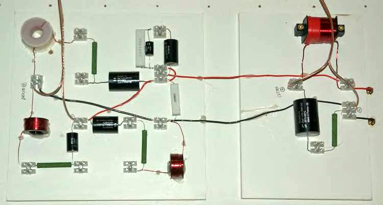

I think the values of R1/R2 in the network I designed can probably be set to provide the correct amount of damping to remove that peak. That's one of the things that network is designed to do, and why I came up with that circuit topology.
Since R1/R2 sets the damping of the core splitter filter, you can set whatever amount of peaking you want. It can be set for slightly ovberdamped or slightly underdamped, whatever is needed. That was always the whole intent of the R1/R2 network - to provide these three things: 1. SPL matching between woofer and tweeter, 2. Top octave conjugate compensation for mass rolloff and 3. Specific damping for the core splitter to set the response in the region below mass rolloff, basically the octave between crossover and mass rolloff. Usually, the circuit is slightly underdamped, but if there is a pipe mode and/or diaphragm resonance in this region then it may need to be set for other damping values. I think that's what you're seeing here, and overdamping is probably the best bet.
On the other hand, Zilch has a really nice response curve so I'm thinking whatever he did, it works well. Seems like I saw he wrote it was a notch filter. Looks like he dialed in just right, with the right L, C and R. I'm sure you could set the values of R1 and R2 to do the same thing, simultaneously setting the three conditions it's designed to set. But if the high-pass filter isn't set for around 1.6kHz, it won't do it.

following a recommendation from Dr Earl Geddes Iv'e been using a resistor in parallel with the compression driver to even out some of the impedance issues, usually I chose a value that is the same as the impedance of the compression driver then I drop that into a lpad calculator to get R2. This knocks a few db off the sensitivity of the driver that makes it a lot easier to match levels using a active crossover and a DSP for EQ'ing. It also takes out a lot of hiss at low volume levels.

col said:following a recommendation from Dr Earl Geddes Iv'e been using a resistor in parallel with the compression driver to even out some of the impedance issues, usually I chose a value that is the same as the impedance of the compression driver then I drop that into a lpad calculator to get R2.
That's the idea, yes. The shunt resistance provides damping and, in combination with series resistance, provides SPL level matching as well.
Yes, but if you look closely in the 3D version, there's a "bump" on the top of the plateau which shows as a hotspot in the spectrogram. Clearly, the issue is not entirely resolved as, while the resonance is well suppressed now, the region is still "fat." My intent was to discover if EQ alone had promise to mitigate it. Answer: "Yes," but there's more to do.
Wayne Parham said:I think the values of R1/R2 in the network I designed can probably be set to provide the correct amount of damping to remove that peak. That's one of the things that network is designed to do, and why I came up with that circuit topology.
It looks to me like with a little effort, this combination could be really good. Nice flat response and large forward lobe with widely spaced nulls. I'm still thinking they can probably even be coaxed just outside the 60 degree vertical pattern, but even if not, being just under at 50 degrees is very good. That's the kind of separation between nulls I like to see.
I'll migrate to your filter, most likely. What I have presently is a proof of principle kludge. The ancient relic Altec Model 19 crossovers are merely what I use for initial testing of various combinations, because they have the facility to dial in varying levels of HF comp. My own version of that has even greater versatility, but it is otherwise occupied presently.
We got our first look at the Geddes crossover in member DougSmith's Abbeys recently, below. It incorporates three notch filters to smooth the DE250 response. To achieve the result I show, I did the same using DEQ2496, much as Col has just suggested. None of them is more than 2.5 dB deep, as I recall, and could be implemented passively using series LRC notches in a final design, if required....

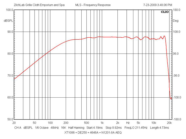

Some pages back, in discussing his "critique" of the EconoWaveguide, Earl conceded that neither it's response nor constant directivity capabilities were a problem, rather, merely that the ripples in its response were indicative of the presence of HOMs. Augerpro's recent measurement of the Geddes waveguide shows ripples as well, and, indeed, looking back at Earl's original published data, subject of this thread, his unequalized ESP12, even 1/3 octave smoothed, prominently exhibits them, below.
In the final comparison of ESP12 and EconoWave, however, it's apparent that his DE250 had been tamed with EQ, much as I have done with it on XT1086 here....
ZilchLab, be careful with the DEQ2496 it can be quite deceptive. Don't use the analogue in/out. I'm using a poppulse USB with the XLR output into the DEQ2496 and then the digital/optical out to a outboard DAC. Behringer really skimped on the opamps in the analogue in/out.

Yes, it's merely a development tool here, telling me what I need to do. I'd attend to those larger issues if I were to actually use it in a system design....
