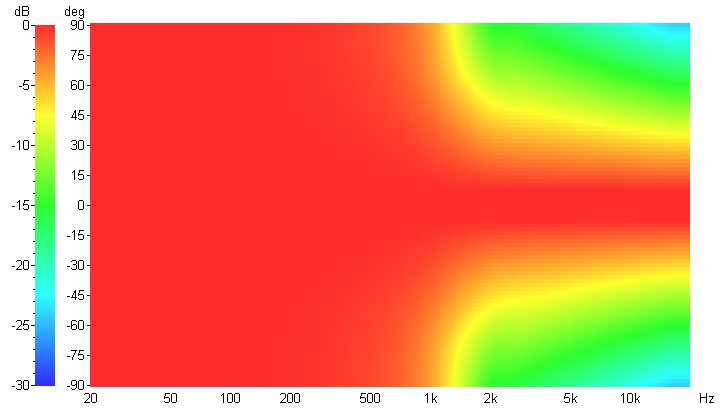

catapult said:Bottom line, it's the same old deal. You can nibble at the edges of pushing the nulls farther apart with the C-C spacing and the XO frequency but the real sweet spot is about +/- 10 degrees no matter what you do.
Thank you very much again for running the sims. I believe they effectively put the "asymmetrics lose pattern control below 2 kHz in the vertical" criticism to rest; the nulls assume control in the crossover region and augment the pattern, much as Wayne has taught -- these do not suck.
We determined in the earlier null sim study that EconoWave and a 10" woofer was a particularly workable combination; these results confirm that finding. A "squircle" 10" would snug it up even more.
The only criticism I have thus far is that your 90° round waveguide is only 8" diameter, and may therefore be unrealistic. A Geddes 12" waveguide, for example, would have a 12" C/C distance, not 10", and with a 15" woofer, 13.5".
Also, as is evident, moving the crossover frequency higher (to 1.6 kHz) with a shorter 6.5" horn is not so detrimental as you earlier supposed.
Now, if I may impose upon you just a bit further, we do know the specifics of the EconoWave crossover, and it would be interesting to see its impact upon your findings. It was modeled by member Infinia in another thread here:

ZilchLab said:The only criticism I have thus far is that your 90° round waveguide is only 8" diameter
Huh, where did you get that? The sim is for a 10" waveguide and C-C spacing is set accordingly.
Nah, sorry, I'm done. I really have very little interest in the econowave horn and I don't see myself ever using one. You can download LspCAD and do all the sims you want for yourself. 🙂

LR4 is the acoustic slope, no? If so, a more comprehensive model must be constructed from the unfiltered measurements and the filter schematic, and I'll have to generate the raw data....

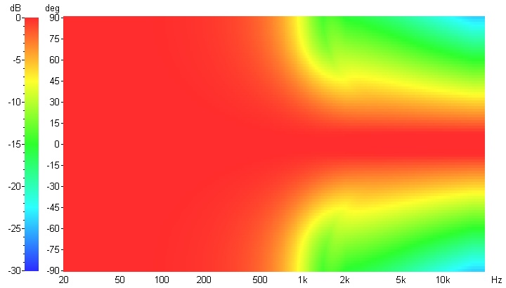

Well, I said I was done but I already had these on the hard drive. Executive version, you can make almost anything work.
Horizontal response, QSC horn, 15" woofer, LR4-1300.
Wayne Parham said:I would not suggest using a woofer smaller than 12" because the horn's horizontal directivity won't match a smaller woofer unless the crossover frequency is high.
I would expect a 15" woofer to narrow to 90 degrees beamwidth around 1kHz, 12" woofer to narrow to 90 degrees around 1.3kHz, a 10" woofer around 1.6kHz and an 8" woofer around 2kHz. So while I think the 12" woofer is ideal for 1.3kHz crossover, I think a 10" woofer would probably work pretty well in this case too. I find about 30% wiggle room is acceptable since the two directivities blend in the horizontal plane. The sim does a pretty good job of showing that.

It's a sim done in LspCAD using 'perfect' drivers and a 'perfect' crossover transfer function. The horn's directivity is simulated with a text file and the woofer's directivity is simulated with piston diameter. You could use real measurements if you had them and a real crossover if you had the schematic. You can download the demo version and it will do everything except save files and model more than 2 drivers.
I guess you could make the dB range smaller but I've wasted too much time on this already. 🙂 It's just meant as a 'this is the general idea' visualization, nothing too precise. I started doing these to answer the question 'could the QSC horn work with a 15" woofer' and I concluded that it could without any huge penalties.

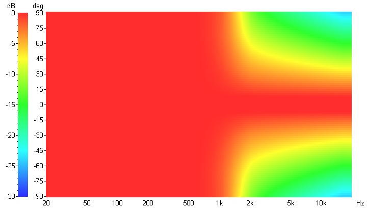

Hey Wayne,
I used actual piston diameter, not frame diameter, for the sims. C-C spacing was set by frame diameter. I forget what numbers I used but I adjusted it so the frequency of the first null at 40 degrees off-axis matched Brandon's measurements. They all came out somewhere close to 2" smaller than frame diameter so that's probably a decent rule of thumb.
Edit:
Edit:
My sims showed that directivity matching sets the upper limit of the crossover frequency, not the lower limit. There's no problem crossing lower as the combined pattern goes smoothly from 180 (or more) to 90 as the horn blends in. Crossing higher is a problem as the pattern narrows too much due to woofer directivity and then widens again as the horn comes in.Every 10" (and smaller) woofer I've measured had to be crossed over pretty high to get horizontal matching with a 90° horn.
Breaking out LspCAD one more time with an exaggerated example to show there's no polar penalty for using small woofers and/or low crossover frequencies. Horizontal response with the QSC horn and an LR4-1300 crossover. The first one has an 'optimum' 12" woofer and the second one has a 1" woofer (imagining such a thing could exist). There's not enough difference to worry about.
