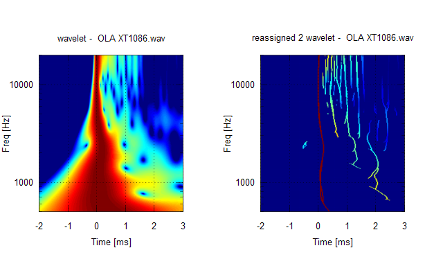

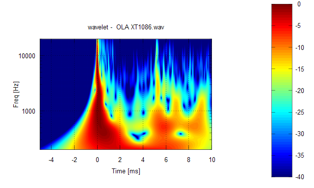

Here's some analysis of the 18sound XT1086 in ZilchLab's product.
Wavelet is calculated at 200Hz-20kHz showing the nice measurement environment with all those reflections 😀
The reassigned wavelet points the 1-2ms reflections/diffractions that seem to be so typical to the horns/waveguides in this thread 🙂 I'm yet to see a horn OR a waveguide + driver combination without this pre 2ms garbage!! DOES ONE EXIST?? 😕
From the reassignment one can have the most natural group delay by looking the dark red curve. This is the delay that the energy undergoes when travelling through the system.
- Elias

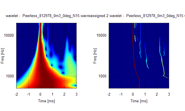

In order to get some reference, here's 20€ Peerless dome tweeter in a test baffle 😀 The tweeter is non-flush mounted so there is some front plate diffraction visible at 0.2ms above 10kHz. Also there is two baffle diffractions, 0.5ms and 1ms, one for short side and other for the long side of the test baffle. Reflections after 2ms is from the chair the test baffle was placed on. However, the driver is clean 😀

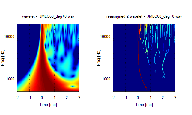

Comparison is made to jzagaja's JMLC horn

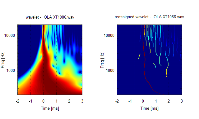

and ZilchLab OLA horn.
As can be seen the problems arrive from the acoustic surrounding elements of the driver. Cabinets, horns and waveguides belong to this troublesome acoustics surroundings 🙂

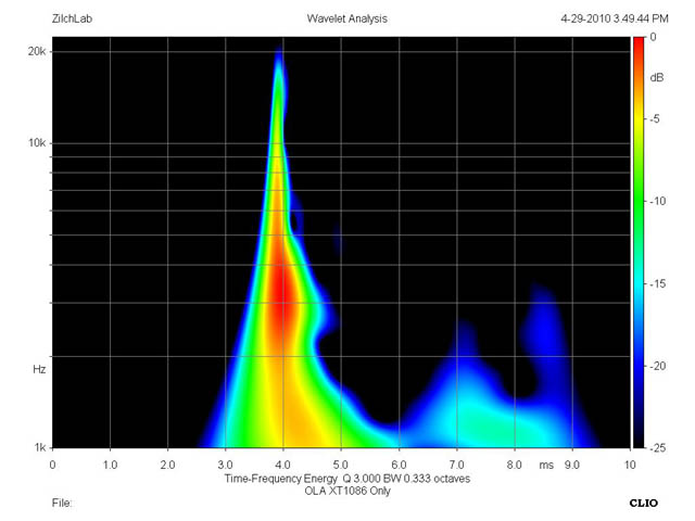

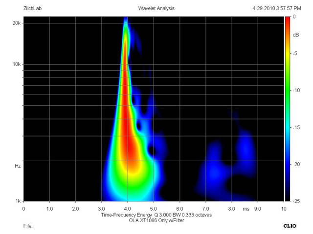

More OLA XT1086 data; still in the same cab, horn only and horn plus highpass filter:
Direct radiating drivers are always going to be cleaner than horns without foam inserts. This is can be concluded from basic understanding of physics. However, when one looks at data, and see something out of the regular, it takes more understanding to determine what is caused by what.😉
Jean-Michel,
No, the impulse response is on axis 0 deg. The horn name is "JMLC-60 (350Hz)".
See here post #554 where can be found impulse responses in 10 degree angles.
- Elias
http://www.diyaudio.com/forums/multi-way/161627-horn-honk-wanted.html#post2145714

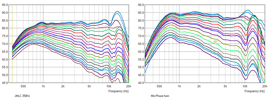

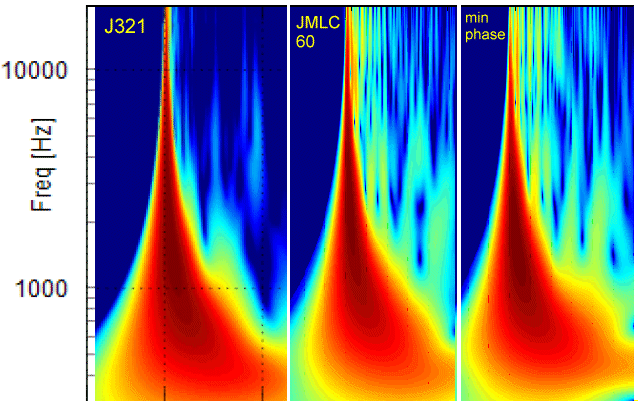

Hello Elias,
OK, I see now...
If we compare the wavelets graphs for the JMLC-60 (350Hz) and the Min-Phase horn (500Hz):
Jmmlc60 and minphase
http://www.diyaudio.com/forums/multi-way/161627-horn-honk-wanted-61.html#post2154302
we can see that the short delays reflexions, diffractions, homs for those 2 graphs are very similar despite their very different profiles. We can admit that there is a strong signature of the driver used by Jzagaja for both measurements, the 2" STX-D1300-Ti
On the frequency responses curves given by Jzagaja every 5 degrees,
http://www.diyaudio.com/forums/atta...rman-diy-show-gelsenkirchen-jmlc_minphase.gif
we can see that the 2" STX-D1300-Ti driver is a bit problematic over 8kHz.
Then when we compare (see attached file) the wavelets graphs for my J321 (320Hz) horn loading the TAD TD2001 1" compression driver with the JMLC60 and the Min-Phase:
We can see that the J321 loading the TD2001 has a cleaner wavelet graph (that Jerzual horn built my friend Marco Hernry was specially designed to be used with the TAD TD2001).
You should have used for your demonstartion a more illustrating comparison as on the graph:
http://www.diyaudio.com/forums/attachments/multi-way/165825d1270549429-horn-honk-wanted-3horns_.gif
