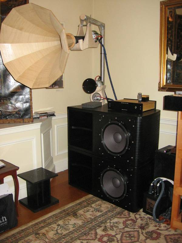

This past weekend I finally got to listen to a full GOTO system.
No foam, no mouth roll-over, no fancy profile but no honk. A very clean system.
However, I did not like the way it was voiced. Too bright, too thin for my taste. So an interesting combination of very clean drivers horns and electronics - with less then optimum tonal balance.

It never ceases to amaze me the difference in "personal reference" systems and the generosity of those willing to share their passion. As individual in taste as the engineer / designer that applied their time & resources. Some short notes about the room issues and upstream signal processing would also be appropriate to the listening observations...:magnify:

Hello Panomaniac,
I used to listen to few Goto systems and I agree that their mid horns and "upper" low-mid horns doesn't have audible honk.
BUT, the Goto horns must be used inside the quite small interval of frequency they were conceived for.
In fact the straight round horns commercialized by Goto were inspired by the Western Electric 11A horn
see:
which inspired also the Vitavox 75"
and other straight horns (Marconi, ...).
One of the reason why those horns cannot be used in a larger interval of frequency is because their profiles were calculated using the (wrong) hypothesis that the wavefronts were plane and orthogonal to the axis.
This is why you find generally those Goto horns + Goto drivers in 4 ways systems (or more like this one: MELAUDIA :: écoute chez Jean-Yves Kerbrat ) .
I like a lot their drivers (even if they measure quite badly) and several of their horns like the "upper" low-mid horns+ drivers, the mid horns and their horn tweeter. But I don't like the "lower" mid-bass horns and bass horns, they have a tuned pipe sound which lead to decays having an exagerated durations with a certain lack of dynamics.
Best regards from Paris, France
Jean-Michel Le Cléac'h
Sure, but I didn't want to hi-jack with electronics. 😉 I heard the system with 2 different triode amps, CD, SACD and phono. Passive crossover. Always the same tonal balance. The room was medium sized with tall ceiling. Old house, 19th century.
J-M. Thanks for the photos. Funny, Vitaphone also did an 11-A horn IIRC. It was a smaller version of the W.E. 15A

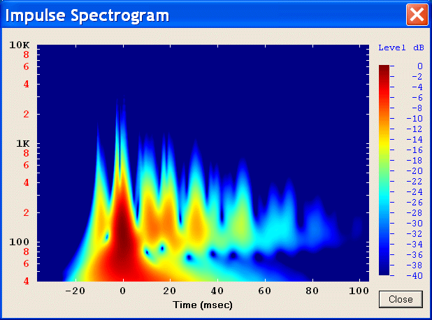

Hello,
The spectrogram in Hornresp has been improved.
The new calculation runs faster and the quality of the spectrogram is much better due to the use of a new Fourier window equivalent to a gaussian window.
See David McBean's message:
http://www.diyaudio.com/forums/subwoofers/119854-hornresp-128.html#post2223790
A test spectrogram is attached to this message
Hello,
I have to thanks David Mc Bean who accepted to included my spectrogram routine in Hornresp version 27.00.
Hornresp version 27.00 is now downloadable for free at:
Telstra BigBlog -
I designed that system (more or less) for the Goto distributor. I did not hear it as setup at the show or with the show electronics so whatever effects the room and electronics had on the sound I can't say, but yeah, the tonal balance was a bit on the bright side. I got it to the point where I thought it was subjectively flat in-room based on outside measurements, but the problem with that is that if you don't play music at realistic levels it will then always sound thin. I did this to try to maximize the sensitivity of the system for low power amps. I think I will be trying to change the crossover a bit to make it a bit less bright in the future.
Hi John, nice to meet you, virtually speaking. :wave: It is too bad you were not there, I'm sure you would have tuned the system differently. It may have been as simple as bringing down the level of the mid horn.
