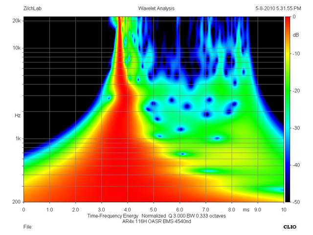

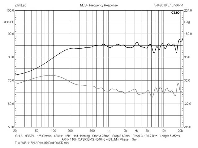

I'd suggest that properly filtered and equalized is better than normalization for comparison. It's artificial, otherwise, and not representative of actual use.To do fair comparison we have to look at the scaling - its pretty worthless to compare a 25dB and a 40dB plot - also its necessary to show normalized plots for a comparison that holds....
Every horn/driver is going to honk if driven near and/or below resonance and cutoff. The wavelet tells us how low we can actually drive it, which is also easily determined by listening to it while varying the highpass frequency. Filtered, the honk may be significantly mitigated. See #684.
I'm calling the trash above 10 kHz HOMs until proven otherwise. (Gotta get me some of Earl's magic foam. 😉 )
It's interesting to see a similar "knuckles and holes" pattern midband with both the TAD vs. XT1086. That's mouth/cab reflection, maybe. The pattern is quite regular, and the same as that of the strings after reassignment....

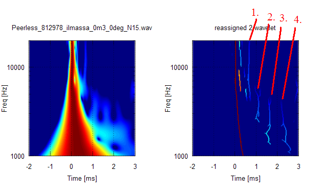

Let's see the tweeter diffraction some more.
Here 20€ Peerless dome tweeter was measured in a test baffle and some baffle edge diffraction is seen:
In order to remove the baffle edge diffractions from the above picture, let's hang the tweeter in free air by wires from the ceiling!
The reassignment points strong diffraction at 0.2ms that comes from the front plate. Then more interesting is the diffractions numbered 1 to 4. They are diffractions caused by the wave travelling around the backside of the tweeter all the way to the front again multible times. If one calculates the around length from the tweeter's physical dimensions, it's about 0.55ms for one round.

As the topic of quarter wave honk was such a interesting topic up to now, other facets of horn honk still await “in depth” discussion
But anyway - I see any looped reflections part of horn honk – though I admit that the sonics associated with horn honk are more around the voice department.
Physically though – the top end reflections are nothing else – same quarter wave honk plus some “real” reflections at the phase plug parts...
For me its especially interesting that wavelet analysis is even accurate enough to show the veeeeeery early reflections occurring with planars.
One of the few drawbacks here is that the membrane isn’t radiating free, but - with the exception of ribbons - the wave has to pass through the magnet structure first.
Usually the magnet structure is in the range of ~ 1cm – very short time of travel indeed – but the multiple reflections can clearly be seen in my NEO 3 measurements .
Michael

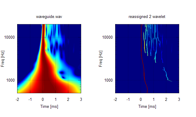

Hello,
Looking at the geldee waveguide one can see that the problem is between the driver diaphragm and the horn throath. The very short time reflections/diffractions in order of 200us are not from the expansion part of the horn but the missmatch of driver and the throath. No foam can help here! You would need to stuff your foam inside the phase plug 😀
I would say anything above 4kHz here is HOM 😀

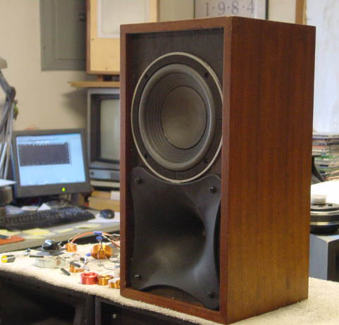

Direct radiating drivers are always going to be cleaner than horns without foam inserts.
No, its not the question of „foam or not foam“ !
Foam - or any other dampening material - has only limited effect on reducing odd impact of looped reflections.
If we go back to "physics" understanding -
- the veeeery early reflections we see here in most horn plots are not from the "horn" but from the compression driver itself (diffraction at phase plug parts etc.) - being integral part of the horn contour of course, as noted several times - plus the reflections at point of compression driver / horn joint

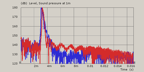

The energy time curves shown in the attached pic differ only in lip shape after the lip reaches 180deg. It is not necessarily that high frequencies are effected only by the driver section.
Of course, measurement setup can also effect horn measurements. This is why it's necessary to look at both analysis/sim and real measurements.
How then, in your opinion, the consecutive reflections/diffractions in order of 200us are formed unless in driver-throath interface?
- Elias

I think it could be anything. In order to concluded whether those are created before or after the lip, one needs to do a series of measurements, some of which probably will be in the horn. If such is not possible, then it's necessary to explore the dimensions of the driver and the throat, and thw waveguide as well. For example, how much distance does 200usec compute too? How does it relate with the existing dimensions in the WG/driver?How then, in your opinion, the consecutive reflections/diffractions in order of 200us are formed unless in driver-throath interface?
- Elias
