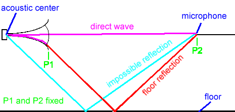

The path difference of floor reflection is based on the acoustic center, where is this acoustic center for a compression driver on a horn, I do not know. But for a direct radiating driver with a wave guide, my data show it's at the diaphragm. Since I do not know the exact dimensions of the driver and horn for your case, my assumption would be the floor. However, it would be interesting if you could use your software to analyze one of my wave guide impulse to see if it correctly identifies the depth of the device.

Hello,
I am very happy with the measurement as performed with the acoustic foam on the floor.
From the practical point of view they fulfill my requirements for good absorption of the reflected wave above 500Hz and easy placement of the horns (when you have 16 to manipulate, that's a task!)
Please remember that the 16 horns are only analyzed in the frequency range between 200Hz and 24kHz and the cut-off ferquency of the majority of them is above 400Hz. Things are different if you have to measure a bass enclosure as in this case the acoustic foam has nearly no efficiency in absorbing such low frequencies.
About what you said about the delay between a direct wave and a wave having been reflected on the floor . The analyzed horns have a non negligeible length thus there cannot be any direct reflection on floor from the acoustic center. To be possibly reflected from the floor, the wave has first to travel to the mouth. This is simple geometry. See attached graph.
As the mouth position is fixed and such is the microphone position there is virtually no possibility for the arrival time of the wave reflected by the floor to be dependant on the length of the horn. The arrival time should not differ from one horn to the other. This is not the case as we can see that the arrival time on the spectrogram varies from horn to horn inside an interval 2.5ms - 3.5ms. This varying arrival time has to be interpreted as due to the wave reflected from the mouth to the throat and interferring with the direct wave. There is more evidence of that when we can see that several horns have a high energy level for that reflected wave at high frequency (frequency above 2kHz, e.g. N°5) for which the absorption by the acoustic foam is very efficient.
For reflected waves from mouth to throat here is the equivalence between the arrival time and the distance from diaphragm to the discontinuity creating the reflection (generally a truncated mouth).
____t_________d
___2ms______34,4cm
___2,5ms____43cm
___3ms______51,6cm
___3,5ms____60,2cm
Best regards from Paris, France.
Jean-Michel Le Cléac'h
hello Soongsc,
The table on top of which was placed the measured horn is a kind of classroom table. Several of those are visible in the background of the picture.
http://www.melaudia.net/zfoto/etf10/concours/IMG_4338-800x533.jpg
The height of those tables is 68 centimeters. Depending on the diameter of the horns the axis of the horn was at a height comprised in the interval from 75 to 85 centimeters. The horizontal distance from mouth to the capsule of the microphone was fixed at 1.40meter (the SPLmeter was at 1.5 meter during the setting of the reference acoustic level on filtered noise)
This means that, the difference of pahlength between the direct wave and a wave reflected by the floor is comprised between 62centimeters and 80centimeters. This means also that the delay of the wave reflected by the floor versus the direct wave is comprised between: 1.81millisecond and 2.33millisecond. This doesn't fit with the mean value of 3 milliseconds you can see for what I considered as reflected waves from mouth to throat on the spectrograms. The difference of path between such reflected wave by the mouth to the throat and the direct wave being the double of the length of the horn (whatever length means in that case).

Jean-Michel,
I am still not convinced. How high were the mic and horn located off the ground?

I did not think reflection from the mouth could be so bad because I have not seen this in my measurements. However, in some analysis, I do see things like this in larger horns/waveguides, and scratching my head trying to figure out what causes this. It does not seem to be the lip only, but rather a combination of curvature and lip design.

As the increase of group delay near the cut-off frequency is a common feature to all the horns measured at ETF2010 and, as this feature is not displayed on the spectrogram of a Dirac, I prefered to choose as a reference, the spectrogram of the impulse of a theorical horn.
