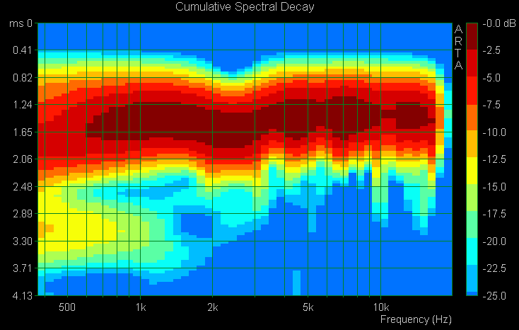

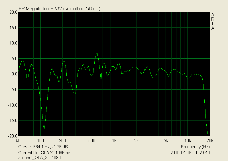

Ummmm,

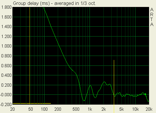

- Am I being unfare to Zilch by posting these pics derived from the following parameters ?
- I imported the OLA WAVE file into ARTA ( that Elias had transposed ) / then went for a HiRez look-see and got the following .
- ( 91 ms Gate / Full Window / 256K FFT )
- Am I looking at a whole lot of diffraction effects here ?
- Zilches' Original FR Look :
<> EarlK
<> EarlK

Room reflections?Ummmm,
<> EarlK

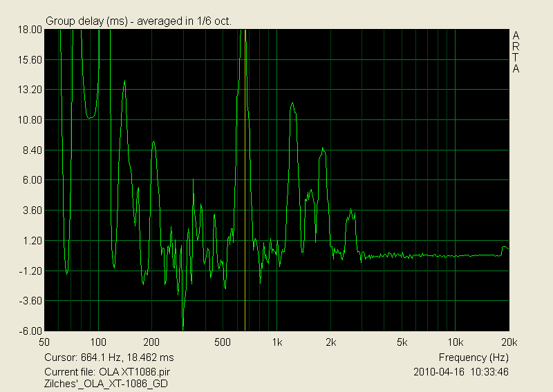

Hello Earl,
here is attached what I consider a better group delay curve for Zilchlab IR. (I think you didn't use any marker before the first main reflection arrival.) But your's and mine lead to the same intrepretation.
We can see that above 3 kHz the group delay curve is very flat. (so it is "less" flat below 3kHz)
Best regards from Paris
Jean-Michel Le Cléac'h
<> EarlK
J-M said:here is attached what I consider a better group delay curve for Zilchlab IR. (I think you didn't use any marker before the first main reflection arrival.) But your's and mine lead to the same intrepretation.
Thank-You for that !
<> EarlK

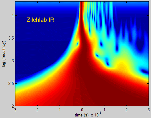

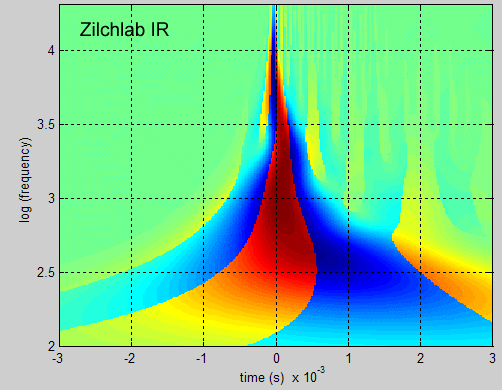

Hello,
You'll find here attached quasiwavelets graph (amplitude then hybrid amplitude x sign of phase) I obtained using my Matlab routine on Zilchlab IR.
(eventually compare with the quasiwavelets obtained for 2 crossovers I previously gave)
Best regards from Paris, France

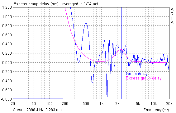

Here is the same thing plotted at 1/24 octave smoothing rather than 1/3 octave. The group delay curve is quite noisy but plotting it as excess group delay shows what is going on better IMO, removing group delay caused strictly by the frequency response.Hello Earl,
