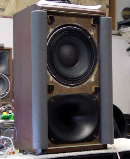

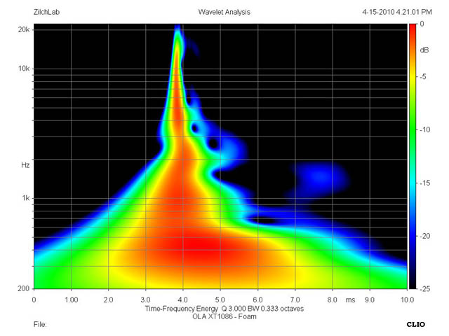

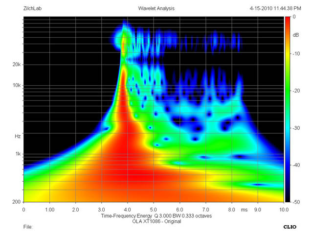

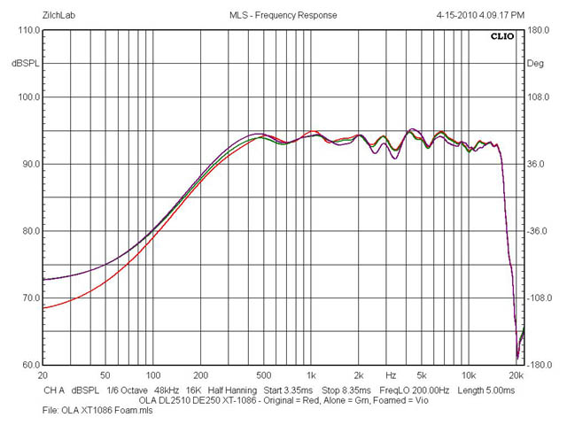

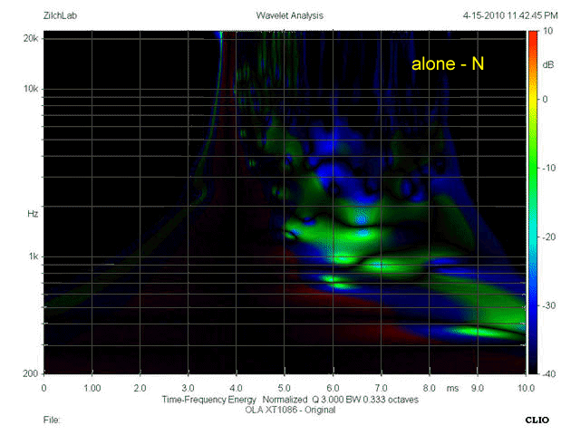

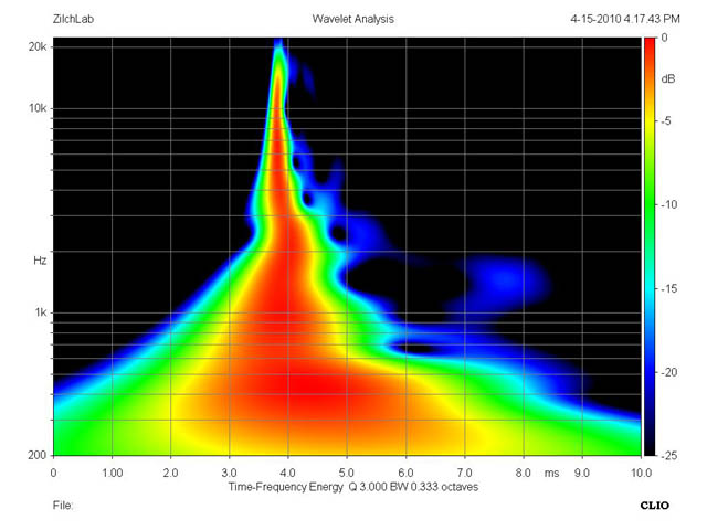

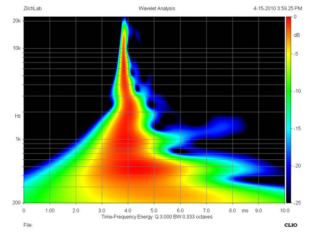

Sandbag Removal:
Let's see how some obvious changes are reflected in the wavelet. Here's the original rendering with the full 5ms windowed bandwidth:
Now, remove the second developmental speaker that was sitting next to it:
Finally, put foam insulation on the protruding edges of the cabinet, making them more prominent, actually, but rounded:
The FRs under these three conditions:

Can you show the data in a 40db range instead of 25?
and use normalization please too...
Not a lot of work involved -- I'm just clickin' buttons here. 😉
Great button clickin' you are doing here
The wavelets are not normalized; I can do that, but all it does is bump up the falloff at 20 kHz.
There's stuff happening up at 40 - 50 kHz, but that's gotta be aliasing, because the data was acquired at 48 kHz, no?
If so we would be in serious trouble, I guess – but most certainly its just simple cone break up from the compression driver we see here...
State your hypothesis as to where it is appearing in the wavelet and we'll test that out.
[There's a bigger sandbag, tho.... 😉 ]
Ha ha - the “sandbag” of diffraction alignment

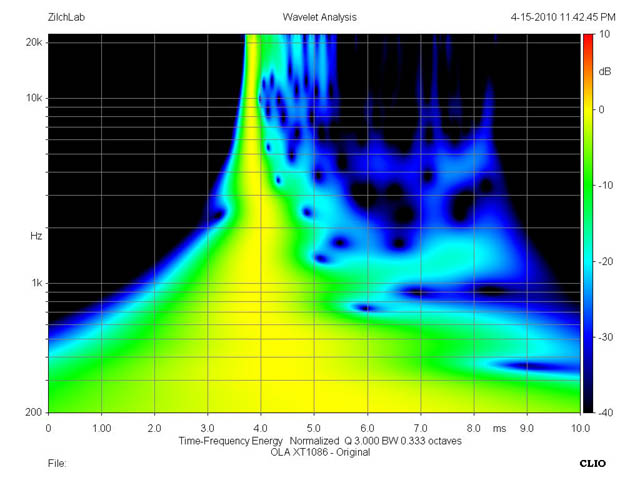

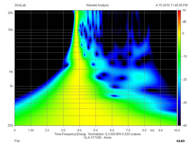

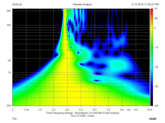

By Popular Request:
For starters, you math heads can figure out what's happening up there above 20 kHz; CLIO max sampling rate is 48 kHz for this version:
Here's the three, normalized, to -40 dB:
For fun, open them in separate tabs and click among them.... 😉
The "bigger" sandbag was the second speaker sitting right next to the DUT.Ha ha - the “sandbag” of diffraction alignment.... 🙂
[It's been instructive, tho....

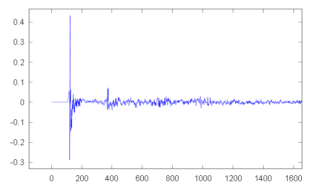

That worked like a charm! IR looks like this, the x-axis is in samples.
Can you tell the sampling frequency, so I can write WAV file and post here?
I can post an Octave script that converts Clio IR exported .mls file to WAV.
Oh yes ! - under GNU license please.
Have an easy way to import ARTA *.wav date file as well ?
I didn't have time to figure this out - as the easy way on direct matrix assignment ( [matrix] = load("file"); ) fails due to non-consistent row count.

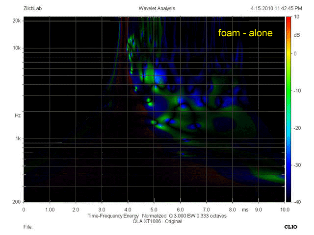

Hello Zilchlab,
I did some image analysis treatments of your spectrograms.
You'll find in attached files a first image representing the difference between you spectrogram for the first setup (in vicinity of a second enclosure) and the second (alone enclosure).
Then in a second image you'll see the difference between the spectrogram of the foam filled horn and withot (the spectrogram for the"alone" case).
As we can see the presence of a second enclosure or whatever piece of furniture is visible on the spectrogram over 5kHz and for delay above 1,2ms .
We can see also that the foam filling is important over 4kHz and for short delay (less than 2 ms).
An important thing to notice is the removal of some short delays reflections (bright green spots - may be HOMs) for delay less than 0.6ms and frequency over 3kHz (roughly).
Best regards from Paris, France
Jean-Michel Le Cléac'h
