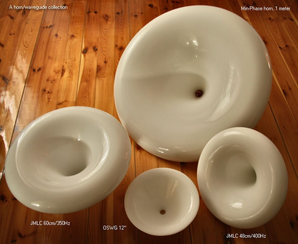

Inversely to the common knowledge waveguide don't have less HOMs than horns. What an OSwaveguide do better than horns is that it uses the HOMs in order to reflect them in various directions in order to obtain a more evenly distributed directivity.
Best regards from Paris, France
Jean-Michel Le Cléac'h

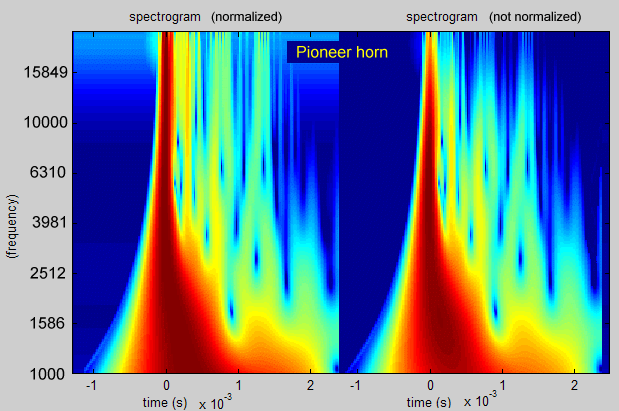

Hello Panomaniac,
You can find in the attached file 2 graphs obtained using my Matlab quasi-wavelets routine on the impulse response of the Pioneer horn you gave. One is with the normalized response, the other one for the not-normalized response.
Which Pioneer horn is this (TH4001?)
I'd like to see a wavelet or good CSD of the Pioneer horn, but I"m having a devil of a time. Can anyone help? Impulse is attached below.
And here is the FR graph. Remarkable for a horn. 2nd harmonic rises sharply below 750Hz (not shown here).
If someone can run a graph on this and tell me what your setting were, that would be great. Thnx

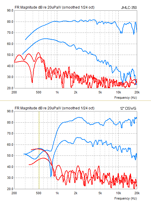

Yes there is a large amount of reflections/diffractions before 1ms in OS seen here also in this plot 4kHz-20kHz:
Mouth reflections are different phenomena than the above but they do exist in OS
- Elias
Hello,
You'll see in attached file a comparison I have done using my Matlab routine (quasiwavelets) between a Le Cléac'h horn (Fc = 320Hz) a JBL waveguide and an OSwaveguide. I modified somewhat my routine in order that the shown graphs are normalized in amplitude.
Elias yet gave some multiresolution wavelets graphs for those horns and waveguides in the message:
http://www.diyaudio.com/forums/multi-way/161627-horn-honk-wanted-33.html
The vertical stripes having an yellow-orange color you can see on the graphs for the JBL and the OS_waveguide appear within the interval of time between 0 and 1ms. This means that there are due to reflexions having a short delay( by that I mean that the correspodning delay is smaller than the delay due to the reflection between mouth and throat.)
IMHO a large part of those short delay reflections are HOMs.
To confirm or not those yellow-orange stripes are du to HOMs we should analyse with the same method the impulse response at different off-axis angles.
Hello,
I agree with Jean-Michel, there is no noise issues with those IR files that would prevent wavelet analysis. Inherently built in feature of wavelet analysis is its noise rejection ability due to its band pass filtering nature.
See post #323 in this thread to see the noise level of JBL and OS files. See before the beginning of the wavelet above 1kHz, and you'll see the noise is below -35...-40dB in the normalised plots (right hand side). And then compare the plots showing the temporal reflections/diffractions and you'll see they are much higher in amplitude thus having nothing to do with noise.
Even if the noise would be at higher level, one could still see the temporal sequence of reflections because they do not correlate with random noise.
- Elias

Thanks Jean Michel! I was having a hard time with that.
It looks better in FR and distortion than it does in the wavelet.
The only markings are on the drivers. PM-40-1
Horn is bent 90 degs about 70mm from the driver. Small throat, only 16mm
Horn mouth is 31.5mm wide x 14.5 tall.
Driver has the female thread, not the horn.

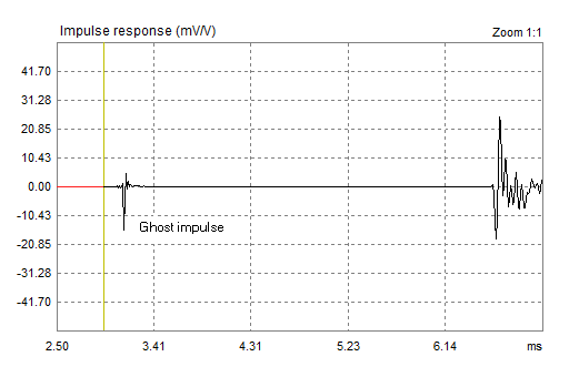

Michael,
It seems that you haven't gated ghost impulse response. Ghosts could happen with MLS stimuli.
...might be – but leave those "time machine ghost pattern" aside and have a look at my worst piece of honker (0 deg horn with no round over = quarter wave tube of 20cm length) there:
http://www.diyaudio.com/forums/multi-way/161627-horn-honk-wanted-8.html#post2128416
There should be no horn performing any worse as above !?
