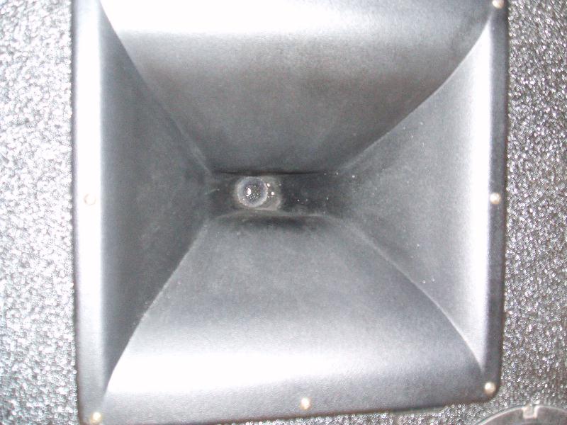

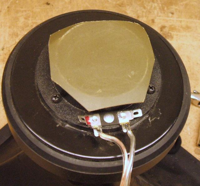

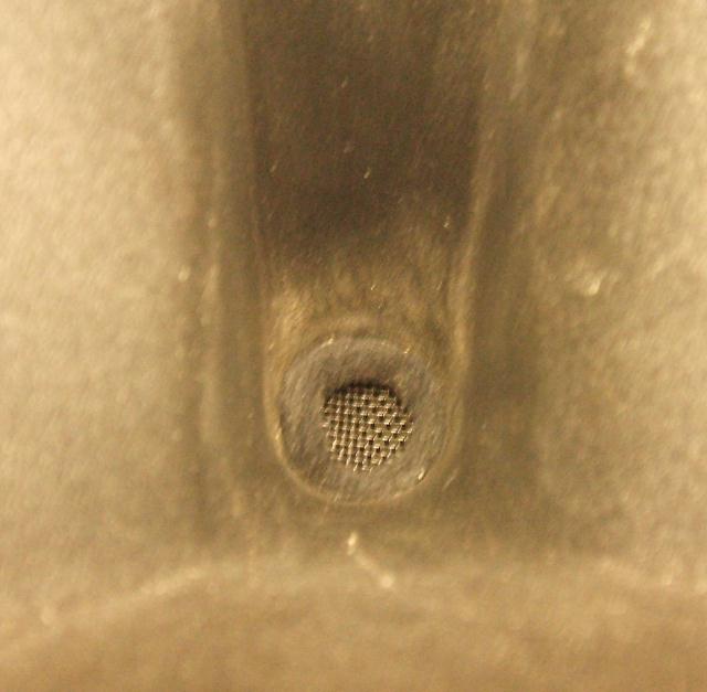

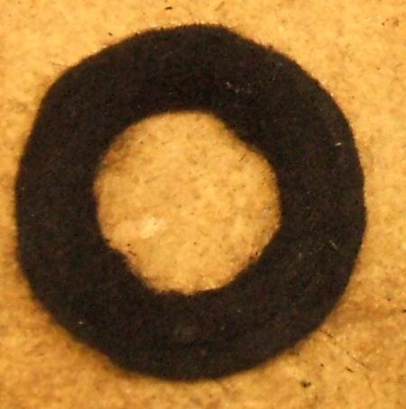

Dayton horn, Eminence driver, & felt ring
Retesting will occur later as soon as we can go back to the big open field when the wind is not blowing 25mph. The original data was not saved.
Here are some pics. Having the felt ring extremely neat is not necessary probably. The back of the diaphragm resonated so a piece of SD .063 from EAR was added and pretty well controlled that.
I believe it was have luck and half educated guess on this.
A little contact adhesive was required to hold the ring to the compression driver.
Tested better with screen in place.
Dirt in the horn- wrong!
The ring did change the excess time measurement by a couple of inches closer. One of the problems with all transducers is the apparent source moves closer or further away depending on frequency.

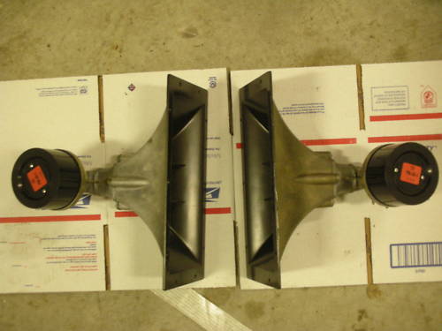

Here is yet another horn. Does it honk? Funny little Pioneer horn and driver.
Not a real compression driver, I don't think. Very benign impedance curve and flat response. Trade off is lower sensitivity. ~101dB/W
Impulse is attached below in a zip file. You'll see some trouble in the low end, but below where this should be crossed anyway. Response is flat and distortion is low.

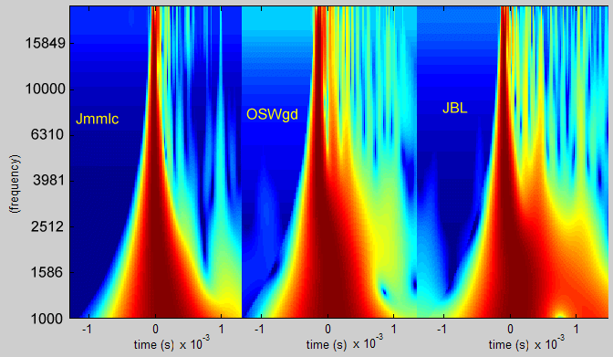

Hello,
You'll see in attached file a comparison I have done using my Matlab routine (quasiwavelets) between a Le Cléac'h horn (Fc = 320Hz) a JBL waveguide and an OSwaveguide. I modified somewhat my routine in order that the shown graphs are normalized in amplitude.
Elias yet gave some multiresolution wavelets graphs for those horns and waveguides in the message:
http://www.diyaudio.com/forums/multi-way/161627-horn-honk-wanted-33.html
The vertical stripes having an yellow-orange color you can see on the graphs for the JBL and the OS_waveguide appear within the interval of time between 0 and 1ms. This means that there are due to reflexions having a short delay( by that I mean that the correspodning delay is smaller than the delay due to the reflection between mouth and throat.)
IMHO a large part of those short delay reflections are HOMs.
Inversely to the common knowledge waveguide don't have less HOMs than horns. What an OSwaveguide do better than horns is that it uses the HOMs in order to reflect them in various directions in order to obtain a more evenly distributed directivity.
To confirm or not those yellow-orange stripes are du to HOMs we should analyse with the same method the impulse response at different off-axis angles.
Best regards from Paris, France
Jean-Michel Le Cléac'h

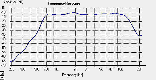

I'd like to see a wavelet or good CSD of the Pioneer horn, but I"m having a devil of a time. Can anyone help? Impulse is attached below.
And here is the FR graph. Remarkable for a horn. 2nd harmonic rises sharply below 750Hz (not shown here).
If someone can run a graph on this and tell me what your setting were, that would be great. Thnx
Hello Jmmic
That's the way it looks with those measurements but should we be using the above wavelets graphs as comparative examples?? There was a noise issue when Earl made those measurements. That could easily be a reason for all the clutter in the first milisecond. To get this right we really need to get all 3 horns measured under the same conditions using the same driver. Picking up other peoples mearurements and combining them doesn't really help things and adds confusion to the discussion. You don't know the driverS or the conditions the measurements were made under. Are we talking 100mw, 1 watt, 10 watts?? Distance?? Outside with the birds chirping or in my basement with the furnace and refrgerator running??
I am not saying we can't get information from them just that it may not be a fair comparison because of the variables in the measurements.
Rob🙂
Hello Robh,
There is no noise issue there.
Earl send 2 I.R. of his OS waveguide, the first one was noised but the second was not and the the impulse response was validated by Earl after analysis of the waterfal calculated by Jzagaja.
I disagree about the irrelevance of the compared results of the same analysis performed by 2 different persons. The IR given by Earl was chosen by him as representative of what are the mesurements for his waveguide and the measurement of my horn (while rapidly done) is also representative of most measurements done on Le Cléac'h horns IMHO. Nobody will present a measurement that is realized in very bad conditions and not representative of his own design.
You demand for measurements performed in the same conditions seems legitim but is unrealistic IMHO (specially when it comes to Le Cléac'h horns versus OSwaveguides...).
Hello Jmmic
Hello Jmmic
I didn't know there was a second measurement and I stand corrected. Thanks for setting things staright.
Well you are probably right about that. You would need a couple of guys to get them all together to do it as no one seems to have it all on there own.
Rob🙂
