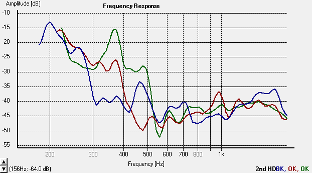

Low frequency cutoff
When I was doing the measurements of various horns, I noticed a similar rise in the 2nd harmonic at the low end of the graphs. The smaller the horn, the higher the frequency where the 2nd harmonic goes rapidly north.
So I measured and found - yep - 2nd harmonic distortion skyrockets below a wavelength that corresponds to the with of the horn mouth, flange included.
In the graph below we see only the 2nd harmonic of 3 horns with the same driver. Blue = Altec 511 Brown = Altec 811, Green = Dayton H8 horn. All driven by the same Alec 806 driver.
The graph scale is for the fundamental, so the 2nd harmonic will be an octave higher. Or you could say the distortion rises at 1/2 wavelength of the fundamental cutoff.
Nothing groundbreaking here, just fun to see it in the measurements. It's also easy to hear when doing the sweeps.
