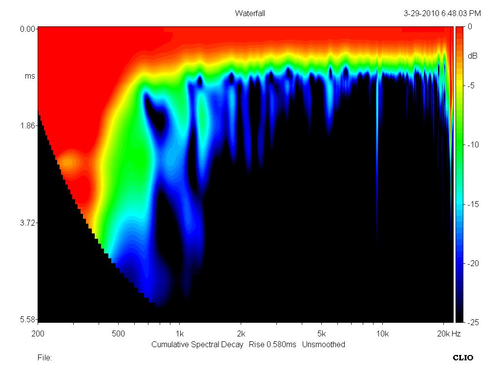

Here's a group of graphs to look at all from the same measurement. Do we have a honker here?? If so why and what posted measurement is the most useful??
Rob🙂
You need the wavelet graph 😉
It's a CLIO MLS file. If I convert it to a text file will that work for you??
Rob🙂
Im still learning to do it so lets wait. Im just trying to get my own .wav file working.

Here's the normalized CSD
Rob🙂
There is that darn thin line up around 9.5-10K that shows up on so many of my graphs.
What the heck is it?
Ok Jean-Michel, that adaptor's acoustic discontinuities propably explain the two reflections before 2ms and the reflections between 3 and 4ms.
Seems to be that most likely there is honk in this horn! 😀
