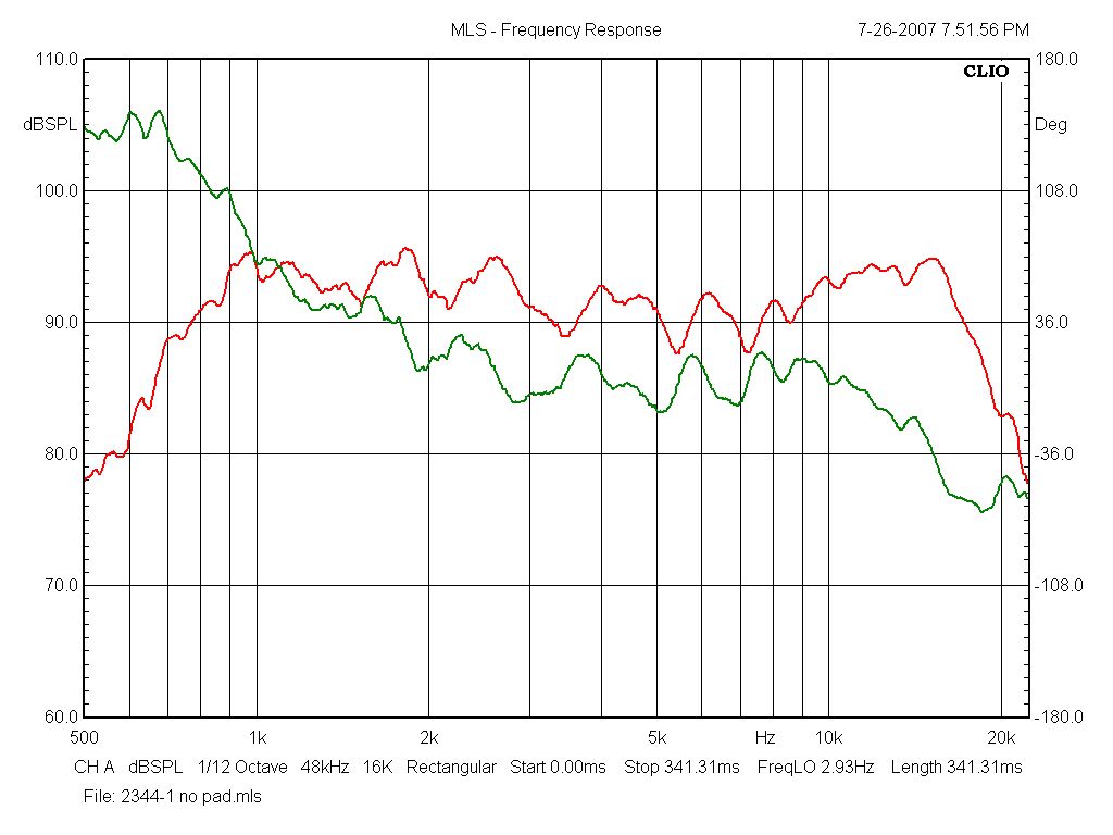

Here's a JBL 2344 it's a 1" 1K Diffraction horn used in the 4430/35 monitors that were the original CD monitors from the 80's. Doesn't look that bad to me over it's intended bandwidth especially compared to those 2 octave tweeters.
Rob🙂

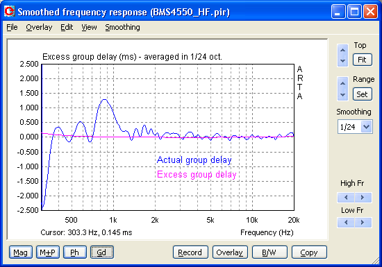

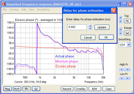

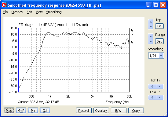

IMO, it's easy to get confused and misled by all this phase and group delay stuff. One of the things I really like about ARTA is its ability to plot excess phase and excess group delay. Definitions as I use them:
Actual phase: measured phase with the time of flight removed.
Minimum phase: phase calculated from the magnitude response with a Hilbert-Bode transform. This is the phase that an electrical filter with the same magnitude response would have. If the device under test is minimum phase, electrical EQ will fix the phase response when it fixes the magnitude response. Flat magnitude gives flat phase.
Excess phase: actual phase minus minimum phase.
Group delay: same as above except expressed in ms. rather than degrees.
Let's look at Doug's measurement of the BMS4550 on a QSC 90x60 horn. Not sure but I think he had a large cap in series. The magnitude response tells us it isn't going to be very useful below 800 Hz.
How about the phase response? The actual phase, with time of flight removed, starts looking goofy below 4K. BUT the minimum phase is almost the same as the actual phase and the excess phase is nearly flat and nearly zero. Any EQ or crossover work we do on this horn will fix the phase when it fixes the magnitude. The phase wrap around 850 isn't any different than a 4th order electrical crossover would give. The excess phase gets a little goofy above 10K but the sampling rate was only 48K so that could be an artifact of the sound card's brick-wall filter and/or the test amp's HF phase response.
Jean-Michel likes to use group delay to choose a cutoff frequency. If you look at the actual group delay, it looks like it has big problems around 850. However, if you plot excess group delay, those go away. The group delay is strictly a function of the magnitude response, no different than an electrical filter would give. Now you might not like the sound of 4th order filters, but the sound is caused by the shape of the mag curve, not by some property of horns that is different than any other minimum phase device.
Bottom line, for this horn-driver combo, phase and group delay plots aren't giving us any useful information that isn't contained in the magnitude plot, at least as far as choosing a useful frequency range. We need to look elsewhere for distortion and that elusive horn honk.
