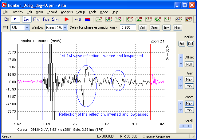

To give a picture of the specific sonic pattern occurring from "looped reflections" (quater wave honk that is) I show here measurements that do not need *any* sophisticated processing.
Would not recommend though this to become the standard procedure to detect that sonic pattern of quarter wave horn honk, as its painfully time consuming....

Well I guess that finally should make 100% clear that above is a sonic pattern that is very specific to recurring reflections and easy to distinguish from "simple" resonance.
There is no doubt that until the first reflection ( < 15ms in this case) we get a frequency response that is completely different from the frequency response later on.
Also there is a sharp discontinuity at exactly the delay time – not at all the same as a resonance that builds up *without* any discontinuity.
In a log scale we possibly would be able to see the re-reflections as well

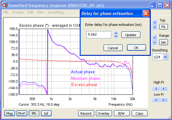

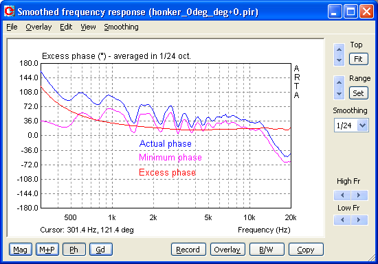

Thanks Michael. The 1m impulse of the 0 degree honker clearly shows the 1/4 wave reflections.
Now taking a look at the phase and my theory that a 'good' horn-driver combo should act like a minimum-phase device with the excess phase being near a flat line and near zero. the 0-degree honker has excess phase even with the time of flight removed.
Compare to Doug's BMS4550 + QSC horn. The excess phase above 10K could be due to the BMS breakup but it looks good below there -- flat and near zero. Phase behavior may not be enough to tell the difference between a good horn and a great horn but it may be enough to spot a really bad horn.

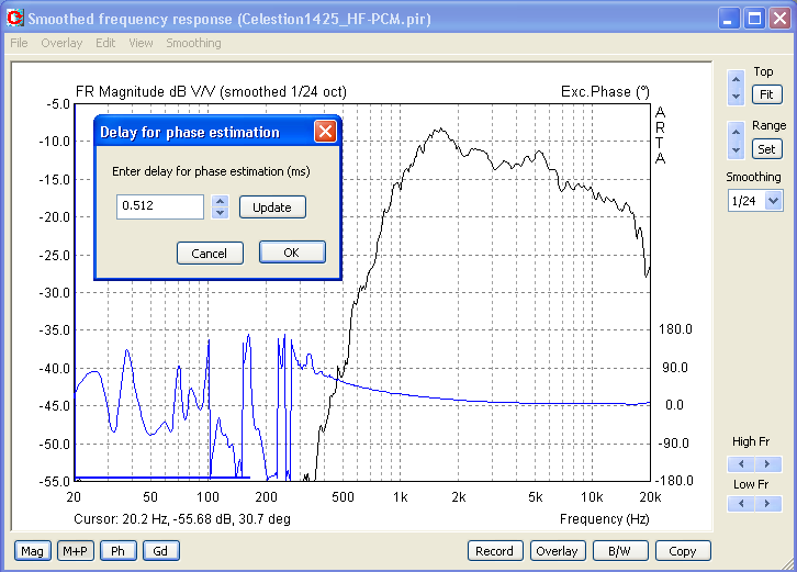

Here's an old pic of Doug's measurement of the Celestion 1425 on the same QSC horn. It looks good up high but starts showing excess phase down low. Ignore everything below 300 Hz due to gating. Doug confirms that, subjectively, it doesn't sound good crossed low.
