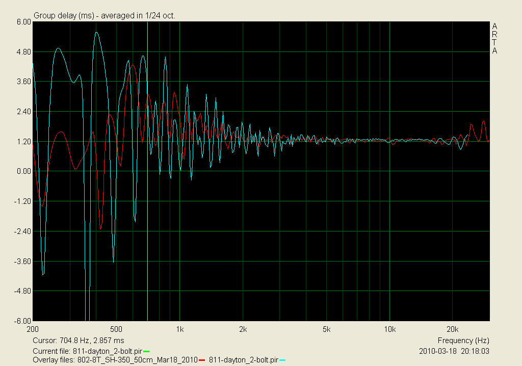

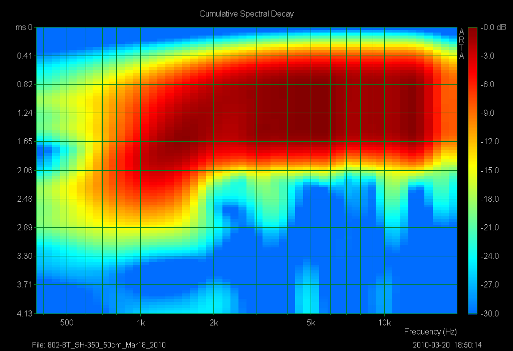

- FWIW, ( because it's a little bit off-topic ) , but I too would like to see Thend post some GD plots that would provide some sort of "PROOF OF CONCEPT" for this idea / ( of matching Fa/Fc to Fs ) .
- I'm not challenging the concept since I know JBL does something similar ( these days ) for some of their world class SOTA systems .

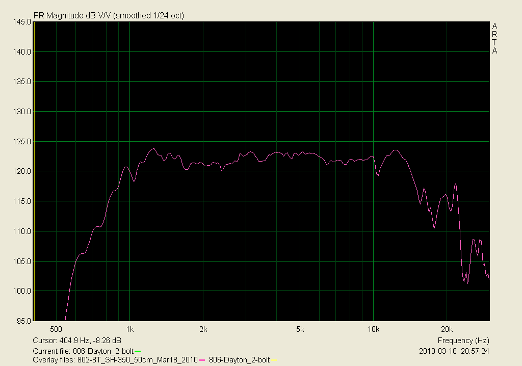

- Here's a group delay plot derived from Panos posted IR ( wave file ) for the 806 on the Dayton , 2-bolt exponential . Remember his HP was down around 400 hz ( I think ) & was 3rd order ? .
- I've superimposed his GD over a GD from my Altec 802-8T mounted to one of my Sammi SH-350 horns ( which is same horn as the Dayton, I believe , look here ! ) .
- My HP is a single cap which is effective at around 1K ( I believe ) .
- Getting the FR of this combo to be this flat was quite simplistic / just a simple RC contour circuit ( no LCR notches ) . I don't recommend others buy the horn since it's very directional / I use it to test a drivers on axis performance / that's it .
- Anyways, one can see the effect of Panos higher order HP in the GD curve when compared to my single pole filter . ( His Group Delay is Blue while mine is Red ) .
- Is it just me ? or does anyone else think that the CSD "time-swelling" below 2K is all attributable to my HP filter ?
- Anyways, I'm gone till next Friday / have fun !
