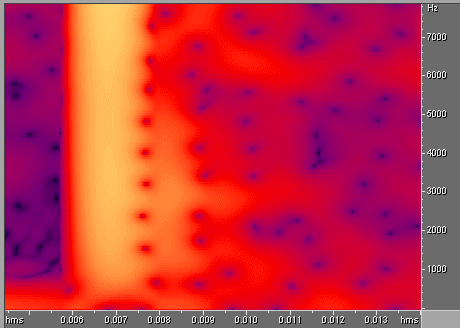

Below is the "as good as it gets" AutoSignal wavelet analysis of the
conical 0 deg included (quarter wave transmission line - no round over)
Well – at least we see *some* reflections of the transmission line being visualized in the time domain...
But we totally miss the transition into the ragged frequency response and a lot of details I expect to see too
No way to do normalized plots as well (as far as I found out)
Michael
Might be I've cut the peaks (the red plain) – so the rugged FR can't be seen – will have a look into that later...

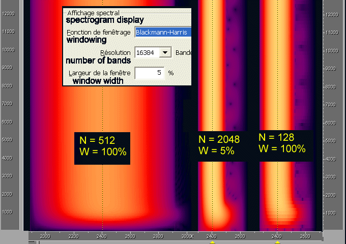

There is a need for uniformisation of how the parameters for the CSD (Arta) or the spectrogram (Adobe audition) are named.
You'll find in atatched file 3 spectrograms of the impulse response of a Butterworth 4th order HP filter at 1kHz obtained using 3 different settings of the spectrogram in Adobe Audition.
The parametering window use 2 mains parameters : the "resolution" which is expressed in number of bands and the "width of the window" expressed in %.

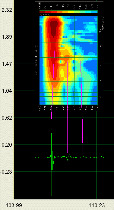

I don't see why the first pulse should be bad with a 0° horn ( = tube=... there is no reason for that , it should look similar to the power response of the driver.
Until the first reflection nothing bad can happens to the tube response.
The comb effect we can see on the CSD between the first pulse and the first refelction cannot be perceived before we ear the "first reflection".
I don't think there is much more to learn on you CSD ( a first reflection with high frequency attenuated, then a second refelction with an higher Q and the comb effests due to interferences between the first pulse and the first reflection (eventually with some interferences with the second reflection).
You have discovered that it will be more difficult to see reflections in small horns or tubes...
I attached a graph showing the relation between the CSD and the impulse waveform. For what its worth...
Much more intersting should be to map the first reflection(s) at a given radius from the throat in order to identify Homs...
Thanks for the pix – very intuitively as well!

BTW here is the "corrected" plot from that commercial software (top not cut this time 😀 ) – still not what I would like to see in resolution but we get a basic idea of the grid / steps caused by quarter wave reflections at least.
Also its *NOT* log in frequency axis to better show the equally spacing from comb filtering...
above again - conical 0 deg included (quarter wave transmission line - no round over)

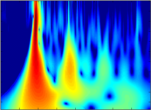

I think that HOMs will look different on CSD or alike than reflections from mouth to throat.
Specifically I think that the delay of one mode order from the main direct pulse will be frequency dependant .
If we take the wavelet as Elias do as an example HOMs will not appear as vertical thin strips but as curves.
But to differentiate them from reflections from mouth to throat, mapping at a given radius from throat will be better IMHO.

I confess, I do not understand. What info is presented in Wavelet that is not in CSD?
To me, at least so far, wavelet looks like CSD from a different viewing angle...looking straight down from above rather than oblique/3D perspective of CSD. What am I overlooking?

1. CSD (!!!) sonogram as recommended by Jean-Michel for lowest artefacts (upside down):
2. My very low level wavelet (!!!) analysis of the same "0deg honker":
and 3. JMLC' latest Audition plot (CSD or wavelet ? - I do not know )
The difference in pattern recognition capability should be obvious – no?
Elias' plots have been even more detailled...
The grid structure I was talking of is
1. equally spaced time of flight delays – in the horizontal here
2. equally spaced frequency ripples from comb filtering – in the vertical here (better seen with linear frequency axis)
We are actually doing nothing else than "data mining" (where wavelet analysis is also used !) meaning we are not only after the needle in the hey stack but after a clear picture what that needle may look like at first hand – visualized in the common time and frequency domain.
So – in the end this wavelet analysis is nothing else than a biiiiiiiiiiiiig NEO-magnet and the Fourier based CSD is a big ceramcic- magnet.
Both will possibly bring up some rusty nails we are not interested in too - what counts IMO is which method provides (and also is able within its theoretical limitations (!) to provide ) the clearer picture
Michael
Hello Michael,
You'll see in the attached file a graph (corresponding to your "Honker_0deg") that most probably you'll take as a "wavelets graph" like Elias'ones.
It is an output from a run of a piece of software I once wrote in Matlab language at a time I never considered wavelets. (I did "wavelets" without knowing "wavelets")
In fact it used a Morlet pulse (sine/cosine with a bell shaped window) having a variable width with frequency (width = a fixed number of periods) and TFD (not FFT). Using TFD you can use whatever frequency scale and resolution you want. The low resolution of common CSD is due to the use of FFT. In A CSD with a logarithmic frequency axis you don't need 24000 frequency steps, only 300 to 400 are needed, so to use TFD is not time consuming.
Notice: in the Impulse Response module I once wrote for David Mc Bean and which is used in Hornresp the reconstruction of the Impulse Response is based on a "quasi" inverse TFD using a Morlet wavelet the width of which is variable in frequency. May be I can call this "IR reconstruction with wavelets" ;-)
In fact when wavelets are used with sine/cosine based symetrical wavelets the problem becomes quasi similar to sliding TFD... (there is a continuum).
Best regards from Paris,France.
Jean-Michel Le Cléac'h
(I can give freely the Matlab code but many improvements has to be done on it as correct axis ticks, easier choice of look up table...)
