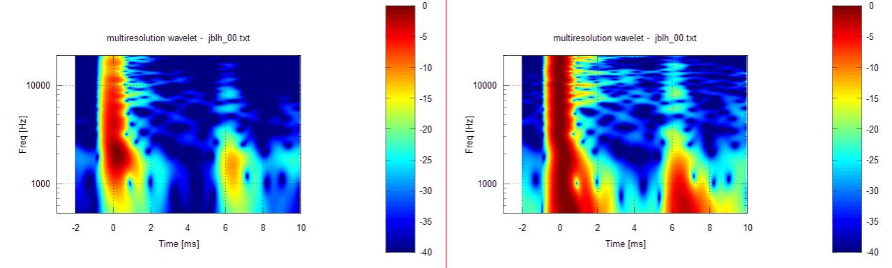

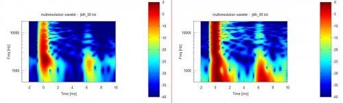

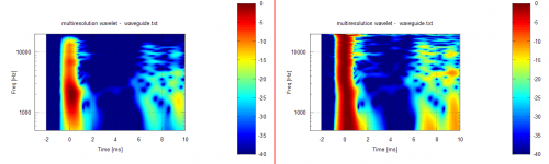

Hello,
Here comes first set of wavelet results for the IRs of OS and JBL horns.
The actual difference between jbl_00.txt and jblh_00.txt was not clear to me, taking into account almost no difference in plots.
On the right hand side is response normalised to 0dB at every frequency. It's better to see the normalised responses if you want to compare temporal effects!
First JBL:
jbl_00.txt:
jblh_00.txt:
Then OS:
this is the original waveguide_00.txt:
and here's the 'less noise' waveguide.txt:
Apparently JBL and OS had different drivers. It can explain some of the differences. It's clear when a vendor advertises his product one may think better driver is used for his product than for the competitor's product.

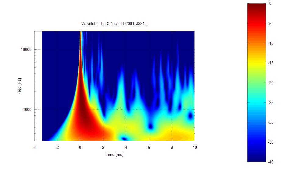

Then other interesting measurement. There was also another IR file for Le Cléac'h J321 with TAD2001
td2001_j321_u.txt:
I think J321 response looks more 'straight' and balanced than OS or JBL.

Hello Elias,
I see many similarities between your multiresolution wavelets graph and my CSDs. Is there any feature that you can see on your wavelt (for the JBL and the OS Waveguide) that we fail to see on the CSDs?
About the file td2001_j321_u.txt this is the pulse response for a voltage driven TD2001 mounted on one of my Le CLéac'h horn Fc = 320Hz (it was built and commercialized by Marco Henry under the name Jerzual321 or J321).
The td2001_j321_i.txt pulse response previously seen
http://www.diyaudio.com/forums/atta...1268301562-horn-honk-wanted-td2001_j321_i.txt
http://www.diyaudio.com/forums/atta...-le_cleach_td2001_j321_i_300-20k_wavelet2.png
in that thread is for a current driven TD2001 mounted on the same Le CLéac'h horn. The current drive allow to fill the famous hole around 1600-1900Hz which is a characteristic of the TD2001 (anti resonance due to the cavity behind the coil gap according to Kinoshita).

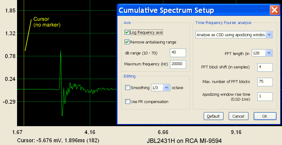

Hello EarlK,
You'll find in attached file a screen copy showing the position of the cursor (yellow line) and the parameters you can use in order to obtain a good CSD of your impulse response.
(notice: as your mesaurement doesn't need any, no marker before the first room refelction has been used ....)

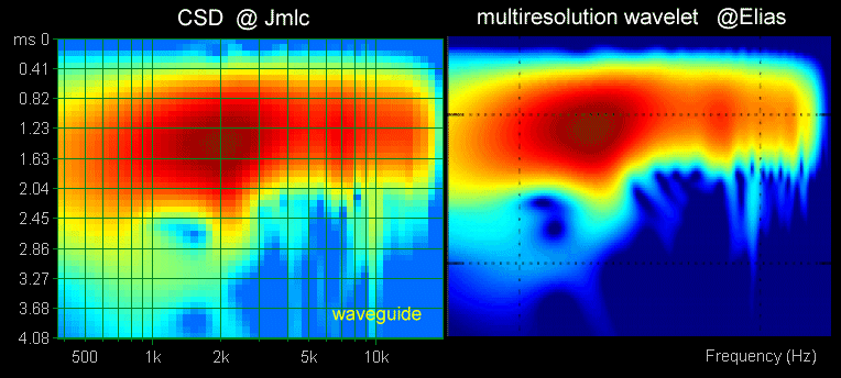

Hello,
You'll see in the attached graph a comparison of the CSD and the multiresolution wavelet analysis obtained on the OS waveguide IR.
For the wavelet graph, I took Elias's graph and selected the zone seen on the CSD then I redimensionned the X and Y scale in order for the 2 grap to be compared.
Apart some extra resolution for the wavelet analysis, there is no fundamental difference in the way both graph may be intrepreted.

Thank-you JM , the guidance is very much appreciated .

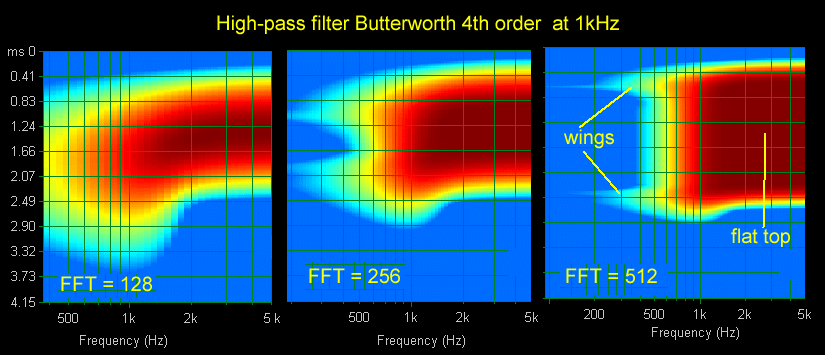

Gave it an hour or two to come as close as I could get:
http://www.kinotechnik.edis.at/pages/diyaudio/GD_HighPass/honk_wanted/waveguide_less.noise.pir
First with 128 FFT length
now with 256 FFT length
There is a interesting difference in the 2.5 –7 kHz range in how the two visulalisation tools perform.
I have no ideas which one is "right" - what you think ?

Hello,
The 256 version of your CSDs has a flat top that I don't like and subsequent artifacts on left side...
If the CSD tool in ARTA would have twice the number of frequency channels it's appearance would be nearly the same as the wavelets graph.
I would like to see such a multiresolution wavelets graph in ARTA but only if it reveals itself easy to use. For the moment I think the CSD tool in ARTA is sufficient for most purposes but it seems to be a bit painful to use by many.
At least, looking at you last CSDs you seem to begin to be easy with this tool. ;-)
(Good idea to use a FFT block shift value of 1 and a number of block of 200, the graph is smoother...)

Hello,
In order to show how the FFT length influence the shape of the CSD I took the pulse response from a Butterworth 4th order high-pass filter having F-3dB at 1kHz.
I did, under ARTA, three CSDs graphs using different FFT lengths (in the "CSD parameters" window).
You'll see on the attached file 3 CSDs obtained respectively using FFT lengths of 128 ; 256 and 512 samples.
As you can see choosing a large value for the FFT length results in artifacts that I respectively called: "flat tops" and "wings".
The CSD obtained with an FFT length of 128 is devoid of those artifacts.
So if we summarize, in order to obtain a good CSD:
1) choose an FFT length having a small value (128 samples)
2) choose an apodizing rise time having a large value (1ms)
3) choose an FFT block shift having a small value (1 to 4 e.g.)
4) choose a max. number of FFT blocks such as the product with the FFT block shift is between 200 and 300 (e.g. depending on length of I.R.)
Best regards from Paris, France
Jean-Michel Le Cléac'h
Very clever, Jean-Michel! 😎 I created the multiresolution wavelet to approximate CSD, to have better comparison with other forum members. Now you have approached it from the other direction 😀 You seem to be one of the few people who knows how to use CSD 🙂
- Elias
- Elias
Wavelets are scalable => one can zoom in. Here's gedlee waveguide.txt from 4kHz-20kHz. One can investigate the driver performance.
There is a repetitive reflection pattern of about 180us. That's about 6cm. Supposedly it comes from back-forth reflection of 3cm distance somewhere from the driver, or from driver-horn matching interface.
Around 10kHz the reflections gets fuzzy, there's a resonance.
This one should be able to dublicate with CSD? (if software parameters allow)

And now 😀
Here's gedlee waveguide.txt from 500Hz-20kHz. By adjusting wavelet to increased time resolution, on can clearly see the mouth reflections. See the repetitions of the cluster at the rate of about 0.8ms. It's about 28cm, which is approximately throat-mouth-throath distance of the waveguide.
If mouth reflections are anyway related to Horn Honk, I can claim that gedlee waveguide is having some honk!
I want my prize now! €€€

JM, your settings seem to work but I don't understand them (nothing new for me 🙂 ).The CSD obtained with an FFT length of 128 is devoid of those artifacts.
48000/128 gives a 'real' frequency resolution of a data point every 375 Hz. That seems too coarse to be very useful.
128/48000 gives a sample length of 2.67 msec and then we are applying a filter/window with rise and fall times of 1 msec each.
First we threw away the low frequencies with the small sample and then we are throwing away the high frequencies with the large apodizing time. How are we left with any useful information?
Help!!!
