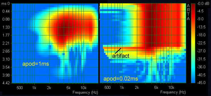

Hello Paul,
The CSD you show to us is typical of a CSD obtained with a very small apodization time.
Many people think they will obtain a better time resolution in choosing a small value of the apodization time. At high frequency this is true and we can obtain a kind of vertical wall (in the waterfall presentation of the CSD) often used by compression driver builders in order to show how fast is their driver.
But in the same time a small value of the apodization time leads to artifcats that are clearly visible on the low frequency part of your CSD graph.
You'll see here attached the effect of the apodization time on a CSD graph (the one corresponding to a Celestion driver previously mentionned).
On left the largest apodization time in ARTA (1ms), on right the smallest one (0.02ms).
IMHO the CSD on the left gives a better presentation of the behaviour of the driver.
Best regards from Paris, France
Jean-Michel Le Cléac'h

Wavelets are reality. CSD is a mathematical artefact.
I'm pretty agree.
For frequency domain the frequency window is sufficient, the temporal windowing does the rest.
