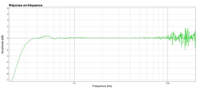

Well impedance curves can show all sorts of things, like reflections and break-up.
For beak-up, we can do disapear (almost) with calbration.
Here, a calibrate compression driver impedance:
With it, we have a not too bad microphone with the compression driver.

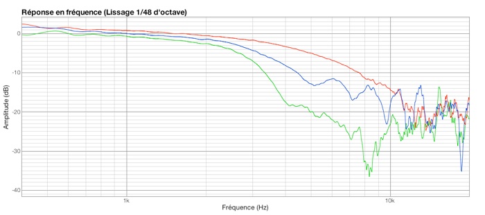

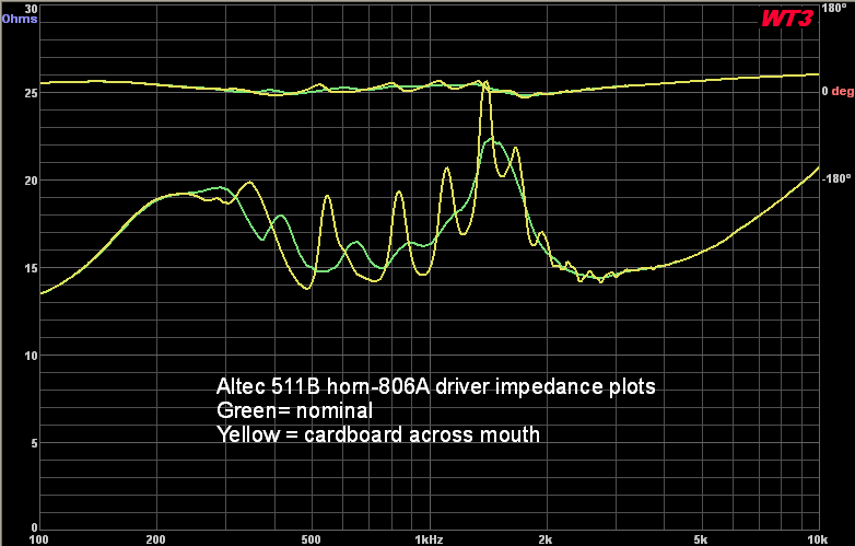

OK, I did a few impedance sweeps. Here are the two of interest.
There is the 511-806 nominal, and then with a thick piece of cardboard loosely over the mouth. This was done to generate reflections, which it did very well.
I also draped a beach towel over the mouth. The results were very similar to the cardboard, but a little lower in amplitude.
Also did towels and foam around the outside of the mouth, it showed a dlight improvement over no soft lips.
At least this may tell us where the reflections are in this horn.

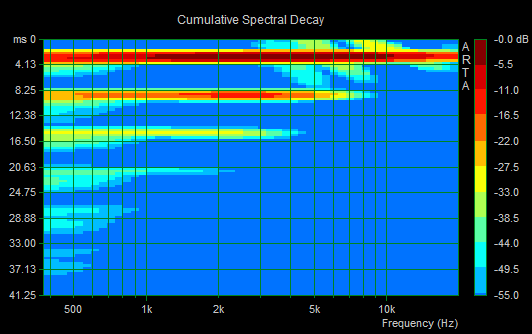

Hello Jean-Michel,
I'd like to make a comment of this CSD you posted:
Seems to be that the time between reflections/diffractions is 6ms. That is about 2m! It's a little bit long for real life, don't you think so? 😉
How about more realistic case, where time between reflections is 1ms. Here is a theoretical impulse response containing a row of ideal reflections between 1ms. For convenience each reflection is 6dB lower in amplitude than the previous one.

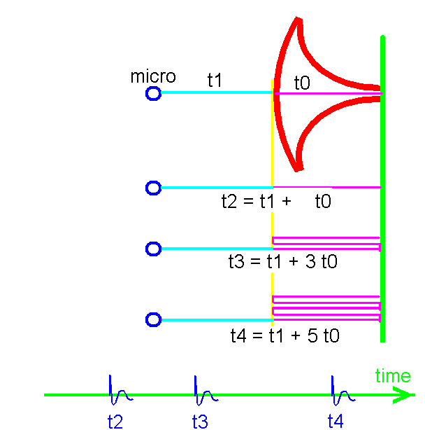

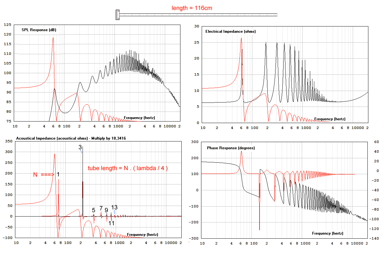

Here, in red, a measure of acoustic energy wich come back to compression driver with a tube:
The higher frequencies leave the 1" (25mm) tube (or driver) without horn and progressively without reflection.
If we close the tube, it's possible but the IR of echos turn to 180°.
Also, the menbrane of driver absorb the sound with not linearity, so the second, third... echos are not linear in frequency too.
Let's say welcome to the steps!

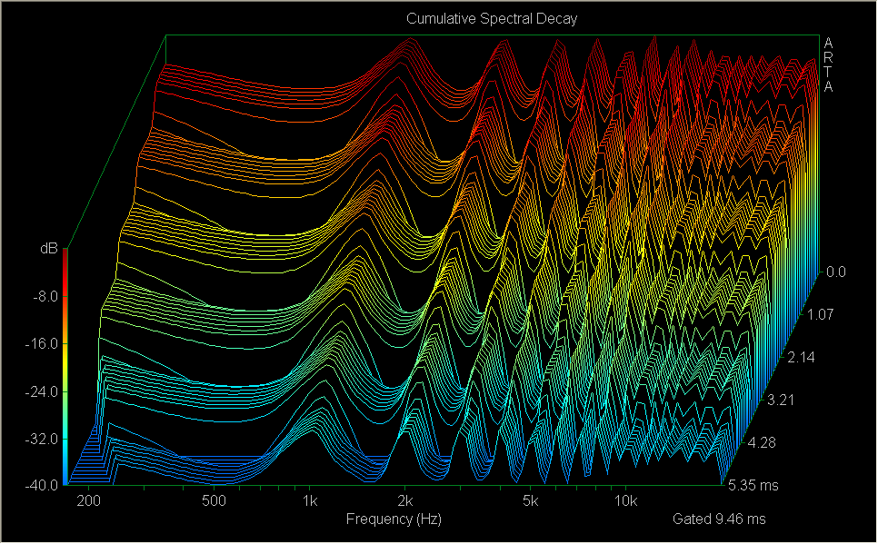

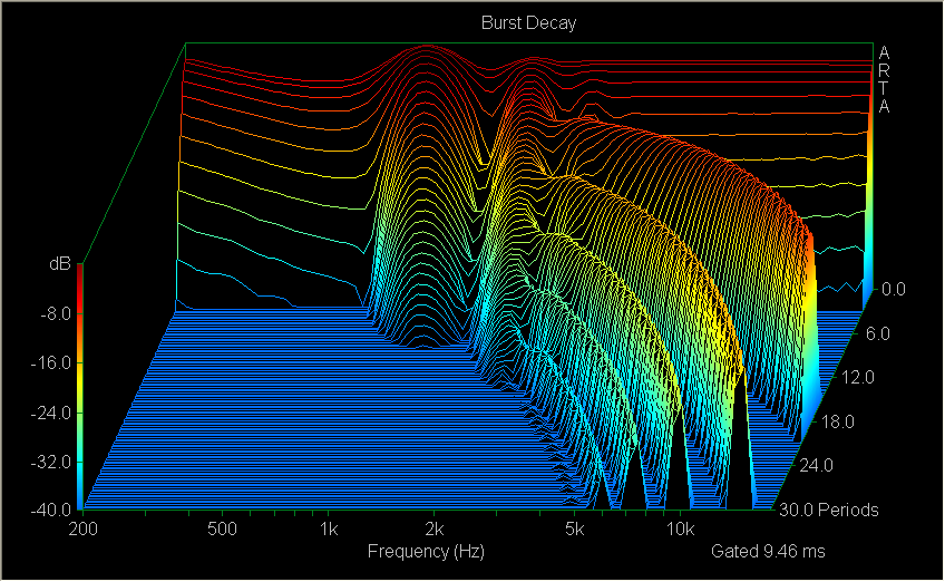

While not the best, here is a stab at the ideal reflections in ARTA.
CSD and burst (freq)

Yes, ideal as stated. Impossible.. Well, never say never 😀
Of course the point was to demonstrate the difference between the CSD and the wavelets.

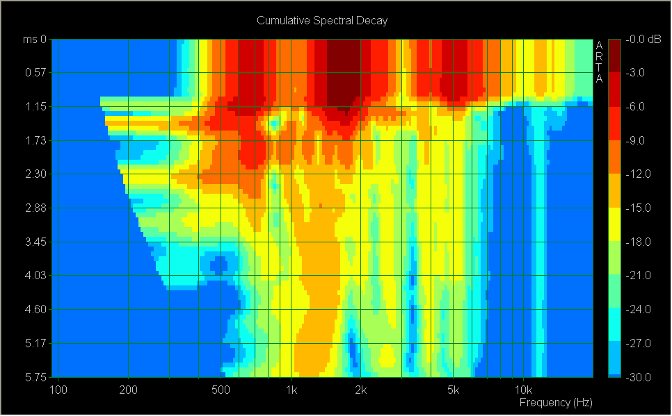

FWIW, here is the ARTA sonogram from my 811-802D measurement.
This is most interesting form me.

Hello Elias,
Reflection inside a horn induces a part of the energy of the incident (direct) wave to go back toward the diaphragm when it encounters a rapid variation in the profile or in the flare of the horn. (then the refelcted wave can also propagate toward the mouth and encounter another refelction)
In a tube the only reflector is the termination that's means the mouth.
The example I shown is for a tube having a length of 1.16meter.
As you can see on the attached file, the pulse reflections for a given distance from diaphragm to mouth are sepated by 2 times the duration of a travel throat-mouth, that means that for a 1.16 meter tube the reflection will travel 2.32m ; 4.64m, etc more distance than the direct wave that means also that they will be delayed of 6.74ms; 13,49ms...
I don't see anything unrealistic in that example!
Best regards from Paris France
Jean-Michel Le Cléac'h
Hello Jean-Michel,
Hello Thend,
Just to illustrate the possibilty for reflections to be identified on an impedance curve, here is attached, for the same 1.16meter long tube I previously took as an example, how they will be seen in the frequency domain.
Best regards from Paris, France
