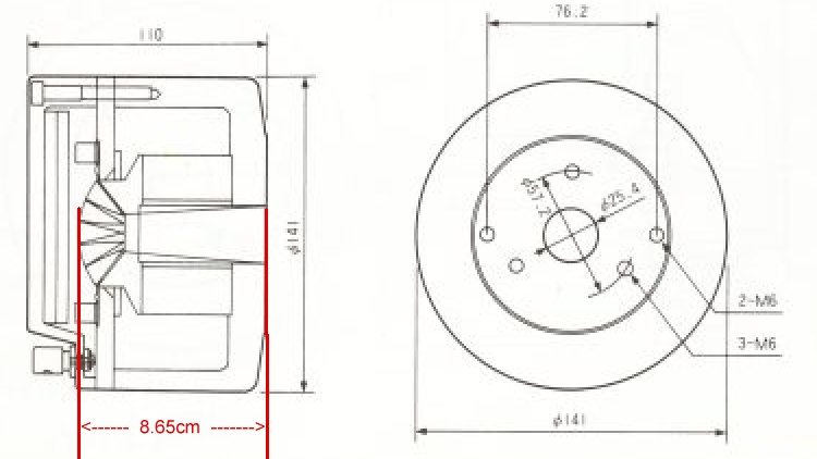

Hello Elias,
-25 dB ( = 5%) is not what can be called a strong reflection.
If the pale blue artifact you indicated at 1ms is due to a reflection this means that the reflector is at a distance of 34/2 = 17cm from the diaphragm.
This is exactly the double distance between the diaphragm of the TD2001 and the throat of the horn. This is a double refelection. (there is may be also on you wavelet graph a 0.5ms artifact corresponding to a single reflection between diaphragm and throat).
You'll find in attached file a schematic of the TD2001 showing the 8.5cm distance from diaphragm to throat.
The presence of a reflection at 1ms significates also that my measured Jerzual 321horn built by Marco Henry, is not perfectly fitted to the TD2001. The angle at throat of the horn is probably a bit different of the output angle of the driver. This can surely be improved as Martin Seddon does on its Azura Horns.
See also for that page from the TAD catalog:

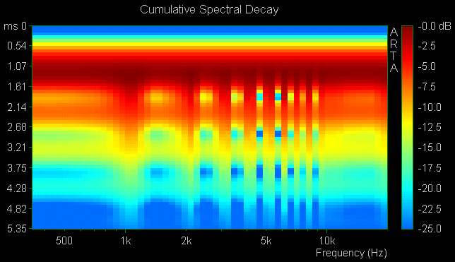

May be not the best but a normal CSD for that series of pulses separated by 1 ms will looks as in the attached graph.
As I said previously wavelets have a strong tendancy to favor the temporal aspect of the signal. (Specially with such a "thin" wavelet as you are using). Also - as it is perfectly seen in your example- we loose all temporal prcision at low frequency (we don't see anything below 1kHz in you wavelets graph).
With the CSD we can obtain a (IMHO better) balance between the temporal effect (the time series of pulses) and their comb filtering effect better illustrated in the frequency domain. Below 500Hz we can still separate the pulses...

Jean-Michel - how did you generate that sonogram?
I tried to duplicate it in ARTA, but below is as close as I got.
The amount of time before the impulse peak makes a big difference. I can't find a "right" way.
If I take the reflection file and kill all the reflections, then a sonogram shows a straight red line at the top. The thickness of the line (time) depends on where the left cursor is placed.

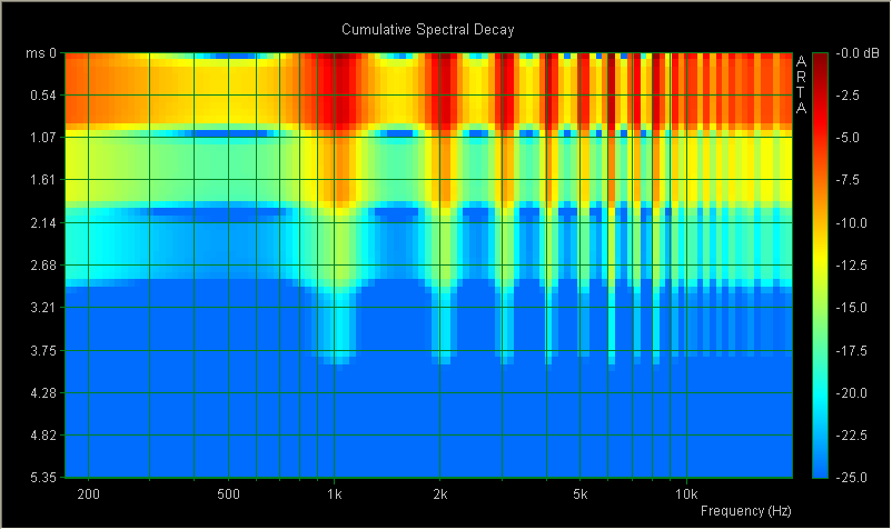

Hello Elias,

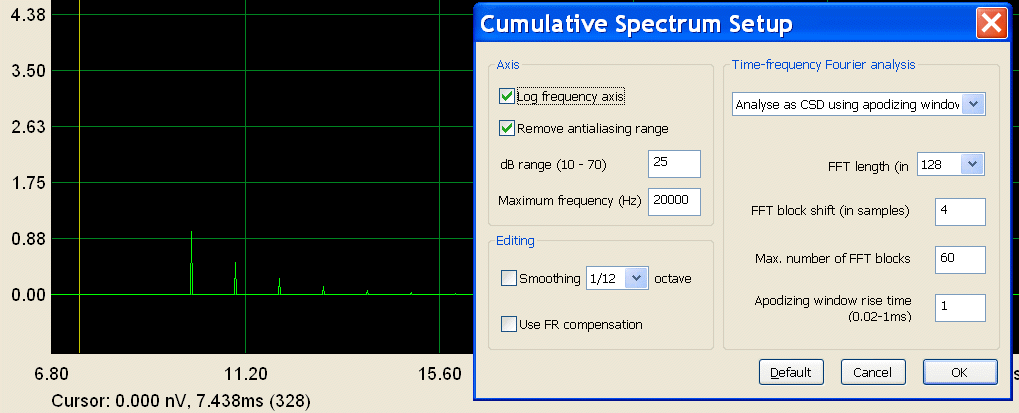

Hello Panomaniac,
Due to the length of the signal that CSD is a bit difficult to obtain.
You'll find in attached file the cursor position and the parameters I used to obtain the CSD.
Most CSD I see published on forums like DiyAudio show a time axis starting on the crest of the pulse response. I think it is more interesting to take a time origin for the CSD that allows us to analyse the rise of the pulse (as an example with certain loudspeakers we can see the high frequency starting before LF ...). That's why I like to have a blue strip on top of the CSD obtained using Arta as the one in the above link.
Best regards from Paris, France
