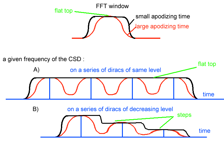

We don't need CSD in order to know how to equalize a driver+horn.
There is so many artifcats in the CSD (waterfal) you show that happy are those who can interpret it!
See the attached schematics I drawn.
On top the same FFT window with a small apodizing time (in black) and a large apodizing time (in red).
Then the 2 graphs on the bottom represent a single frequency line from a CSD., the first one on a series of equal level pulses separated by a delay equal to the width of the FFT (for an easier demonstration). The second one is for a series of decreasing level pulses. With the small value of the apodizing time we have flat tops and steps appearing, they are artifact. For sure a specialist will correctly interpret them but if we look for a definition of common requirements for CSD (or wavelets...) parametering we have to look for something more universal. As you can see the large apodizing time leads to a better representation of the phenomenon we study.
I disagree with Elias about the need to favor time over frequency. For me it is easy to ear a 1000Hz frequency but it is impossible to say "this duration is 1ms".

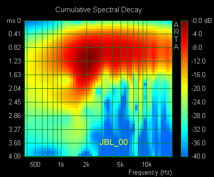

Hello,
Here is the direct link to the JBL_00.txt file mentionned by Elias:
http://www.diyaudio.com/forums/attachments/multi-way/108687d1211410404-horn-vs-waveguide-jbl_00.txt
Here is attached the CSD I obtained using ARTA. (really ugly!)
Best regards from Paris, France
Jean-Michel Le Cléac'h

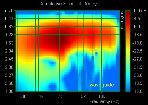

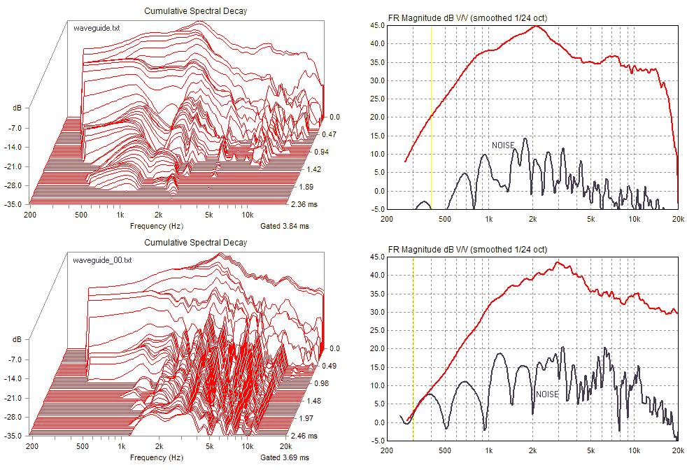

Hello,
Here is attached the CSDs of the waveguide_00.txt file (left) and of the waveguide.txt file (right) I obtained using ARTA.
Direct link to file waveguide_00.txt is:
http://www.diyaudio.com/forums/atta...1211410323-horn-vs-waveguide-waveguide_00.txt

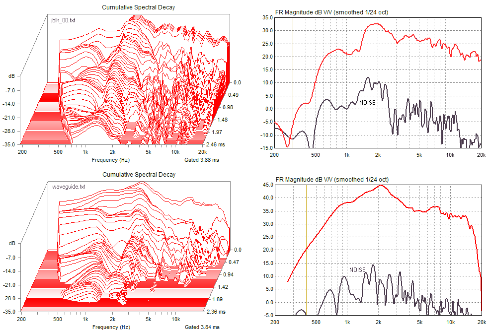

I should mention the analysis done by Melavi on the JBL and Waveguide files previously mentionned.
http://www.diyaudio.com/forums/multi-way/123426-horn-vs-waveguide-21.html#post1518695
and the one performed by Jzagaja:
http://www.diyaudio.com/forums/atta...1617551-horn-vs-waveguide-untitled-1-copy.gif
http://www.diyaudio.com/forums/atta...1577371-horn-vs-waveguide-untitled-1-copy.gif
