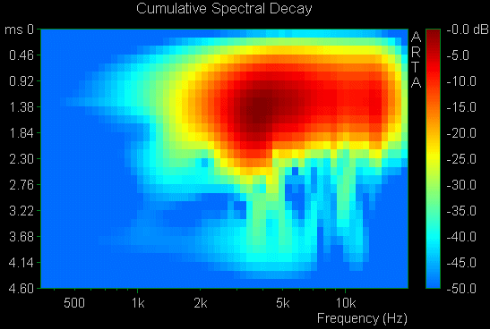

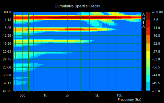

When generating graphs like these it is easy to get different looking results from the same file. Using ARTA, for example, I can even get upside down results depending on where the cursors are set. See the 2 CSDs below of the same impulse. (700Hz, 2nd, L-R, high pass).
And with same info the graphs look different using different scales. The same problem exists for all graphs. Advertisers use this to great advantage.
A CSD of sonogram on a 15dB scale looks much different then on a 40dB scale.
So. We should standardize, at least in this thread. I suggest we use.
  • 40dB scale. This shows deep enough without missing anything important.
  • We decide how far (in milliseconds) before and after the impulse peak to set the gate or cursors.
  • I suggest 1mS before and 5mS after. But am open to suggestions.
  • Other parameters should be set, such as window type, FFT, ect.
I'm open for suggestions. If we are all doing graphs in the same software(s) we should at least all be doing them the same.
