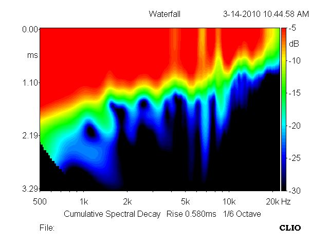

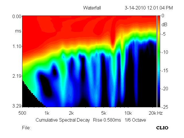

Michael said:Something additional that sticks out is that the ripples in FR do not match that well the ripples in CSD later on in time – same behaviour also to be seen in your "normalized" plot:
How did you actually perform above "normalization" ?
- Those two plots were created by Zilch .
- You're right . The time decay smears don't track the FR that closely leading me to suspect reasons other than the driver ( horn ? , maybe the normalization process within CLIO ?, noise ? ) .
- I believe the "Normilization" in CLIO is created simply by selecting it as an option before producing the CSD / but / since I don't have CLIO, I'm just guessing .
Are you talking Normalized to the 0db reference point?? If you are CLIO does that automatically. It takes the highest SPL point of the FR curve and Normalizes to that point. You can also manualy change the level in 5db steps up or down. Attached are the original load and the second with the reference point shifted up 5db. Look at the side scales

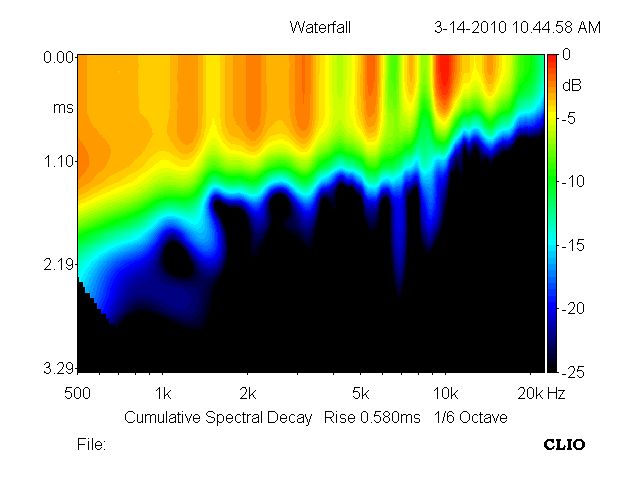

Rob, thanks for shading some light on Clio software, but the normalisation I'm after is not the way you show (auto-scaling).
What would be handy, is a normalization to 0dB at 0ms for *all* frequencies - thus leaving to be displayed *only* differences in decay.
Seems Zilch has done so – at least at 0ms there is the same SPL-color all the way
Michael
Oh I understand. There is a Reference Button that you can activate that will do that normalization.
Rob🙂

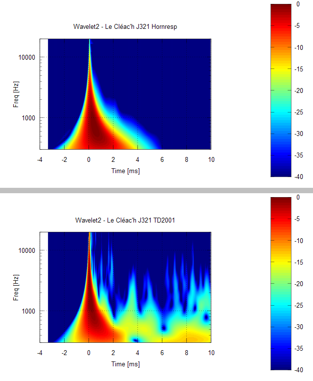

Hello Jean-Michel,
Here's the wavelet transforms for your horn, first the Hornresp simulated impulse response and second the one with TAD driver.
The Hornresp seemingly can predict the group delay quite correctly. But of course it does not give any indication of the horn internal/mouth diffraction/reflections, which are evident in the real measurement.
- Elias
- Elias
You should compare with the theorical pulse response as calculated by Hornresp (here attached)
You'll find in attached file (in text format) as .wav (48kHz, 16 bits) the impulse reponse I measured on one of my horns (Fc = 320Hz, T = 0.707). The driver is the TAD TD2001.
