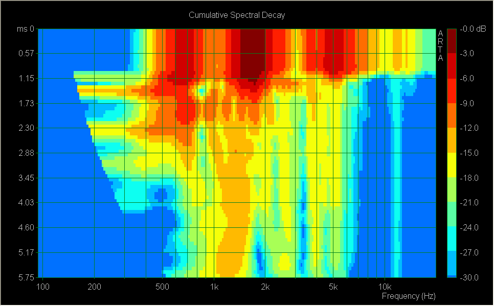

Hi, Earl!
That may be the only time I've ever done a normalized CSD; it certainly lights up the resonances.
It's to the point now that I don't remember having done any of that.
[Good thing I post everything as it happens.... 😉 ]

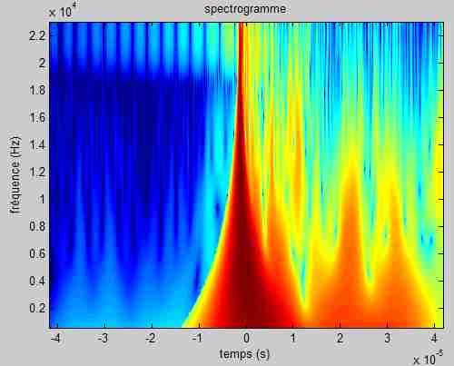

Hello Elias,
Here is, for the same IR pulse of the 320Hz Le Cléac'h horn, the output of my own piece of spectrogram I wrote many years ago (under Matlab).
Strangely I find this presentation less useful than CSD... so I never completed it (the vertical scale is not correctly labelled) and I never used it.

Hello Jean-Michel,
I agree, the way you plot the data is not useful. Mostly what is visible in your plot are non-idealities of your impulse response measurement system! They don't belong to the behaviour of the horn itself, and are only masking the real horn behaviour to be seen by the human eye.
What is the dynamic range of the plot? 80dB?
One needs to adjust the plot to see the phenomena one is looking for. The data is there, in the impulse response, only it's needed to adjust the 'magnifier' to make it visible.

Rudimentary, at best.How was measurement setup?
I was trying to see which rang worse, 811 or 511.
811 sounds harsh to me, whereas 511, despite ringing like a bell, has a rather pleasant "woody" coloration to it, in my view.
Don't know if that's meaningful to anyone, but 511 IS well-suited to hanging on the porch of the ranch house.... 😀
- Because I live in an apartment & measure this stuff in place , I typically measure at a distance of less than 1/2 a meter .
- It might be ambient noise, hard to know . I consistantly get something ( resonances ) appearing at minus 20 db & lower ( so does Zilch in most of his CSDs , btw ) .
- I pointed out his 811b CSD ( seen above ) because that normalized plot shows a lot of energy just 10 db below the fundamental response .
- When Zilch changed drivers on the 811b ( from Altec to Selenium ) the "ringing" drops to 20 db below ( see above ) .
- The swap suggests the driver ( Altec 902-8B ) is responsible for the excessive ringing ___except___ that ( to my satisfaction ) I showed that other Altec drivers on different horns are at the expected 20 db down point ( for resonances ) . See below :
- The apparent paradox ( the source for the extra 10 db of ringing ) has never been resolved ( which is why I'd like to see some data from Pano ) .
- Here's the horn that I measured the Altec and B&C drivers on ( seen above / this one belongs to Zilch ) .
- Because ARTA doesn't have a normalize ( first ) function for the CSDs , I typically build up a passive filter to flatten the response as best as I can .
- So, as much as, 5 Ms long / 20 db down, is loooong ?
<> cheers 🙂
Michael said:How was measurement setup ?
Michael said:Does not look like a usual horn or quarter wave behaviour to me - any conclusions or theories ? - maybe material resonance (the metal bars ?) of the horn contour?
Michael said:impressive plots - but how you think these loooooong decays - in steps even - come from?
Also those resonances are veeery close to each other ??
<> cheers 🙂

IMO this is exactly the same behaviour as you (and Pano) measured – decay in *discrete steps*.
This isn't a "normal" decay, I'd say – but have looked at it (until now) only as a curiosity I once came across.
Might be – in the scope of this thread - we should pay some more attention to this and aim for an explanation ?
Hope wavelet analysis of Panos measurements puts some additional light on that...
