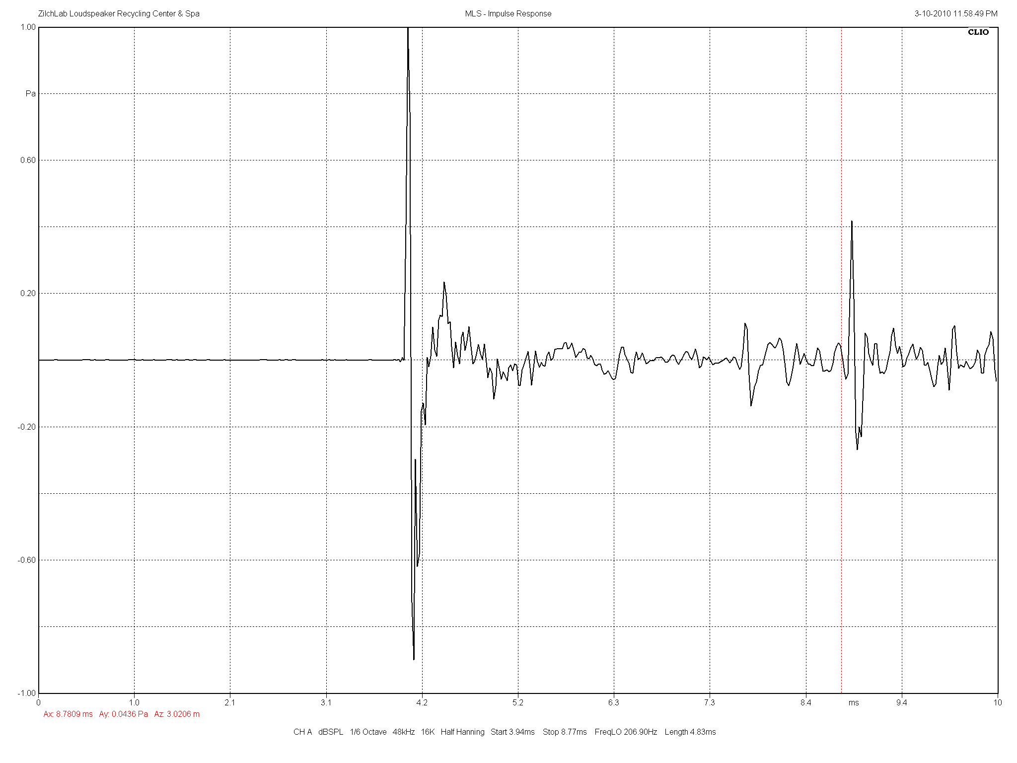

Seems I can't export the impulse from CLIO, but here's the response data and impulse graphic for the same QSC waveguide with DE250:
The pulses at 6.3 and 7.5 look interesting.🙂Seems I can't export the impulse from CLIO, but here's the response data and impulse graphic for the same QSC waveguide with DE250:

How about the bifurcation at 4.1?The pulses at 6.3 and 7.5 look interesting.🙂
