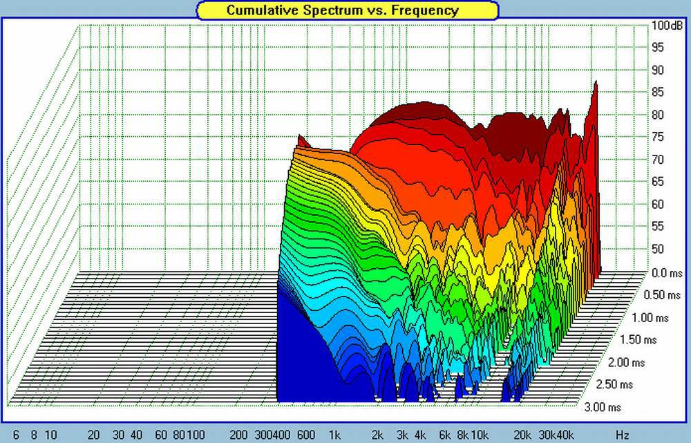

Hello Michael,
here attached are the CSD obtained with the PIR files you sent me.
height of every individual CSD is 3.3 milliseconds
(Butt 18dB omitted due to limited dimensions of graphs imported in the DiyAudio forum )
Best regards from Paris, France
Jean-Michel Le Cléac'h
I show cumulative spectrum decay in the common form and also in its sonogram variant.

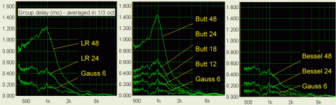

Hello Michael,
You'll find in the attached file the group delay curves I obtained using Arta on the same files as you analyzed in the message:
http://www.diyaudio.com/forums/multi-way/161627-horn-honk-wanted-7.html#post2111876
jean-Michel Le Cléac'h

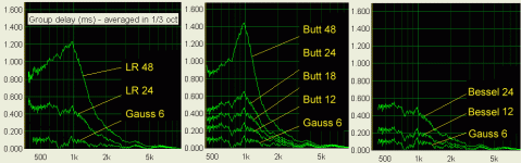

Hello,
in the legend of the GD curves (right window) , please replace:
Bessel 24 by Bessel 12
Bessel 48 by Bessel 24
(corrected graph attached)

Hello Doug20,
For what its worth: here attached a graph with frequency response, group delay curve and CSD obtained using ARTA on your wave file.

What does the Group Delay of various filter slopes have to do with horn honk?
Rob🙂
Its an equivalent to the shift of "virtual point of origin" happening due to cut off and thus prepares for a basic feeling what's actually happening here.
Jean-Michel brought GD issue of horns up, way back - and I too relate the guttural sound of horns to GD.
Its just part of the juicy horn honk story though...
Michael
Thanks, looks like we should crossover higher then 2K.
Possibly true, but it isn't because of the waveguide. 😉
The driver itself is primarily to blame because of it's high "q" resonance, NOT the waveguide.
Almost all of the delay is from the crossovers. So it's the crossovers or the horns?? That delay would be there for cone drivers as well so again I don't get the significance as it relates to horn honk.
To avoid the "worst" GD from the horn all you have to do is go up an octave with your crossovers but the crossver is going to add more Group delay than the horn has. The GD is certainly not an issue with the horn in that case.
Rob🙂
