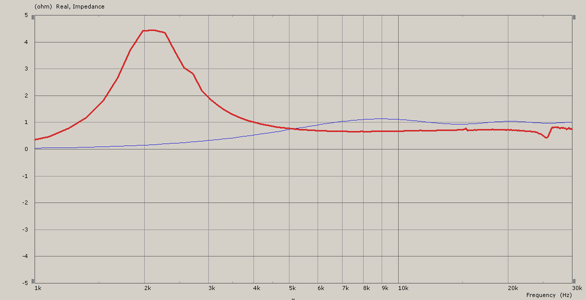

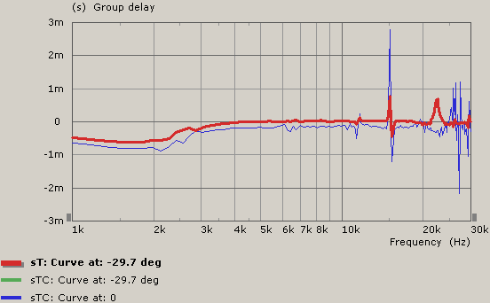

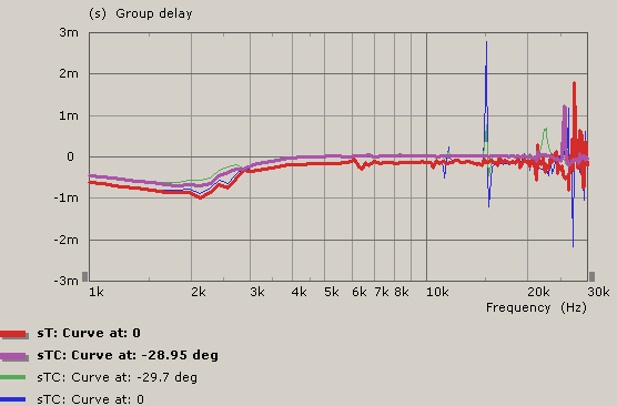

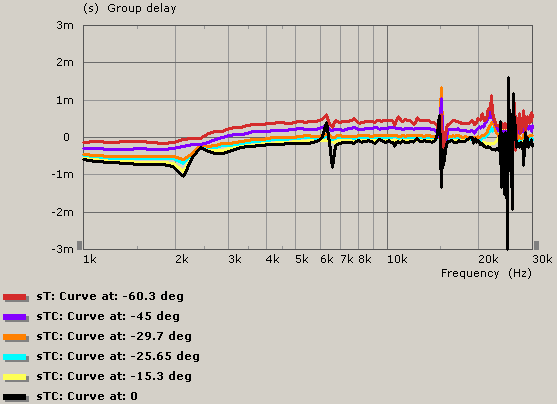

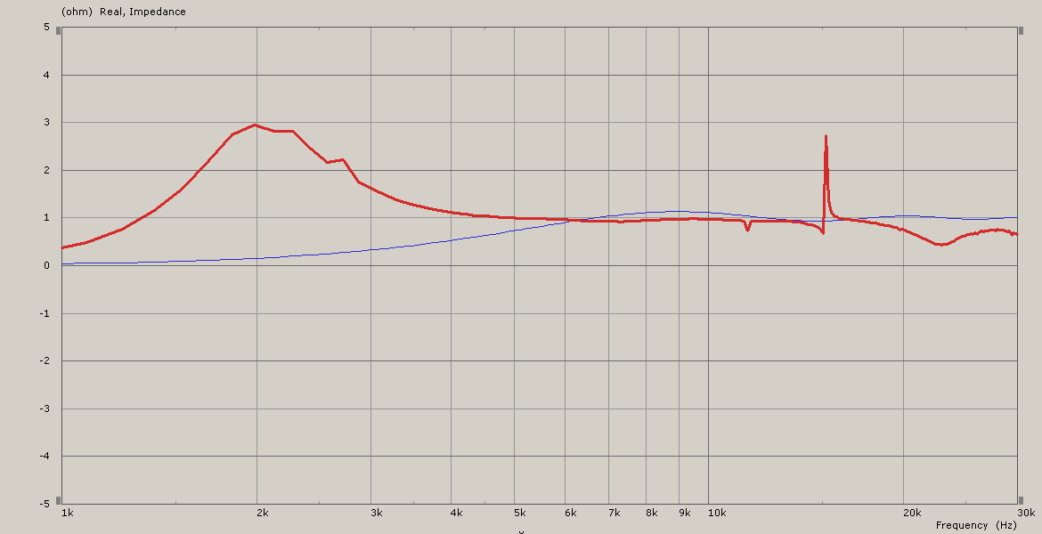

Hello Jean-Michel,
But there seems to be some relation between group delay and acoustic impedance. I wonder whether anyone has explored this mathematically?
This is an interesting example where group delay is closer to zero at a specific off-axis location.
Also shown is acoustic impedance.
Hello Soongsc,
In a first time if I were you, I would not care about the non zero group delay at high frequency.
This non zero value is generally due to to a bad estimation of the mean "travelling time" of the wave. The error thus created by the bad compensation of the mean travelling time during phase compensation and unwrapping is then reflected as a constant error added to the GD at every frequency.
If the derivation of the phase (versus pulsation ) is correctly done (this means also that the unwrapping of the phase is correctly done...), what is more important than the absolute values of GD is the difference between the GD at 2 frequencies.
For myself I find more convenient also to express the GD as its equivalent distance travelled at the speed of sound (c = 344m/s).

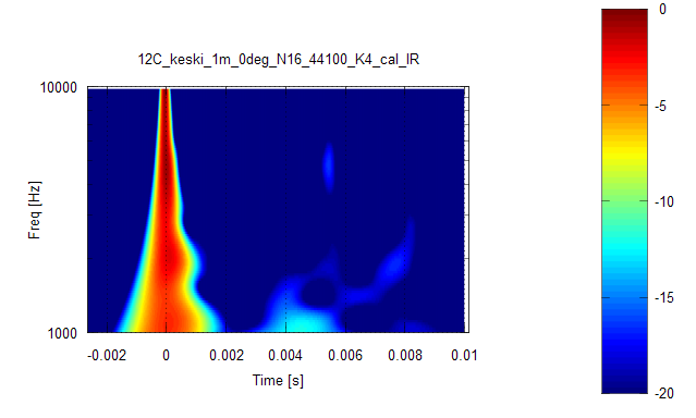

Hello Jean-Michel,
I am interested how group delay varies with angle.
Had some time to do home work
Here are how high pass filters perform.
Instead of group delay, I show cumulative spectrum decay in the common form and also in its sonogram variant.
This to me – is in a first step - more intuitively to grasp as a difference in behaviour though I do not forget about GD at all.
The idea behind is that we might be as sensible to shift of origin from GD as we are possibly for a long decay in the time domain.
I know, electrically this is quasi "one and the same" or maybe better put "two sides of the same coin" but nevertheless I would like to bring in this additional aspect .
Basically the following plots show my measurements of all filters available from DCX at 1kHz - in lack of a versitale analog filter source.
All plots are what the text says, starting out with Gaussian 6dB over Bessel Butterworth and Linkwitz Riley up to 48dB
Sadly we do not have Chebyshev filters with DCX 🙁
We clearly see that there is a huge difference in the time domain regarding decay at HP (XO) frequency.
The sharper and the steeper the HP filter is chosen the more pronounced and prolonged is decay time.
If we now look at the cut off of a horn with an XO set ~1 octave higher – it might be obvious that this "ringing" still will be audible and contribute to horn honk as its by no way compensated by a mating low pass (as is in XO application) – what you think ?

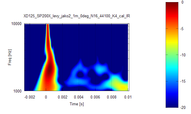

Hello everyone,
Some measurement on the group delay issue. Here's a 18sound horn XD125 crossed at 2kHz to 8" driver with 2nd order LR filter.
Picture is a wavelet transform of the impulse response, showing the 'burst envelope' at the given frequency as a function of time.
One can clearly see the heavy twist between 2-4kHz. Notice that only part of the group delay is coming from the cross over filter - The horn itself has a non constant group delay! (I couldn't find measurement of the horn alone.. have to look for it and post later).
- Elias

Hello Elias,
You example is typical of
1) the choice of a too much low -3dB frequency for the high pass filter
2) the choice of a crossover having quite large phase distortion
Things may be improved a lot if:
a) we choose an -3dB frequency of the high pass filter one octave above the acoustical cut-off of the horn.
b) we choose a crossover having a lower phase distortion (by example a Le Cléac'h quasioptimal crossover).
Best regards from Paris, France
Jean-Michel Le Cléac'h
