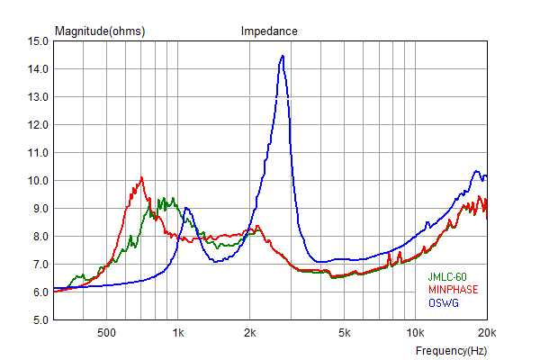

Ahh - uumpf - grrr - huuu - GOT IT !
- and the light blue for sure is a OSWG for reference - where did I have my thoughts...
These are beautiful graphs!
The very narrow peak in blue is likely a diaphragm resonance or other resonance within the driver. With such a high Q that is about the only choice.

I really can't remember which is which at the moment. But you know, I would try and go for flat acoustic impedance as possible while trying to maintain a certain level of directivity control. I won't focus on the narrow dips and peaks at the moment.Ahh - uumpf - grrr - huuu - GOT IT !
These are simus !
Ok.
- the dark blue and is one of your earlier works with the wiggle in the 15kHz range

Regarding the flat response you posted somewhere, it's possible the acoustic impedance becomes higher in the upper frequency range. My sims show this trend.
Any of the traces in the plots that refer to this trend you noticed ?

The one that I recall having 3db slope had an acoustic impedance hump between 5K~10K

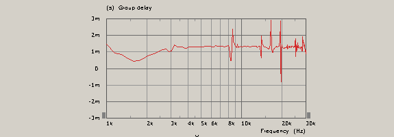

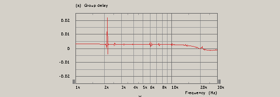

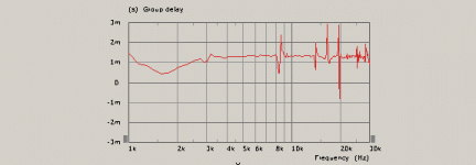

I am interested in what anyone would have to say about these group delays from AxiDriver. Can there really be such difference in reality?
That first one looks like a strong resonance about 2.2K so the delay is not determined well.
The second one is the classic flip (invert) phase between 8k and 9k and again about 14kHz and then the group delay measurement shows in and out of phase with increasing frequency.
That first one is 4ms and the second one about 1.3ms.
My BIG question is how this was measured and the "theory" behind the measurement? In most horns the apparent source moves in or out of the throat with changes in frequency. I really suspect this measurement is somewhat erroneous as the lines are to flat except for the areas of wide variation. Were these measurements only the compression driver without the horn?
These are BEA based simulations using AxiDriver. Currently, I ignor the spikes, but I am wondering about the overall value and it's trend.

On the left one the highest frequencies arrive earlier than the low frequency which is quite normal. The relative group delay of the low frequencies versus the high frequencies (4 milliseconds) is equivalent to a backward displacement of 1,4meter (which is a large value).
About the right one it looks strange to me and doubtful.

I have not checked for BEM and GD until now, but think it is not correct - at least in the plots presented
The left plot would have to be a horn with extreme high cut off frequency and even then I doubt the negative values past 20k could be any correct ??

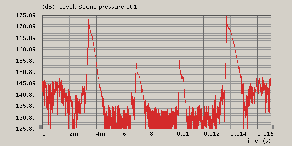

It seems this is a good point. Looking at energy time plots do show some funny echo. The spacing between the echos is the multiple of the first delay time.For me there is no doubt, it's the multi echo between mouth and driver (Acoustical tube) which gives the impression that it is far sound source (temporal sum of back and forth).
