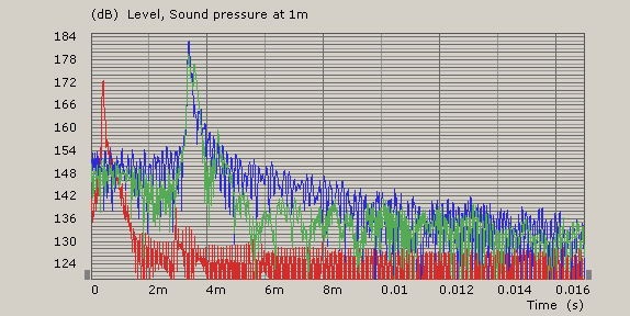

Interesting ETC comparison between 90deg OS (no lip rounding), other configuration, and direct radiating driver.
It seems OS is closest to direct radiating driver in the ETC. However, the acoustic loading would be less than ideal. I assume the foam that Earl uses will improve the loading. Now I am more interested in listening to the Summa's.
