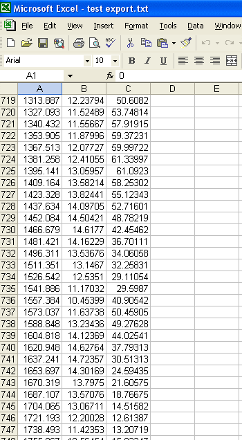

- Open FR text in Excel. You have 3 columns. Frequency, amplitude, phase. It's the amplitude that's the trouble.

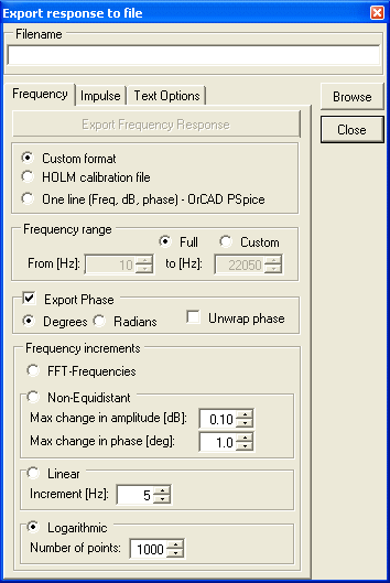

HOLM is normalized to 0dB. I have not seen a way to normalize the FR text file when exporting. Doing that would save a ton of work.

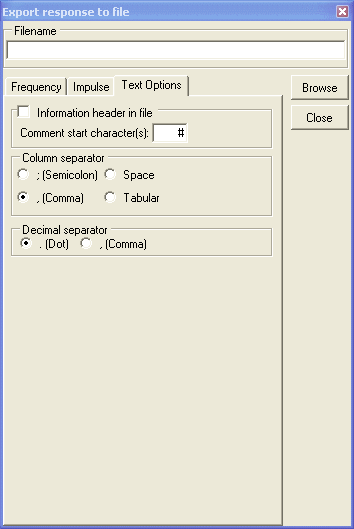

Below are the export settings I use. If you are getting it all in one row in Excel, you probably are not choosing the right "delimiters" when you import the file into Excel.

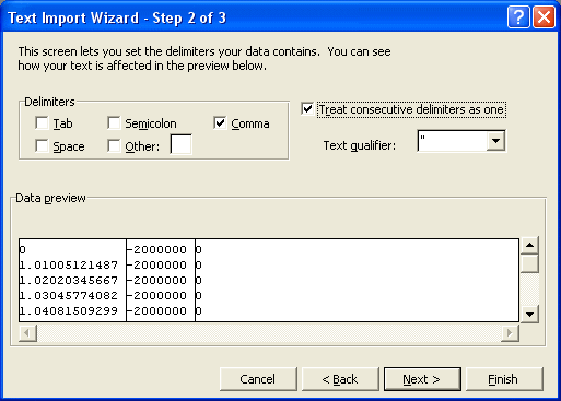

Thanks Pano!! I was just going to post that I figured it out myself, at least the columns thing anyway. You are right, it was a "delimiters" thing. I was just right clicking on the file and then "open with" Excel. I figured out the "delimiters" thing by opening it from Excel.

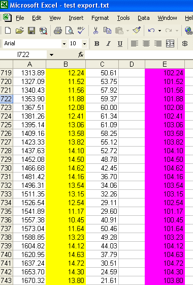

Here are the import settings I use in Excel along with what it looks like once it gets there. Also shown are the columns formatted to 2 decimal places and column E that has the +90 formula in it.
The reason to save the file (CSV format) and then reopen is that in the CSV format the formula gets lost, and just the +90 values in column E remain. Now that can replace the HOLM amplitudes of column B.
If you were to try to copy column E before saving and reopening, you'd be copying the formula, not the values.

And shots of what it looks like in Excel.
After saving and reopening, column B is cleared, then E is cut and pasted in its place.
