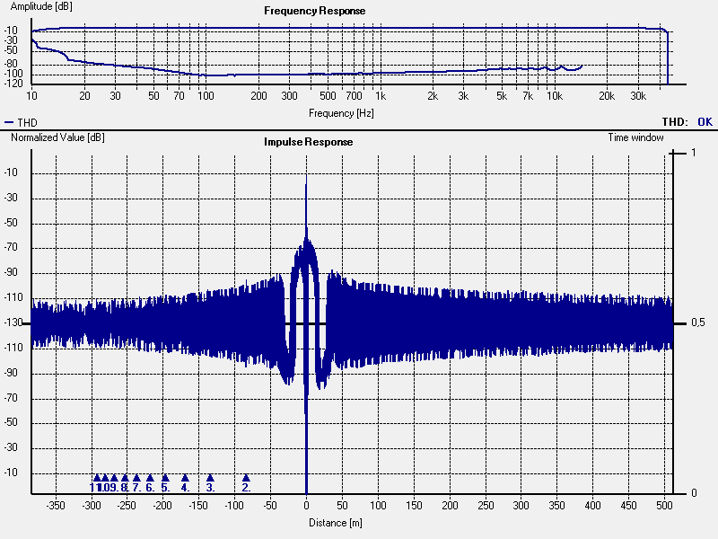

Can you attach or sent the measurement file where you have measured the distortion, then I can see what is going on ?
Hello Ask,
I did not have the original file any more, but I made I new one (results are consistent).
Did you read my post in 580 (fade-in time)? Could it be that this is causing the problem?
Greetz,
Wim
Hello Ask,
Greetz,
Wim
No it's not the fade in-time - it is the algorithm which I use to calculate THD from the log-sweep impulse response.
See the attachment with the impulse zoomed out and on a dB scale - No Harmonic pre-impulse can be seen
From my point of view the harmonic distortion does not make sense if the noise floor is greater than the harmonics
But HOLMImpulse is misleading here... I agree and want to do better
