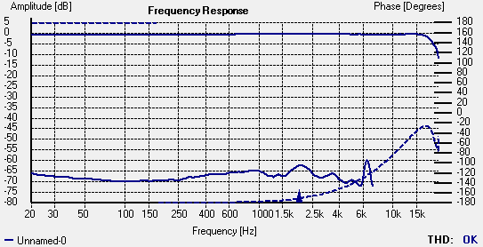

I decided to test my soundcard, since I don't have my mics or speakers here. It's evidently not great! Creative Audigy thing. It'll work for frequency response measuring though, which is really what I need 🙂
Your soundcard is out of phase with itself. Check of the "Invert recorded signal" under device settings. At the impulse response it is very clear that the impulse is going down instead of up.

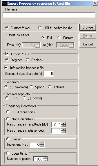

Can the impulse response be written out to be read by another program? What about OLE?
The measurements can be exported to text file in custom format (See attachment)
OLE - No.
