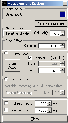

- The Impulse is inverted - Try "Invert recorded signal" under device settings or the "Invert Amplitude" button under "Options" for each measurement
- What about the timewindow? Also under the options menu for each measurement - try the autodetect (This is done automatically when you measure)
- If you want the total response the choose a smoothing 1/N Octave filter (Also under options)
