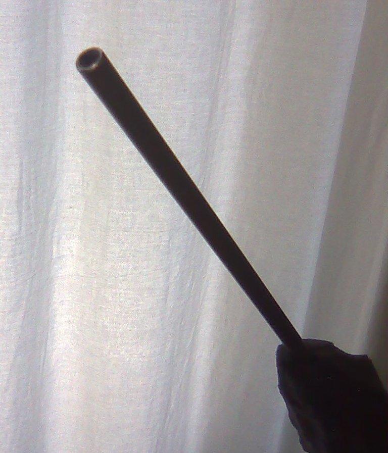

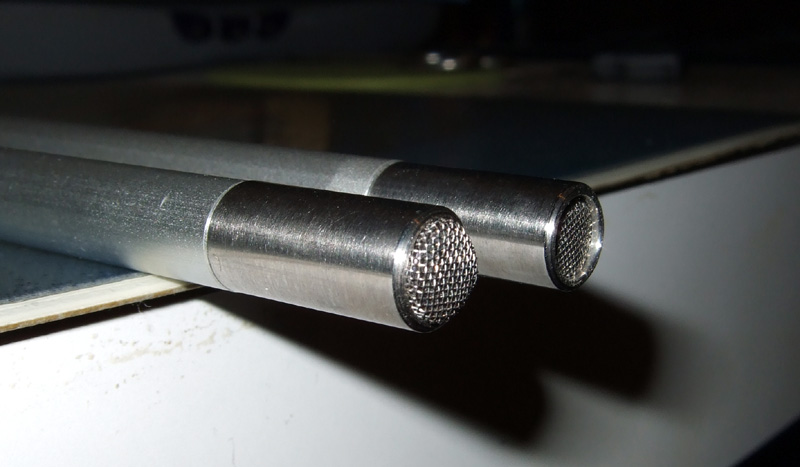

On what assembly have you measured the Panasonic capsules? Were they inset on the end of some tube? They normally gain 4dB up to 20kHz if there is a lip around their edge due to diffraction.

WM61A capsules
Attached picture shows the mounting in an alu-tube (Stuffed with damping materiel)
as I seen in
http://www.diyaudio.com/forums/showthread.php?postid=1841507#post1841507
I also get 4-5dB gain at 20kHz (The base level at the graphs is at -4dB) , but it drops again at 20kHz and upwards

Re: WM61A capsules
Totally normal. I just wanted to compare some ballpark data for 20k to 40k, and your construction follows one or two of my mics.
If the capsule is made to protrude, the diffraction is roughly half, so its the rise, maybe better for high frequency impulse measurement. But if it drops on the floor, its history. See pic. On the left protruding, on the right inset.
