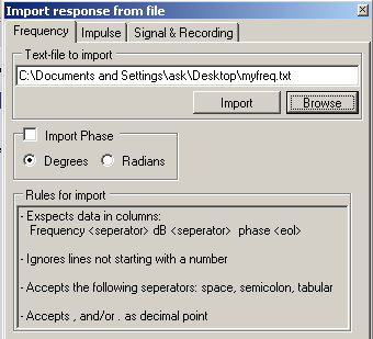

Importing / Exporting FR
Section "3.1 Importing a frequency response"
No not yet...
No it's not a problem - You can import the amplitude only - see the now updated User Guide v0.0.7How can I import a FR curve? is there documentation of the proper format? After smoothing the FR curve is purely real there is no phase. Is this a problem?
If I smooth in Holm, can those curves be exported en-mass like the IRs?
No not yet...
