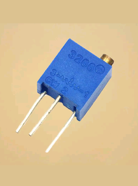

So basically this is what I need but adjustable to 1k. Although as mentioned it has three legs? Would I have to be I solder one of that legs to another? Or just use two of them.
The kit came with the board and components, would've it been better to supply R2&R3 with adjustable trim pots? Unless it's pre set to use on 12v rail voltage. Mine measures 17.2v without load, I'll have to check it with some load.
Bend the one in the middle to one at the side and solder it together. Like that the trimmer size roughly will be the same as a resistor and will feet nicely. :nod::nod: Set up a 550R bot and replace the two 1K resistors. and from there you can adjust to the req. value.:) Make sure after 30 min. warm up readjust and again later when 100% warmed up. Good luck with your project. I hope you like the sound. :)

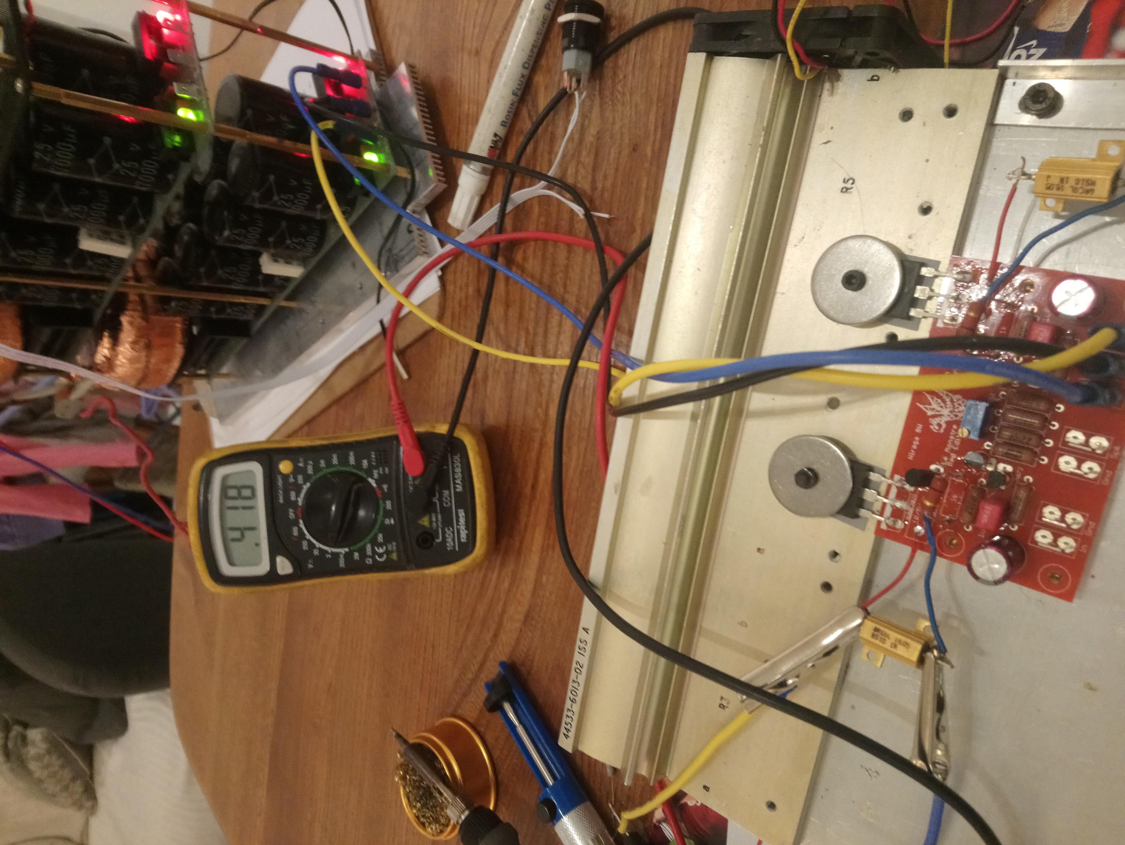

ok so used 100R to replace R2 and R3. I tried 500R but the voltage was 2.3V. With 100R the voltage started at 0.418V, after about 1 hour it stayed at a steady 0.635V and the heatsinks and resistors werent at boiling temperature, warm to the touch!
I have one worry though, i thought i would connect my DMM to the speaker output and measure the any voltage, bloody thing is measuring over 14V :confused: that doesn't seem like a good thing??? Another thing i noticed was one of the transistors is hot where as the other one isn't. I mean one transistor is much warmer then the other, it almost feels like one is not working?
Very likely that transistor is fried, dead from the previous tests. :eek:

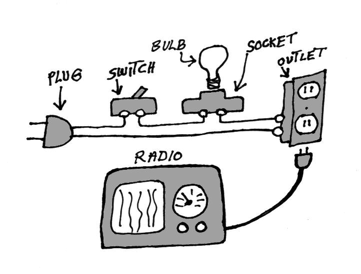

Next time when you start up an amplifier using a protection like this.
If the light bulb glows that mean something wrong, I would use a 50W light bulb at the start. Please use normal light bulb (the good old regular bulb)
I also like to connect the DMM between the positive rail voltage and the amp circuit board measuring A.
That case when you power up your amp you can see it right away your PC board draws a tremendous amount of power and you can shut it off much faster. Second reason at this low rail voltage you will get much precise bias measurement.:)

Is the offset measured from the speaker output? Is that with a speaker connected? And also is it when the amplifier bias is set and warmed up.
If you want to fry your speaker caused by massive DC at the output before adjustment you're welcome to connect your speaker before doing that :rolleyes:.
No, really. The offset have to be adjusted before (!) you connect any speaker to it.

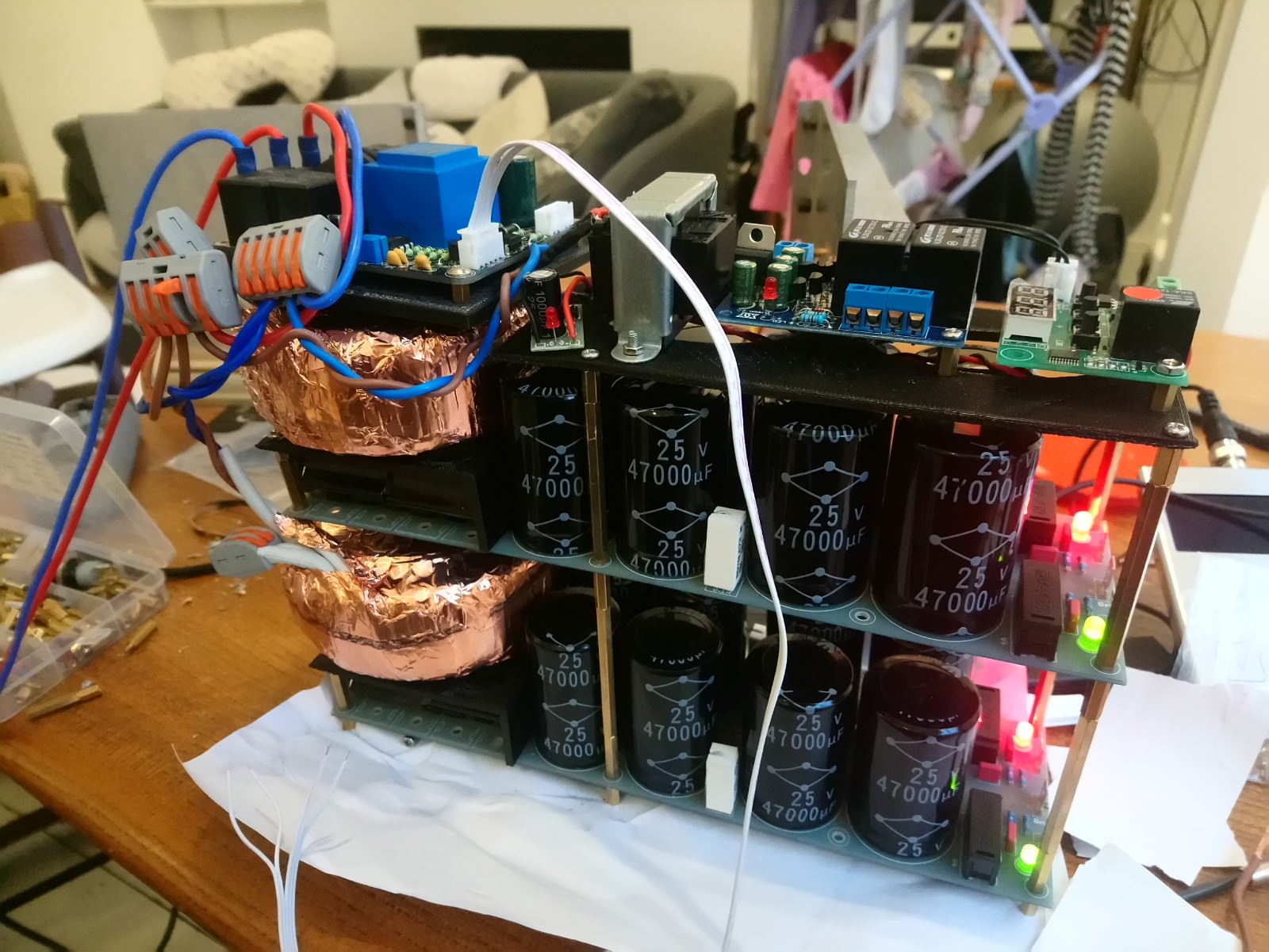

Nothing to do with your current fault, but noticed you have wrapped your transformers in copper foil? Is there a reason for this?
Not sure if it is a good idea, as it is really easy to create a 'shorted turn' on a toroid if the mounting bolt touches both sides of the foil at the same time... It will try to melt the foil and then melt the transformer windings - be careful.

Hi Alan, well I thought I would try some emf screening, so I used copper foil tape just to cover the transformers. I actually just covered the sides and top making sure nothing was touching or shortening out. Also used rubber between the mountings. Just thought I'd try it but since you're concerned I will double check that, aside from blowing transistors I dont really want to melt any transformers.
