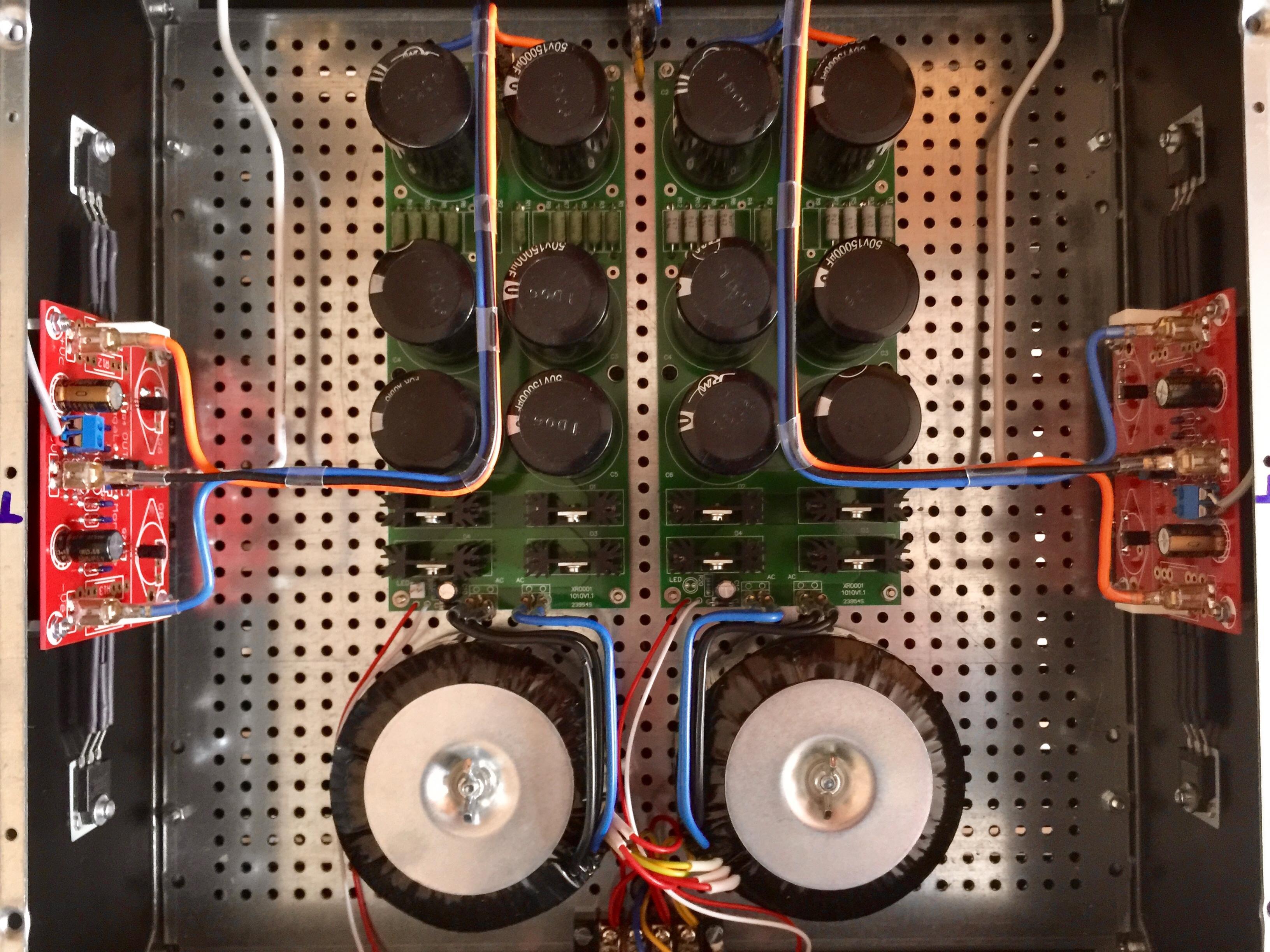

Thank you Vishalk. The PS boards are from Prasi with 6 x 33,000uf caps but no chokes. I'm in the process of a JLH1969 and have an F5 so can do comparisons using Altec 604's. The Le Monstre is already a winner in my mind, its just incredibly open clean and wide, but time will tell! If you're ever in Ireland you are more than welcome to see and audition them.
That is a very neat job aubmar, i like that! Can't wait to finish mine. @rhr9 are those chokes you have used on your PSU?
Yes, between the capacitors : C L CC

Im appreciate a lot you design and your wish to build something different but in this design I see something what I do not like.
1. If you want to build hifi audio amp than try to avoid active coolers.
2. connection between boards is not good and it is very easy to break specially when you have heavy transformer on it
3. there is reason why many producers trying to make enough distance between transformer and rest of the components... and I do not mean on heat only...
I hardly suggest , if you want hifi build , to reconsider about place of the boards and transformers...

Do you mean the use of fans? I added them as a test and just incase they are needed, the heatsinks are avionic sinks and originally needed a active cooler for them to work efficiently
No chance igor, these are supported by 3D printed structures and metal standoffs, it allows the cables to be short and nothing moves, it's solid as. The weight distribution is straight through and the boards are not supporting it at all (maybe a little but nothing to worry about)
Yea magnetic fields, EMF, cross talk etc etc, have yet to finish but i will be implementing some EMF materials and screens

On a side note: The PS boards appear to be different than the ones I supplied.
oops! Quite right Prasi, my sincere apologies, these were boards from Jims Audio on Ebay, and have 15k caps fitted, so 90k per channel. At some stage I will fit a pair of your PS boards, actually I have them ready to fit but I enjoy the music from the amp almost every day so will wait until I have a replacement. I have an F5 with your PS's and all good components but can't get rid of the hum, and I know its not the PS's as I wired them into another amp and they are extremely quiet.
Vishal: There are only Resistors between the caps, I don't really know enough to start using chokes!

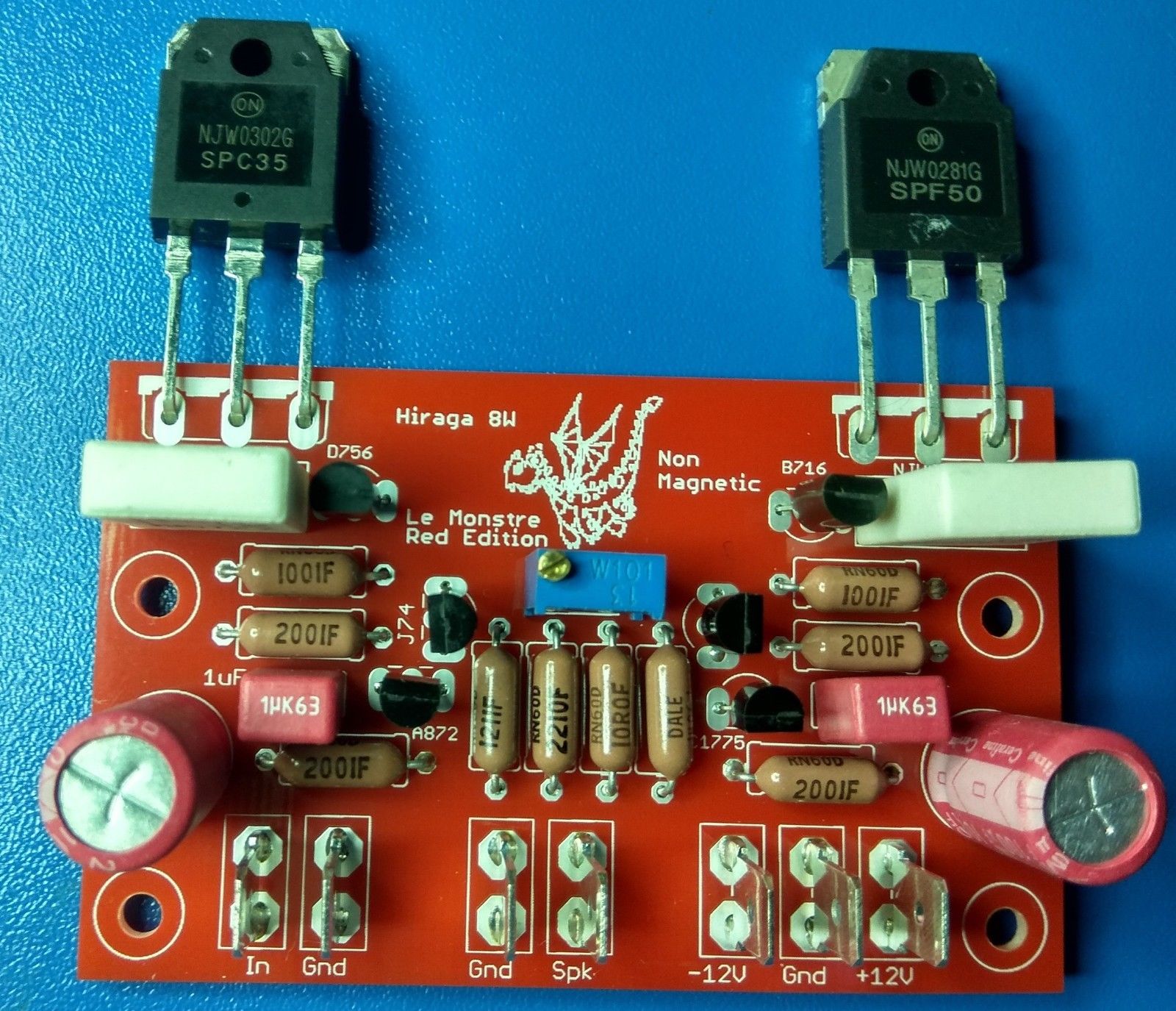

Guys i got it all wired up and ready to test. Now this is where i have difficulty is setting the bias.
How does one go about this from the beginning! I attached a voltmeter across the 1r resistor and switched it on. The voltage shot to 4.7v, this is where i quickly switched it off.
I turned the adjustment pot (rectangular blue resistor thing) but it made no difference? What am i doing wrong or what am i not doing right?
Ok so what do i have to do? Clearly 4.7v is to high. My PSU is giving out 17.2V without load.
I'm just not clued up about offset and bias adjustment. I thought i measure across the 1R resistor which gives me my bias?
How do i change the bias value if i need to?
arrrggghh i tried sourcing information on this but to no avail.
4.7V across 1R gives 4.7amps of bias, way too much.

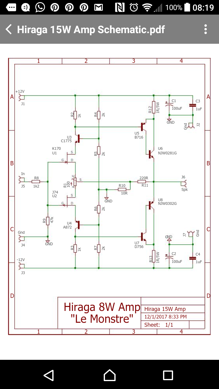

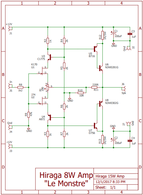

Can you replace R2 and R3 on your schematic with 100R and measure again ?

4.7Amps!!!
ok thats the board, i have used 20w arcol resistors (lucky i did!)
i gathered 4.7A is ridiculous, but why? Thats what i want to know, i thought it would be just plug and play, measure a voltage, turn a screw and bobs your uncle.
I would like to get this down to an adjustable value, i would need to get the circuit diagram to figure out which resistor i need to change.
Or if someone can just tell me where on the board i should check, change, replace to get it right.
Thanks guys.
Thanks guys.
For R2 & R3 use 2pc 1K multiturn trimmer pot as an adjustable resistor. (the two lead -one in the middle with the other- connected together) You will set up somewhere 560R 600R both, depends on your rail voltage and JFet Idss. After you set up your bias let it warm up and readjust let say 1A total bias. You can replace those trimmers or just leave it like that.
