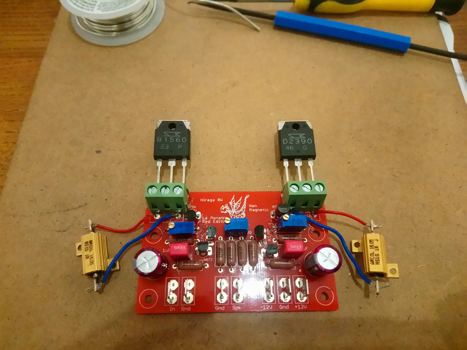

It may have a hfe value higher than the adjustment range of the pot, you may need to alter the bias lower first. But you could have an issue at the front end of the circuit
Part of the issue is that you now have three trimpots, and all three can and will affect offset. Make sure the two trimpots replacing R2 and R3 are at a position where the bases of U5 and U7 (as per your schematic) are at about the same voltage differences from the respective rails (U5 to +rail, U7 to -rail), with Trimpot R1 at about in the middle position.
If you have done this, and still have high offset, a transistor is gone....
Smallish (+/-20%) differences of Hfe have not much to do with such a high offset.
Oh, and DO NOT attach your loudspeakers to such a high offset.

Well, if the transistor measures correctly, chances are that it is not the (or that exact) transistor, but another reason.

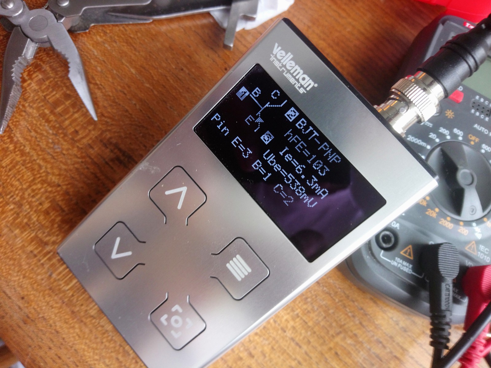

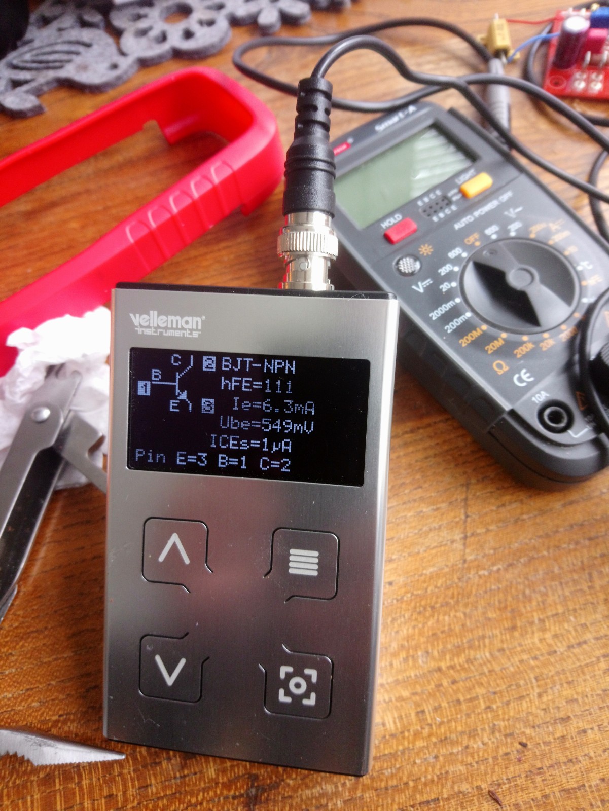

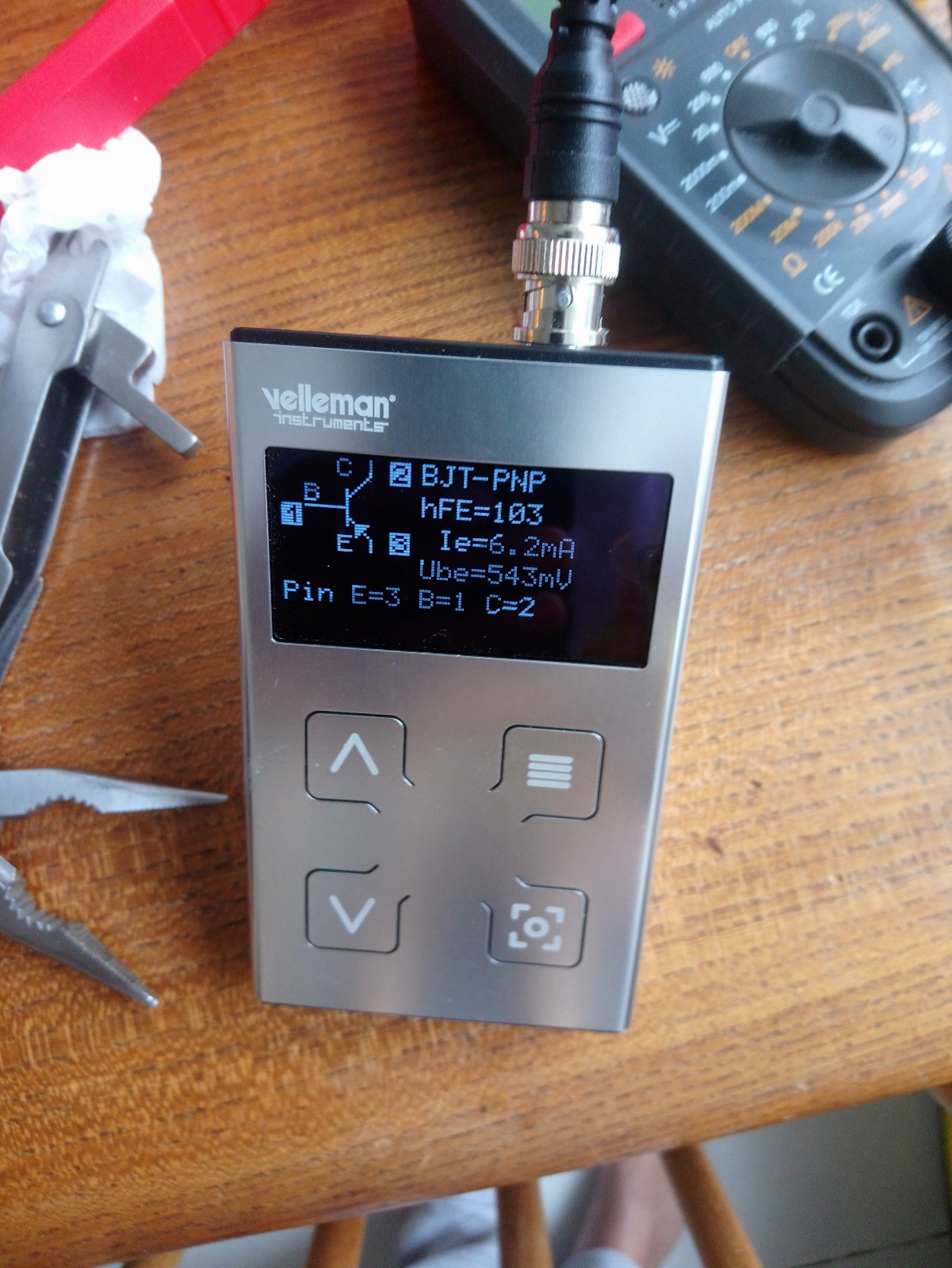

I have this component tester which connects to my scope. So i thought lets connect the trannies to it, now two of these trannies are supposedly gone as they give me a high dc offset.
Two of them work, two of them dont. i know this as i tested it on the boards,
These are njw21193G & 21194G
https://www.onsemi.com/pub/Collateral/NJW21193-D.PDF
Thing is the measure the same?!

So which transistors do work? Each one PNP and one NPN?[...]now two of these trannies are supposedly gone as they give me a high dc offset.
Or two of the same polarity?
Looks like they are ok within the tolerance of the hfe from the datasheet?

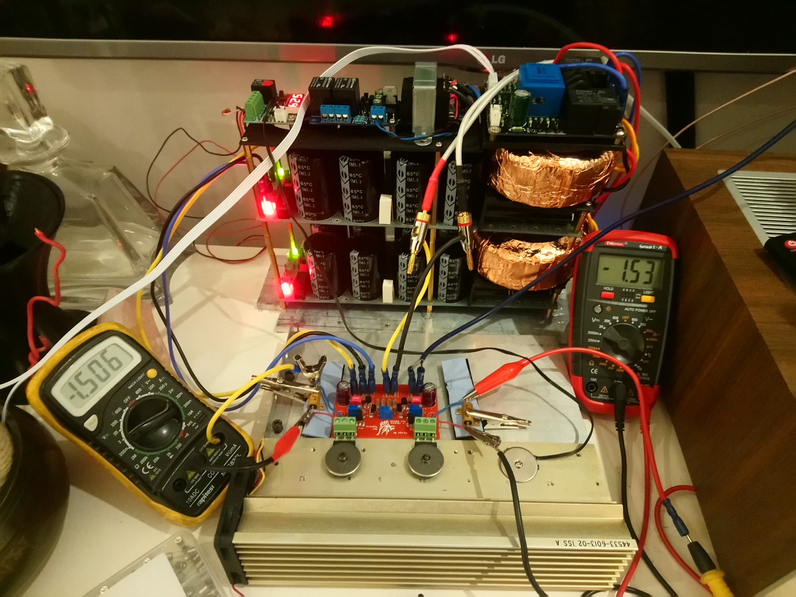

Finally came in the post, ordered from farnell so guaranteed these are not fakes!
One channel will be the sankens, the other will be the MJL's.
So handy to have these soldered on! Means i can switch between Trannies
We are back in business!
Yes Dan i want to see the effects of using different transistors based on bias settings, power produced, how they sound etc.
Incidentally these sankens work much better on a lower bias, i had them at 0.6V and they performed better there then at 1.5A. My scope showed better results at 0.6v, i even had more power, can that be right?
