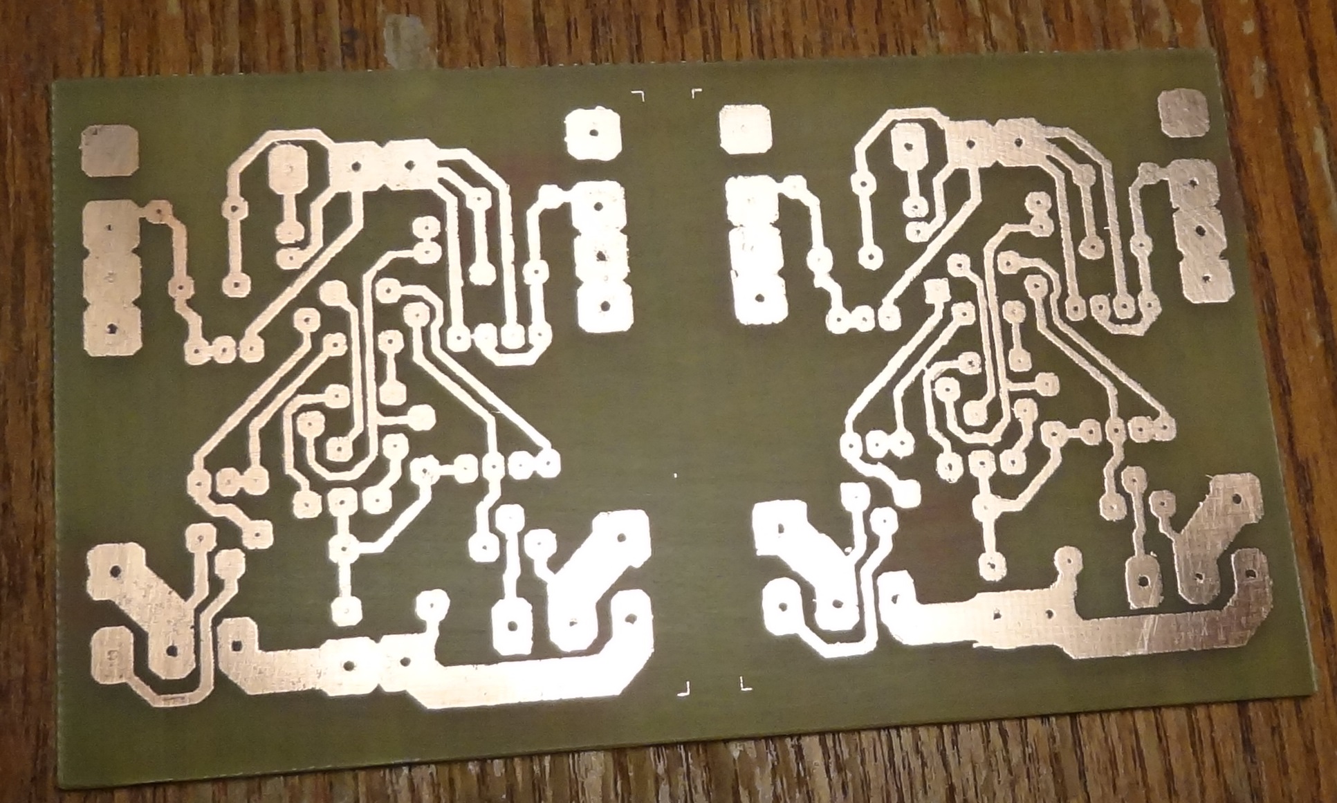

OK, I etched some boards for the Hiraga. I'll drill them tomorrow. I have the JFETs ordered so can populate next week. I have a beefy SMPS that it +-12v I may try as well.

Terry please pay att. to the transistor pin out.
Since to me one or two piece must be rotated 180 degree. Just follow the circuit that case you avoid any mistake
If you look at the solder mask where you took the layout some red marks there.
Greetings Gabor

Hi Guys,
I drilled the boards today and began populating them. I don't have the original devices so My first plan was to follow the devices in the thread that was linked to earlier which is where I got the foil pattern from. He suggests BC550/560 for the small BJT transistors but doesn't give the grade. So that got me looking at the spec sheets. The closest devices that I could find, and that I have on hand were the KSC1845E/A992E. The other thing that he didn't mention is that the pinout is different for the BCxxx and the legs would have to be twisted to fit. So here are some questions for those of you who may have substituted parts.
1) Are the KSC1845E/KSA992E a good replacement for the small BJT devices?
2) On this board layout, there are two 47uf and two 100nf caps that aren't on the schematic. Have you guys utilized those?
3) He changed the JFET to 2SK246/J103 and the 1K resistors to 390R. IS the 1K changed because of the JFET change?
4) I have both the 2SK246/J103 and the 2SK170/J74 ordered. Is there a preference on these?

Hi Terry.
I can tell you that compared to my (still limited) experience with this fantastic amplifier, capacitors 47uf and 100nf could serve to stabilize the circuit. (for my amplifier, the effect was that!).
I built my first version without these two small capacitors and despite all the work, once put the whole system has become more stable and it was easy to adjust the output offset REALLY close to zero. (before ranged from 0 to 40mV slowly varying, and now fixed and stable at about 2mv for channel).
With regard to the transistors, I use the configuration with the 2sk246-2sj103 and-bc550 BC560. For bias currents of 600mA on the transistors (I use TIP2955-TIP3055), the resistors are set to about 330 ohms.
Perhaps with the 2SK170 / J74 these values will vary, but I can not tell because I've never tried, (although I must admit that I'd like).
