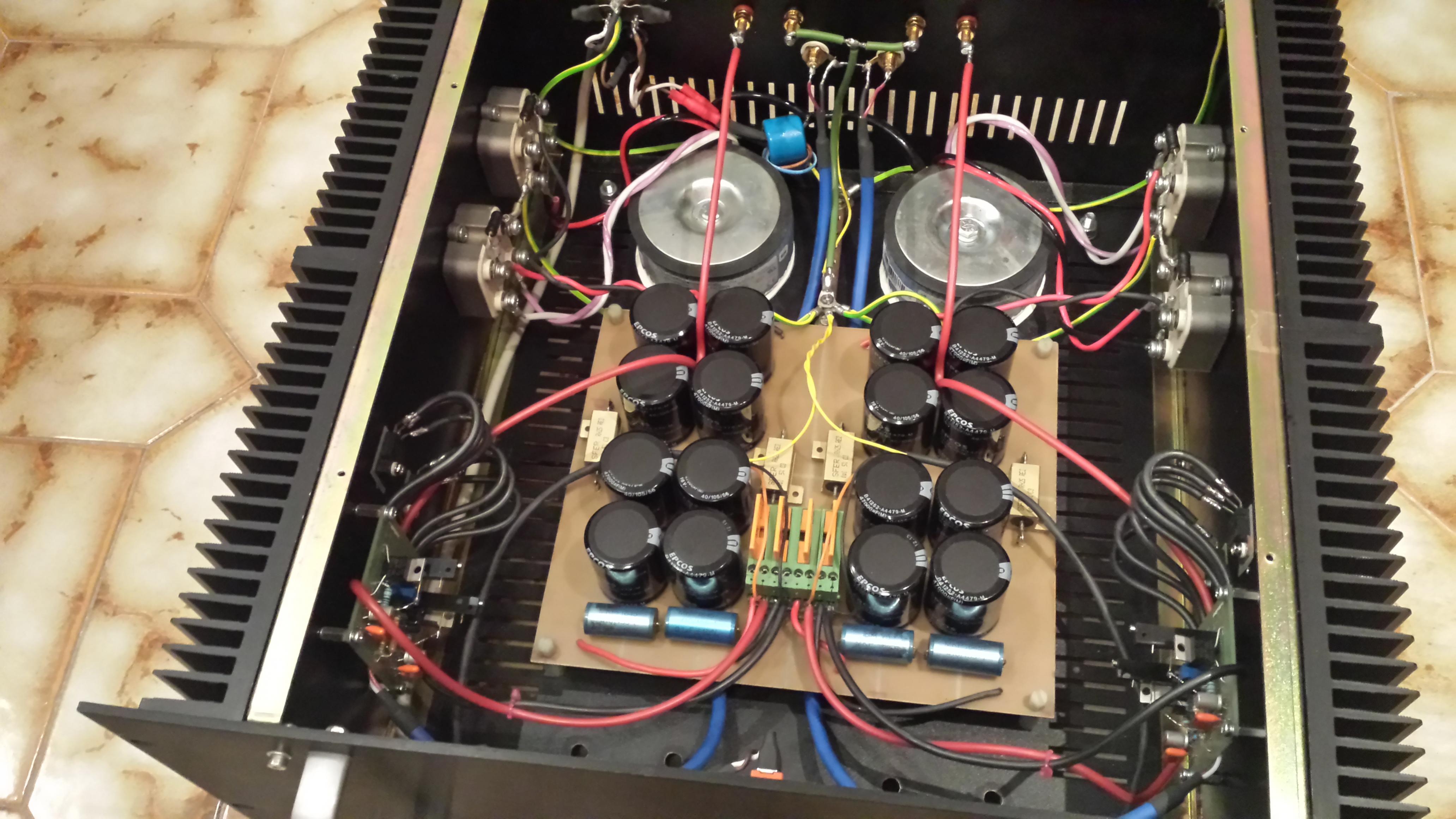

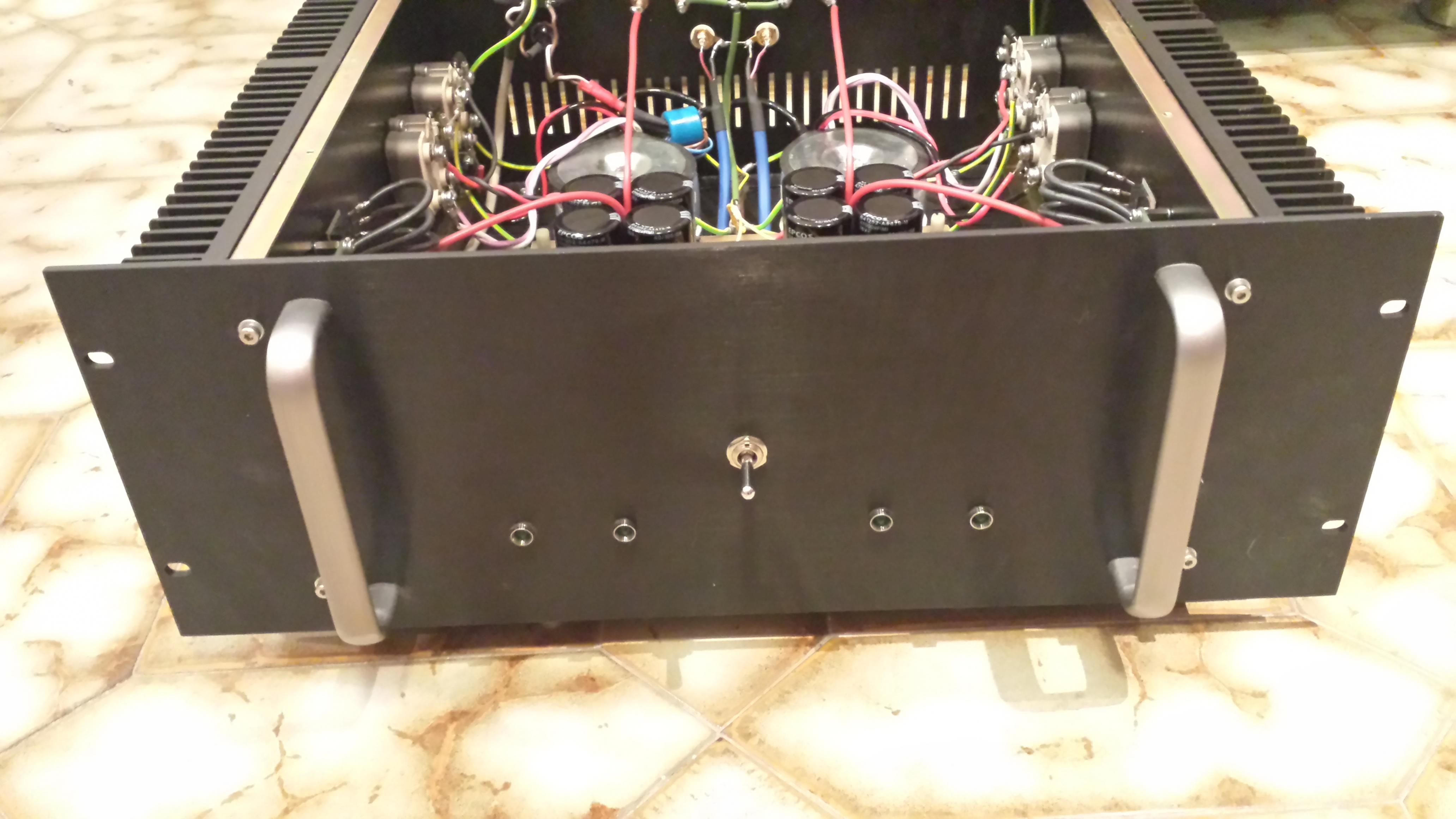

Hello everyone. 'm new to the forum in fact this is my first post.
I recently built the version Le Monstre 8 watts.
I'm incredibly surprised by the sound of this amp and would like to get advice from experienced people like you who write in this thread.
I am not particularly electronics expert but all in all I get along pretty well with the soldering iron.
It worked right away and after adjusting the bias of the output transistors at 600mA it was possible to calibrate the offset to about 2mv for both channels.
I used new alternative transistor because i can't find the originals.

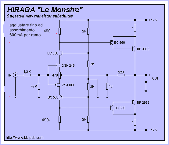

However , I am attaching the the pictures of the electrical configuration that I used for the power stage and for the output stage.
Add more photos of the unit.
I would be very happy to receive advice.
P.S. sorry if my english is not perfect !!!

Nice neat build. Any hum left ?
Shoog
Not anymore. Before was present just a little hum, but now with shielded signal cables and star connected ground, the hum is totally absent.
Now i drive it with a conrad johnson evolution 20 and also with the volume pot at maximum level there isn't any hum.
I also tried it with a audible illusions modulus 3 and cause to the little big gain that it have, at the max volume pot, there was a little bit of hum, but just at the max volume.
thank you very much for your interest !!! 🙂

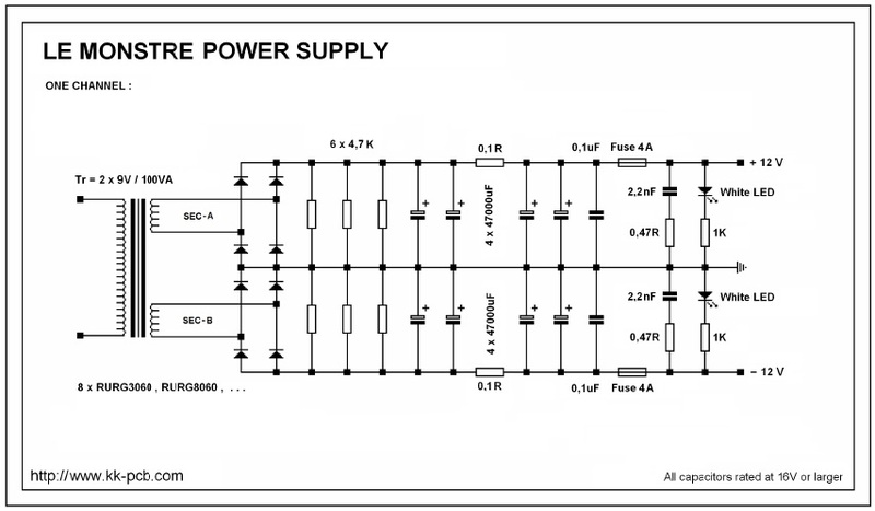

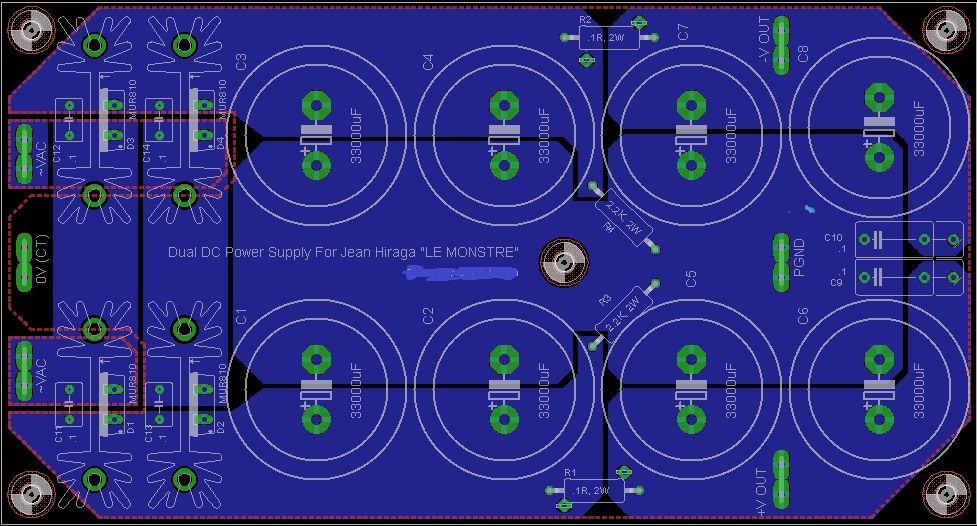

regard to the bridges semikron, I used those because I had available and I have not had to buy.
In fact, according to the wiring diagram that I used, the bridges should be made ​​with ultrafast diodes RURG3060 or RURG8060 and soft recovery.
Soon I will put them in place of semikron.
Do you have advice on this?

1) Using SQP series resistors not good, better to use 5*MFR-2 1% 100 ppm (or better ppm)
2) Power lines must be go from one point.
3) You must to set LPF (for example 1k2+470 pF[WimaFKP or Mica], where capacitor).
4) 2k (potentials), 10om (feedback), 47k (input resist) resistors and cap of LPF go to one point of signal ground.
5) Power ground from bypass go to one point, this point to do under input point (signal ground) on 3 mm and connect them by thin line (width 0,4 mm)
6) Caps of bypass must be bigger than 47uF (220-1000 uF) and very good quality (as example Nichicon KZ, FG, KA or Elna Silmic II, ROA).
7) All resistors must be not worse than 0,5% 50 ppm (better to use 0,1% 15 ppm).
my findings:
re 1) If you are designing a PCB then it is handsome to be able to parallel the 1000 ohm collector resistor with a 5 kΩ Bourns . It makes life easier. I saw you glued a trimmer on the board!
re 6) No bypass also works.

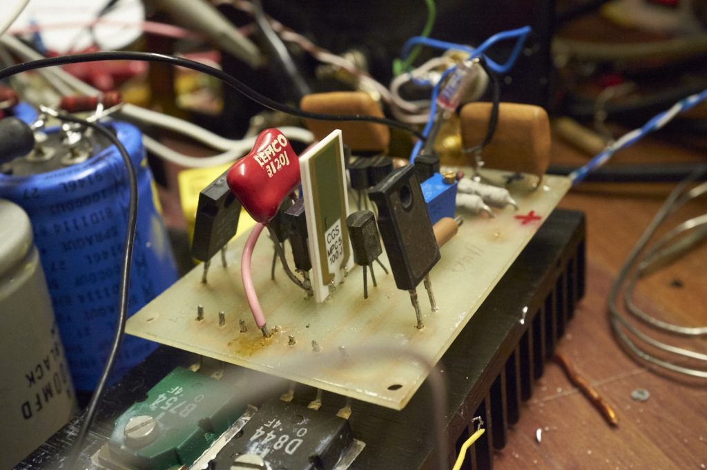

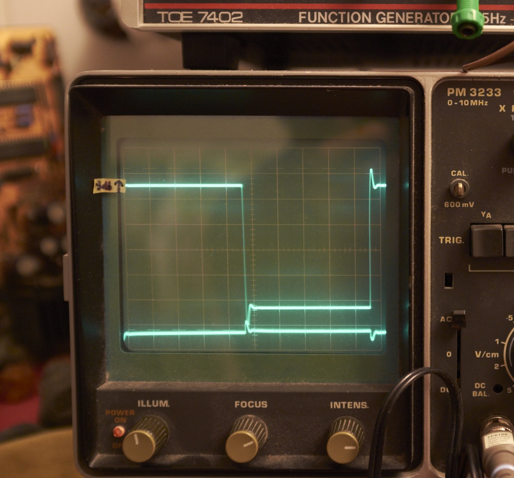

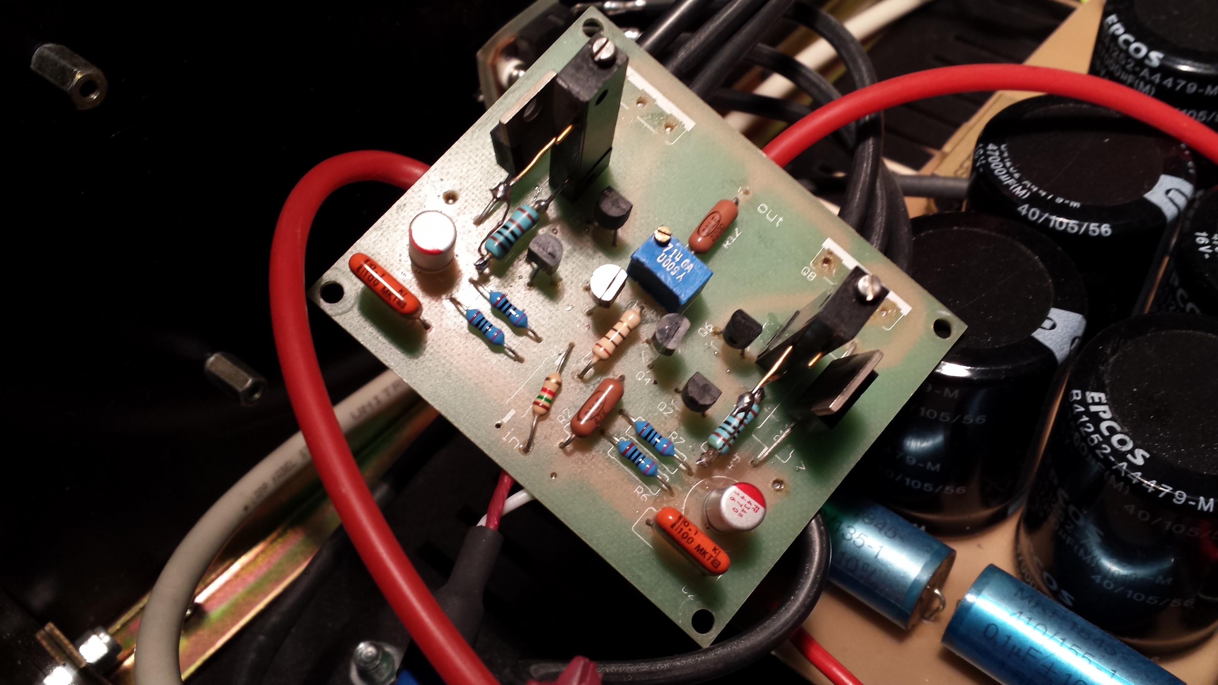

Fighting instability in a Monstre
I redeployed a Le Monstre with the original printed circuits and the original active components in a new housing with a small footprint.
My first Le Monstre was a big cabinet of 40 cm high, 50 wide and 40 deep, filled with large can-sized Sprague electrolytics connected with big slabs of copper plate. And a big radiator for each channel. Weight: over 15 kgs. I ran over an ampere idle current at 14 volts.
Over the years I reduced the footprint. See for instance my posts where I implemented a shunt power supply.
Now I decided to reduce the size even further to fit in a commodity cabinet , and I decided to reduce as well the wattage. I need it to power a speaker with 96-98 dB sensitivity and having 15-20 ohms, where 3 watts in pure class A is enough, thus the 0,5 amp should suffice.
Changes I made:
  1. I decided to treat myself with some very nice resistors this time to replace some old wire-wound ones for the feedback: I selected a Caddock MP825 200 Ω flat film and a Tyco MPC 10 Ω thick film resistor. I also bought Caddock MP850 1 Ω for the emitter resistors in the output. All utterly non inductive.
  2. I paralleled the 1000 Ω resistors in the first stage (on the collectors) with 5 kΩ(just like the F5) for easy setting of the output current. A very recommended improvement.
  3. I put in some nice 220 nF mylar decoupling capacitors too instead of the large 36 uF solid tantals paralleled with extra decoupling with polypropylenes I used to have - I now needed something definitely small.
  4. I decided this time to go with an active power supply (A Hiraga design implemented around a LM431/2SK135/2SJ50, with less than 0,3 mV noise).

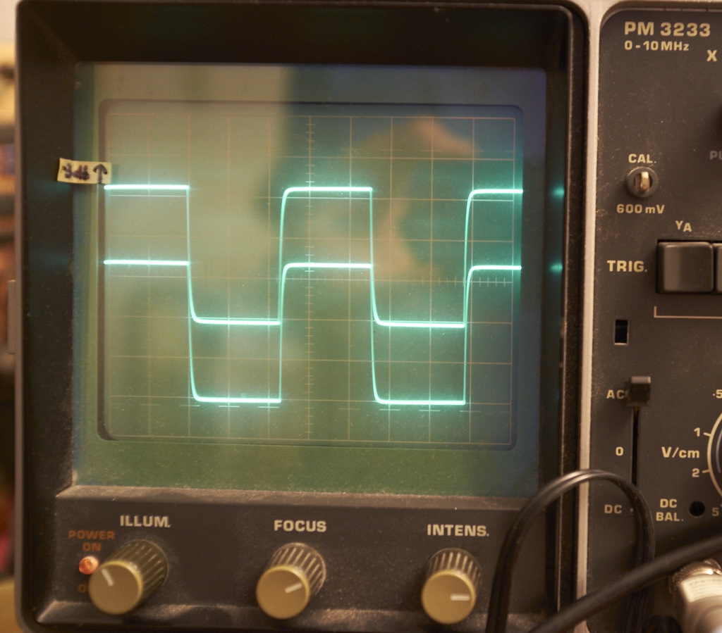

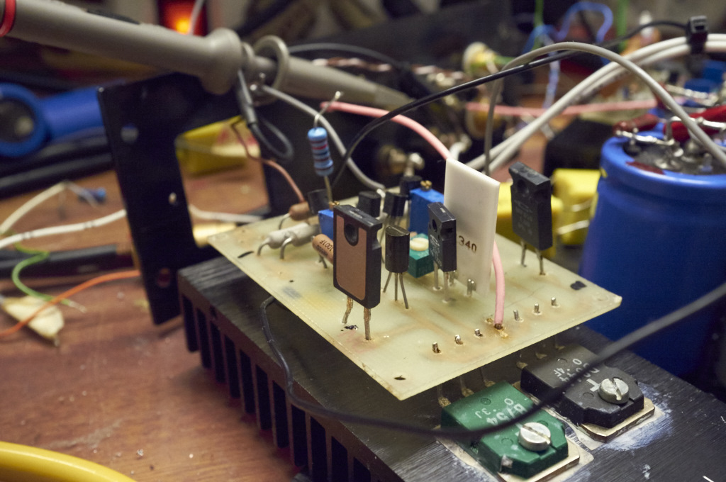

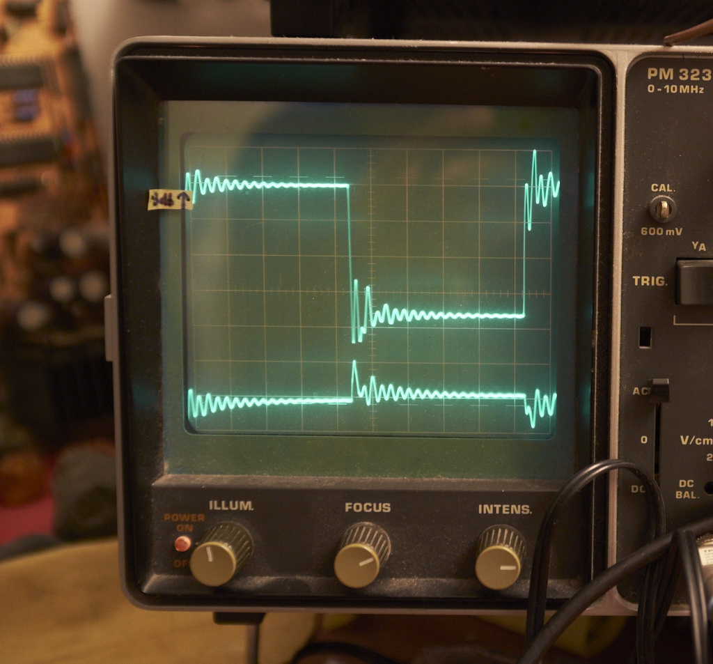

When I fired up the boards with the new passive components I was treated on a very big ringing. It was even visible on the ground plane itself (lower trace). Changing the PS to passive had no effect. Changing the grounding did only change a little bit.
After quite some experimenting, I found out what the reason was that I had instability on the circuit boards.
I remembered that Nelson “papa” Pass once commented on a poster who complained about instability in his F5 and asking about the values of the decoupling capacitor, “who said I have decoupling in my design”. [The F5 is similar in concept to the Le Monstre; Chinese boards have place for such caps]
So, taking the decoupling caps out completely from the Le Monstre board made all instability disappear. Relooking at the published circuit by Hiraga, I saw that it mentioned 47 uF. Quite different from the diet of a meagre 220 nF that I had put my Monstre on!
As always, days of work from bad reworking of a design.
The final build: with 100 pF on the entrance to shoot all the overshoot out of the system.
DC power supply is flat with less than 0,15 mV RMS for plus and minus and the output also shows a last bit of 0,1 mV RMS due to earthing/cabling differences. Something to improve.
