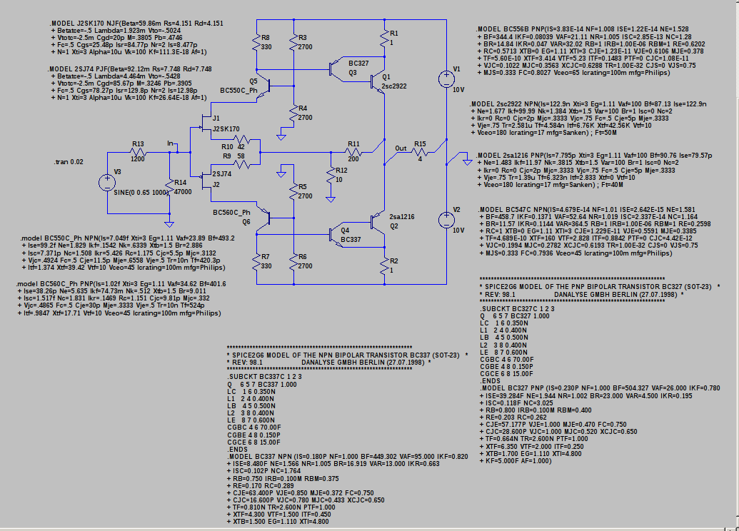

It seems to have almost no PSRR which means that it needs ruler flat power rails. If you are running 96db sensitivity speakers even a single mV of ripple will be audible. I still have small issues with radiative inductance from my massive toroidal power supply. Its much harder to get quiet than any of the valve amps I have ever built.

Also, what is the voltage range that can be used with this amp. I see a 9-0-9vac transformer. Will it work using a 12-0-12vac transformer?
Thanks, Terry
You need 10-0-10VAC min. transformer to get 12V rail.
You can use 12V to.
First time I built the Monster I used 9-0-9VAC 300Va transformer and I got around 11V rail under load.
If you want 9-10W some speaker need that if not sensitive enough, you can go 12AC with out problem.
Originally they chose the transformer to get 12V because they use car batteries to which is 12V.

The 12-0-12vac transformer I have is 1200VA so it will hold about +-16Vdc rails. Jus wonder is this is too much.
Thanks, Terry
Your charging spikes will be significant and this will create radio frequency noise which can effect all other components. I had a similar problem with my 300VA transformer and in the end I had to put resistance in the secondaries to slow things down and reduce the buzz I was getting from my speakers.
Despite what most people may imagine a to large transformer is not an advantage in creating a quiet amplifier. I would personally opt for something in the range of 120VA if I was building mine again. At this level the slight transformer resistances act as a choke to transformer noise.

It's mainly the voltage I an concerned about. My transformer has four secondary windings I can output va in 300va increments. As long as+-16v is OK I can make it.
Thats not really the main issue here - its the DC resistance of the primary which allows the huge charging spikes. in order to supply a 1200VA transformer the wire resistance will be virtually zero which will mean that the transformer will be able to charge the caps very very quickly with currents in the 10's of Amps. this makes for very short and very sharp charging spikes and when the diodes switch off the back EMF of the3 collapsing field of the transformer creates an even larger voltage spike with the transformer acting as a perfect radio antenna to dissipate the energy.
If it can be significant with a 300VA transformer it will be more than twice as significant with a 1200VA transformer. Coupled to this will be the significant stress this will place on your capacitors in dealing with such massive inrush currents.
Its just not a very sensible idea - consider placing some resistance in series with your primaries and/or secondaries (which negates any advantage of have such a big transformer) or better still use a smaller transformer.
