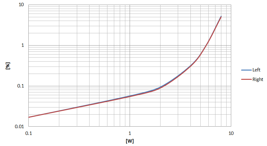

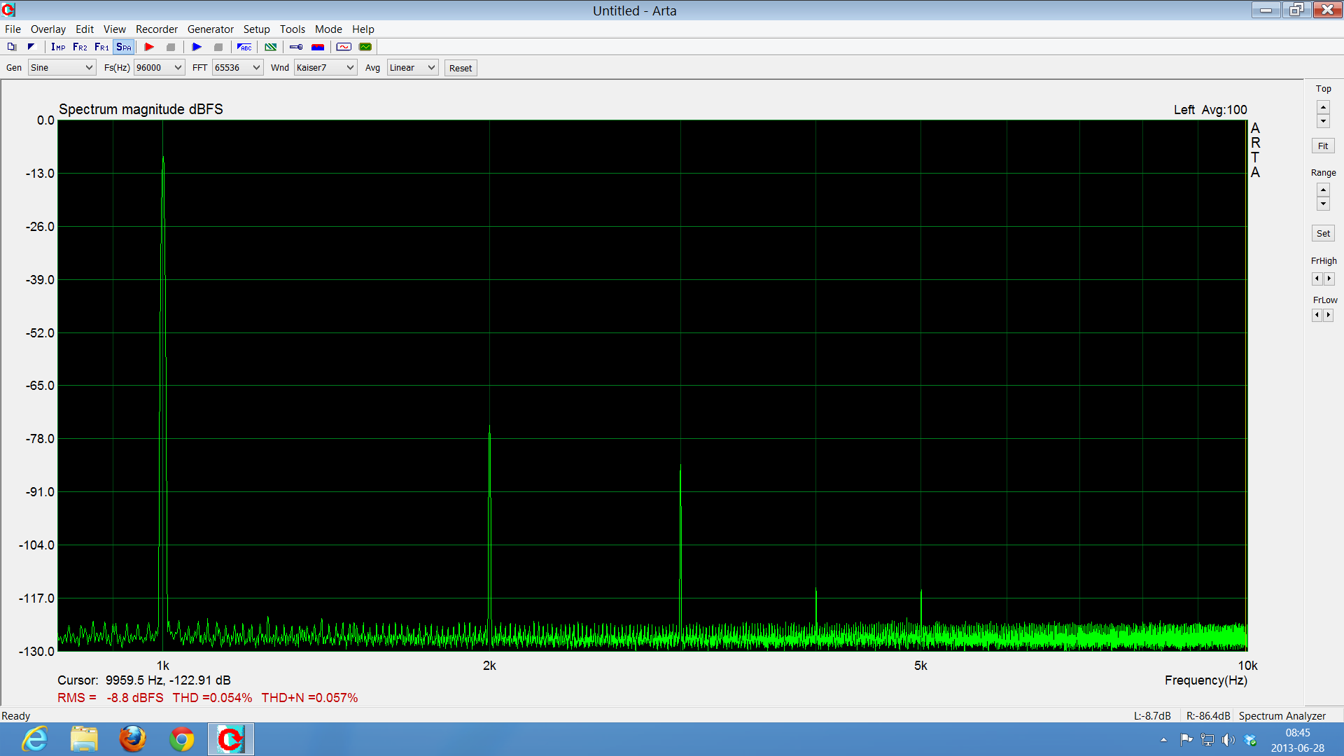

Here is some measurements taken on my le monstre,
note the bias is deliberetly set low to get the steep increase of THD with output power like one would get with a 2A3 / 300B amp.
I did have a photo of the distortion waveform in realtime (captured with a HP 339A showing it to look rather similar to a pentod driven 300B, indicating not only the amplitudes of the distortion components shows similarity but also their phase relations.
And what about the sound Le Monstre 8W vs. WE300B?🙂
Tazzz, thank you.
It looks like 0.057 THD+N, but 0.000000 at sixth harmonic and higher, is this rare?
Tazzz, thank you.
Do you like highest harmonics (after 5th)? 🙂😱
