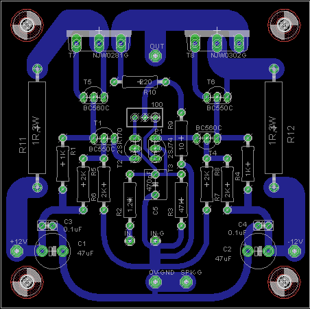

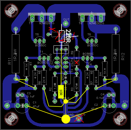

Thanks Tazz,Damon for valuable feedback.
Regards
Sachin

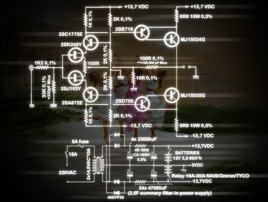

To my ears the best sound with 85-120 om (instead 220 om resistor in feedback).
And don't use NJW3281+NJW1302 or another 30 MHz BJT (amp could be unstable) , better to set MJ15024+25, MJL21194+93 or MJL21196+95.
To use these 30MHz BJT you may want to add a compensation caps (ex. 68pF) across the drivers to keep the circuit from oscillating.
Rgds,
Eric
Of course, and the scheme "without Miller's Effect" will fall down to hell.
I think that using correction is bad, that better to do Super Class A 20W/30W (the sound of scheme 20W is better than 30W).To use these 30MHz BJT you may want to add a compensation caps (ex. 68pF) across the drivers to keep the circuit from oscillating.
Rgds,
Eric
Thanks guys, I will post updated layout tonight. Any suggestion regarding power supply design?
Regards
Sachin
CRC filter, 1F minimum, better to do 2,5F and batteries in buffer. Don't set leds on power supply of amplifier, resistor in CRC minimum 1 om, better 4 om.
I heard a friend's Hiraga that had 0.3F and it was an amazing amp. If you forget about the original Hiraga schematic would you really need to go to that extreme of using 1F-2.5F...+ batteries ? Just curious since capacitor back then were not as good as today's.

Why 0,1 om, why no 0,01 om or 0,001 om?
Aaaaah, maybe you're blind and don't see on original sheme 4 or 8 om resistor in CRC. I repeat - "R", and maybe Hiraga was born in 15th century and didn't know: what's the "know-how" as inductive-capacitive?
It would be understandable using stabilizators, but using inductance... in analog power supply... I'm convinced that you like "castrated" sound.

My question is simple ; Why do you need to use such an oversize capacitor bank, what is the real technical reason. The bias current is not high and the output power is only 8W. What would justify the use of so much capacitance...

; Why do you need to use such an oversize capacitor bank, what is the real technical reason?
Eric, I can't put my hands on my copy of L'Audiophile articles but I recall that these were a specific part of the design - I think to emulate the relative impedance of the 2A3 amplifier he was trying to match.
Ah - see The Class-A Amplifier Site - Jean Hiraga Index for the articles in French and (broken) English
This is the power supply he ended up with
Yeah... Jean Hiraga = Maximum Current to the Load without Delays.
