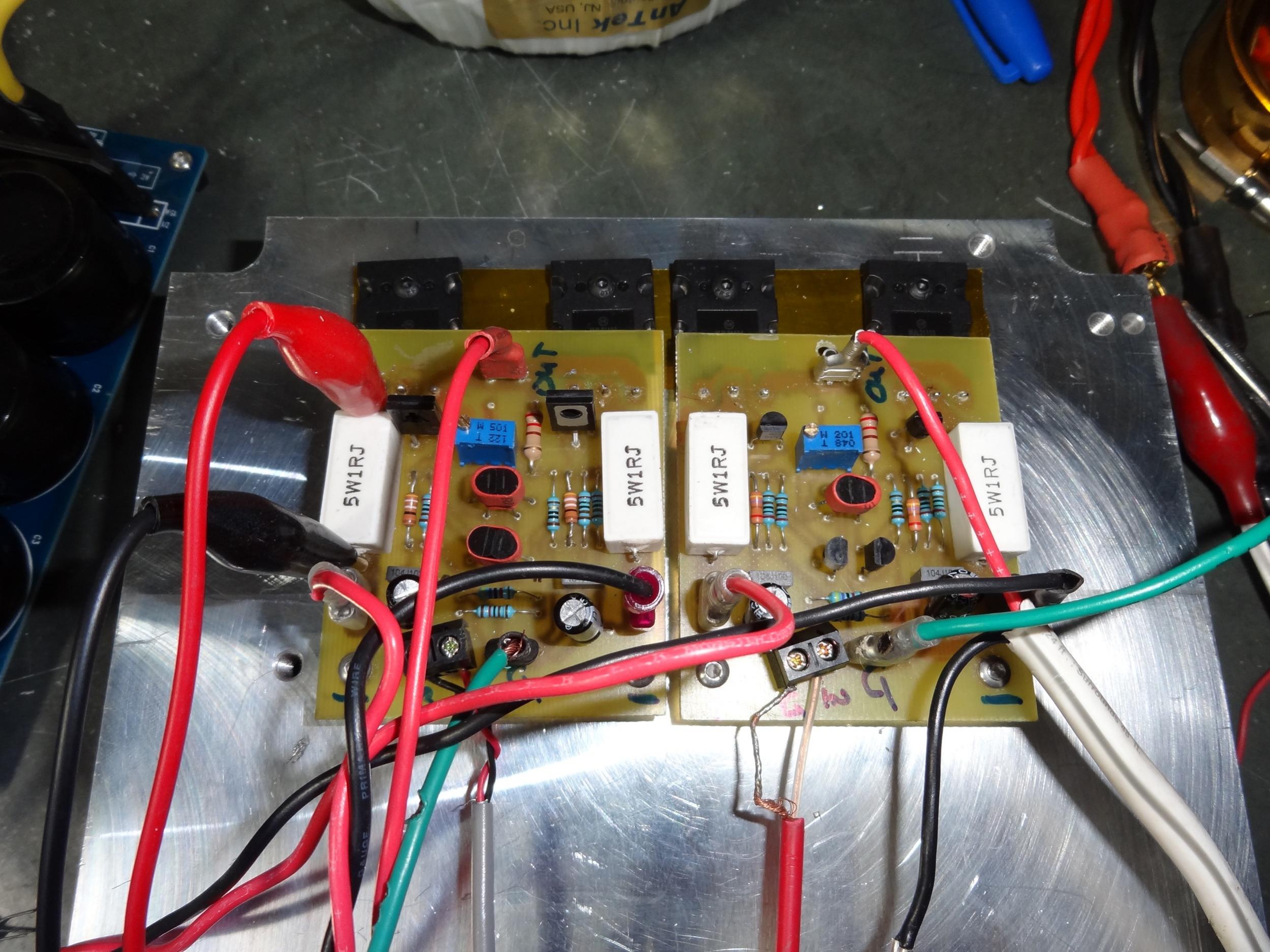

OK here's an update. I have it playing. I got the first channel working but the second was giving me trouble. I had used KSA992/KSC1845 for the four small transistors. 2SK246GR/2SJ103GR and MJL21193/MJL21194. On the second channel I decided to experiment since I needed to pull the devices to figure it out. So on that channel I installed 2SK2240/2SA970 in the front and BD139/140 in the drivers and the 2SK246GR/2SJ103GR for the JFETs. MJL21193/21194 in the output. I also received some 500R trimmers so I installed one in the second channel. I've got some 399R resistors in the bias slots but I'm only getting about 500mA bias.
The sound is decent. A little lacking in bass. I have it hooked up to my A/B setup and comparing it to a VSSA. They are pretty close in the treble but the VSSA is just fuller in the lower end. I think the second channel sounds slightly better than the first one so I will likely change the transistors to match the second. What bias are most of you running at?
Here's a pic of the rat's nest as it's playing. 😀

OK I got a chance to work on it some more today after doing a lot of reading on various forums. Seemed as though most folks were shooting for about 1A bias so I reinstalled 200R trimmers and then installed 1K trimmers in the 1K resistor slots and adjusted them to 1V across each 1R resistor. I have installed 2SK2240/2SA970 in the cascodes, 2SK246GR/2SJ103GR JFETs, KSA992,KSC1845 in the VAS and MJL21192/94 for the outputs is both channels. I ended up with 560R for the bias resistors in one channel and 620 in the other. Both are now within a few mA of 1A. I hooked it back up and still the bass is a little lacking. Then I remembered seeing the guys said this amp needs a lot of filter in PSU and I had been using a cap bank with just 6 X 4700uf caps for both channels. So I dug out the filters I had used in my Aleph X. Those consist of 4 X 22,000uf caps per in a CRC setup using 2 X 0.22R, 25W resistors in parallel between each cap. I hooked up one set per channel for 88,000uf per channel. There's that bass. 😀 This is a whole different animal with the big capacitor banks. I'm going to give it a little more time to burn in and then I give it a little more critical listening.

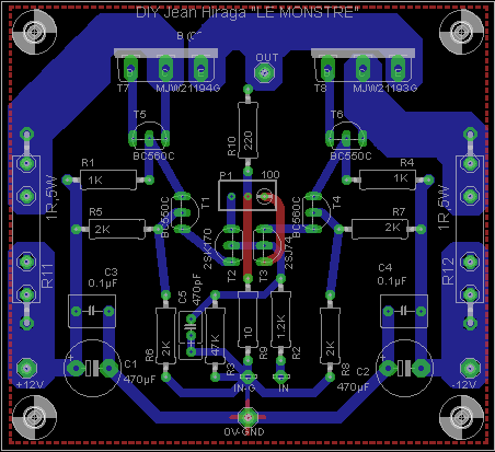

Decided to do a strip down and rebuild to get rid of the last residual hum. Potted my big toroidal which should help a lot.
Unfortunately whilst scoping out the circuit something shorted out and took down about half the transistors - fortunately not the big Sankens (which would have been game over) but it took down the 2SK170's and 2SK74's. Bummer as I got these from a friend and can find no reliable source. Any pointers.

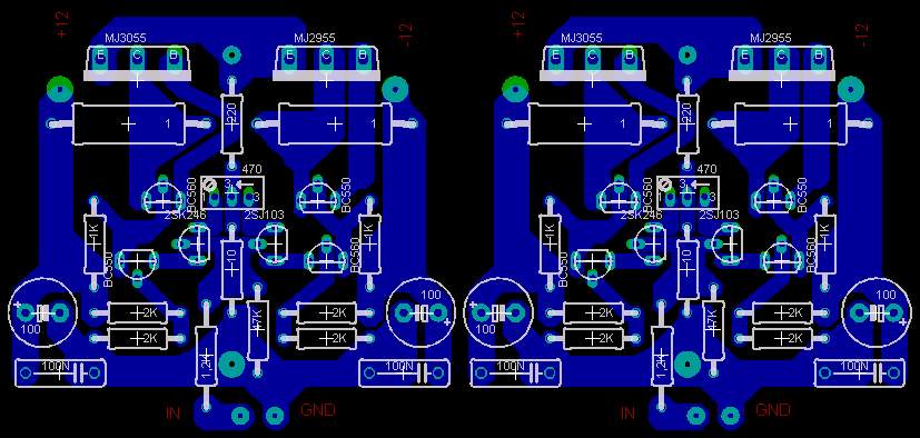

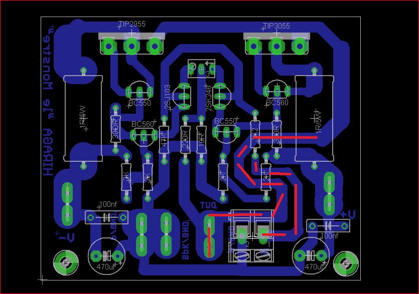

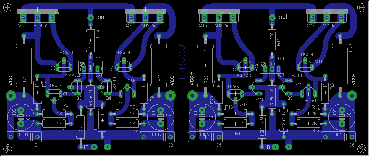

Terry you like the mosfet sound, you should test the mosfet version. I built a couple BJT type but was not my taste.
Lack the dynamic, bass etc
These mosfet look interesting, also I have the layout for.
Greetings Gabor
Hi
Terry it uses vertical mosfet.
I do have something similar with lateral mosfet, it was moded from the Hiraga. The guy who built it (actually he built several of them to his friend, himself etc.)
So I designed the layout and I built it but I was unable to get read of the offset. Probably I made some mistake with the layout😕
So I gave up the Hitachi latfet version. That one here you can find.
Megalith - Cooltune DIY Audio
The vertical is nice and to me better than the BJT at least less sensitive to the PS. Has more tubby sound.
Of course it need a good PS like every Class A amp 🙂 It just not as picky like the BJT version.

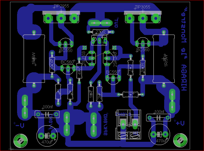

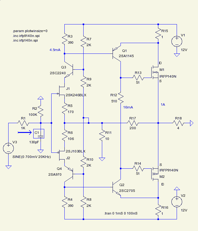

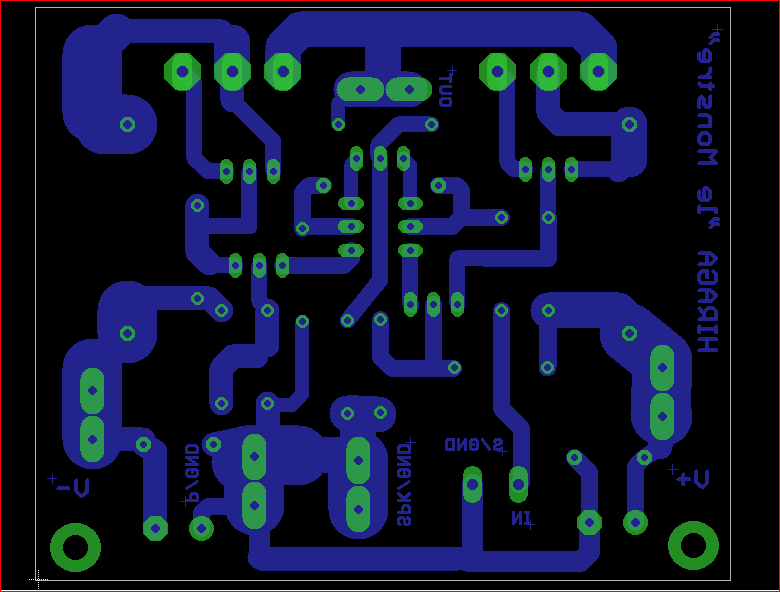

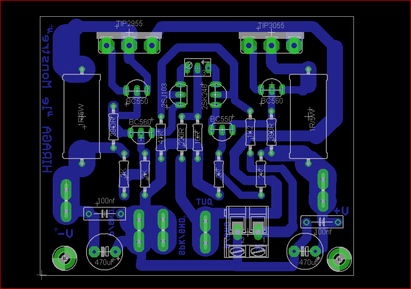

Here is the schematic and the layout
